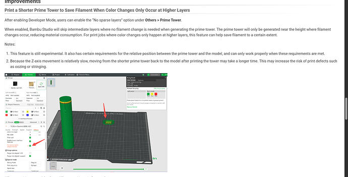

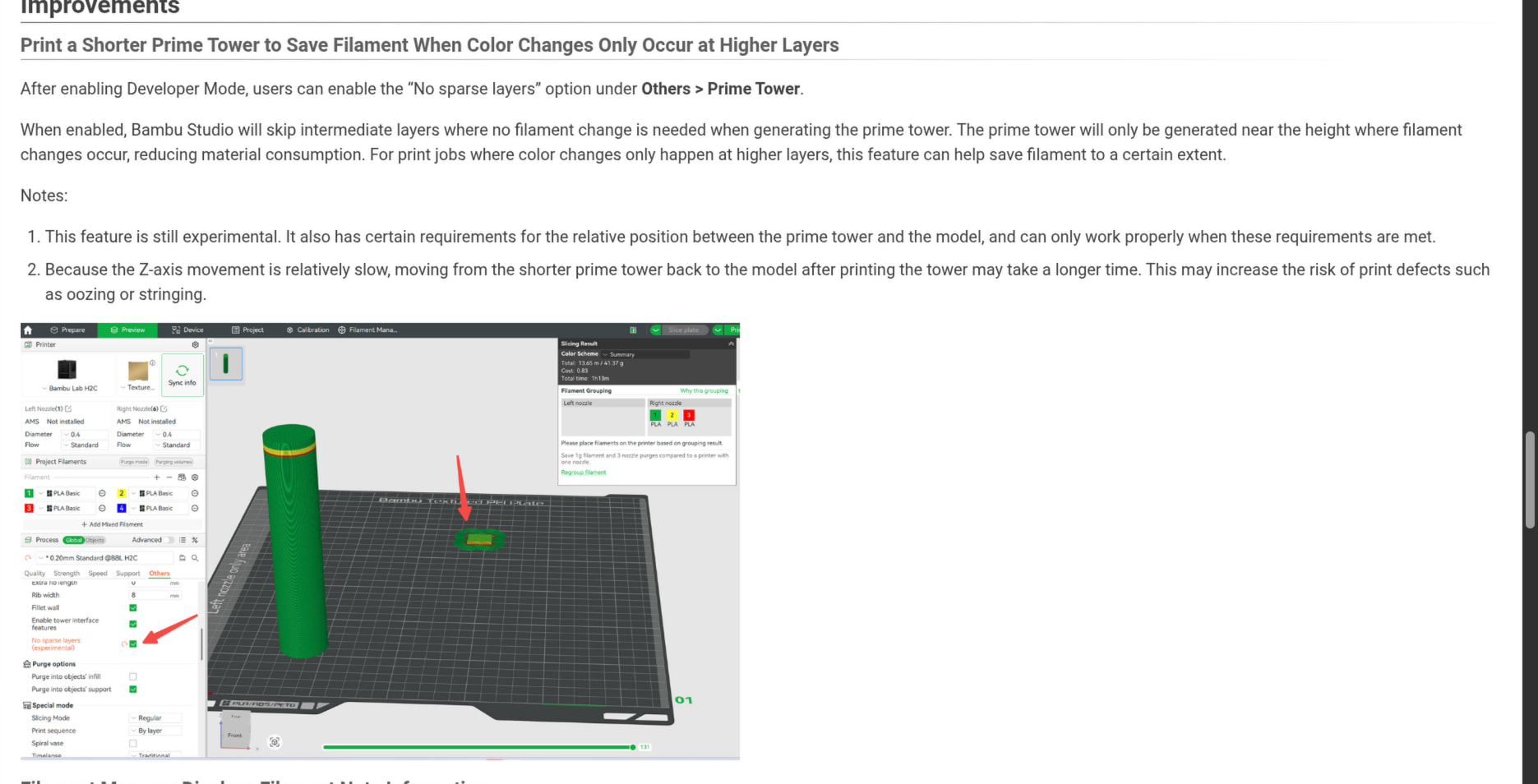

There is a lot to read
This will be huge if it works well
Make sure to switch / enable developer mode , it does look interesting , yes
