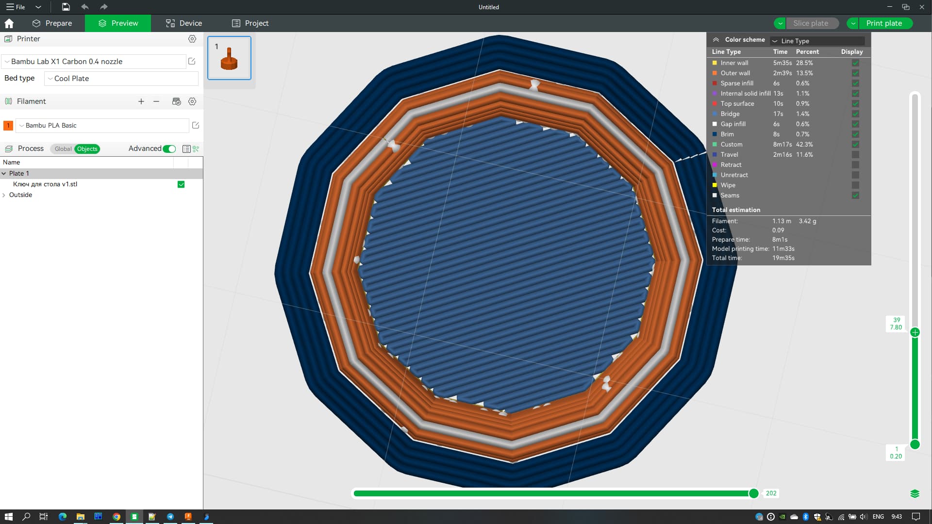

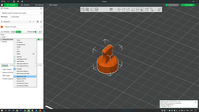

Hi! I just switched from a superslicer to a bambu studio because I bought a x1 printer. And I did not find that the hot key F5, which is responsible for updating the model on the table (reload from disk), does not work. I very often make changes to the model and then watch how it is sliced to select the best result or when it is simply necessary to increase the gap. Now, to update the model, you need to switch the tab from global to objects, right-click on the object and select update. Please make it possible to update with one button.
Probably I’m in vain to interfere with everything in one topic, but all the same I will write it here.

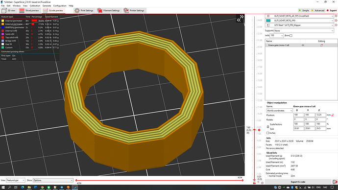

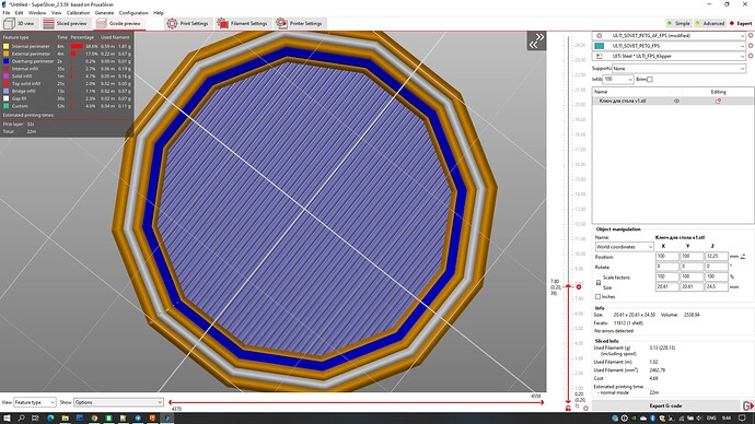

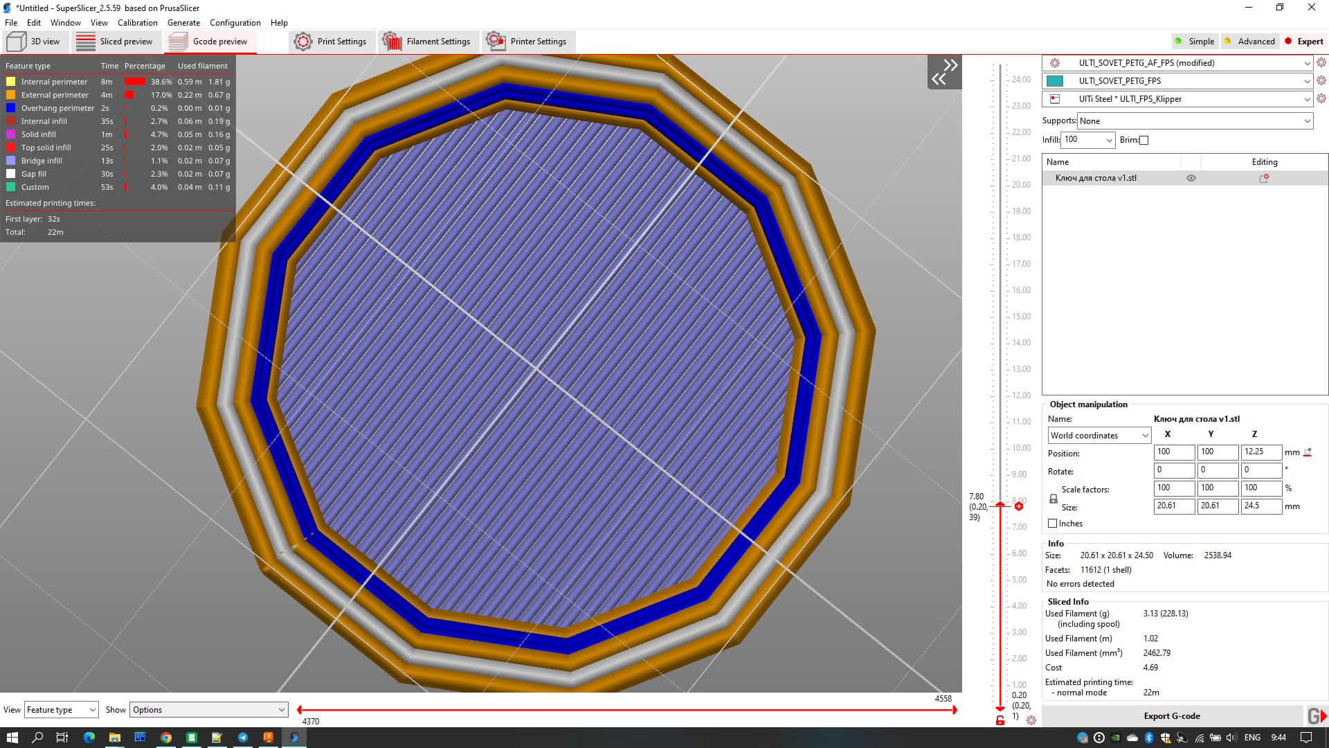

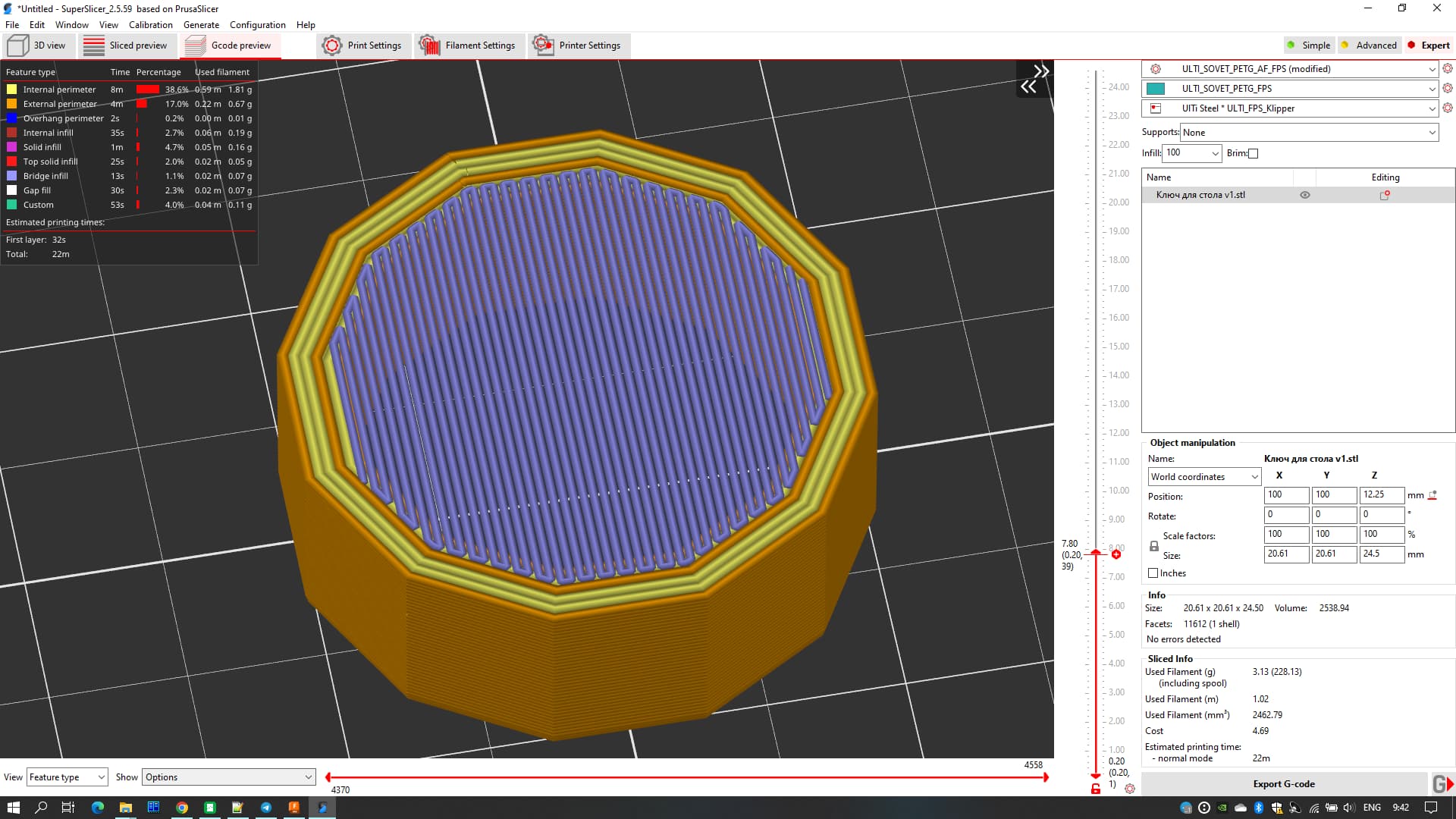

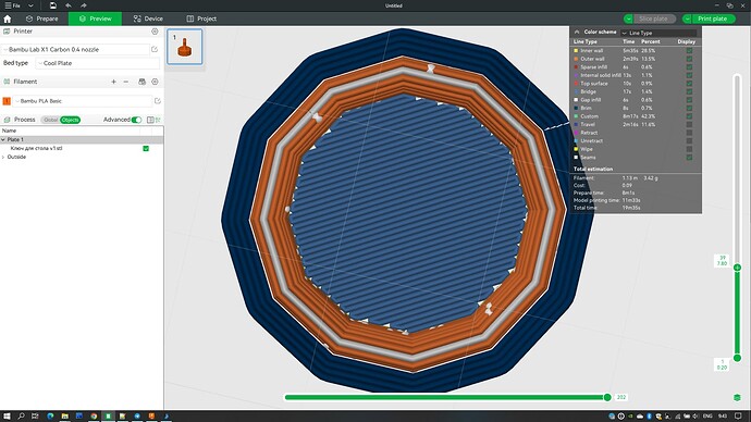

I didn’t find any useful bridging settings in this slicer. He literally tries to do them in the air and there is no way to fix it. In a superslicer, you can remove the perimeters where the bridges are to make them more supportive. You can control engagement and a whole lot more.
SuperSlicer -
Bambu
