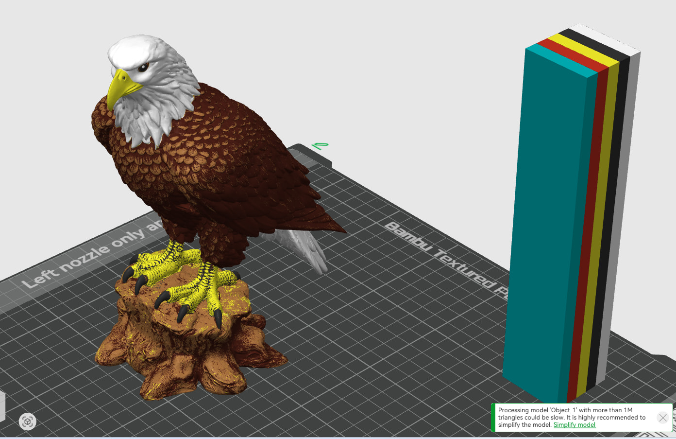

I still get blue eyes but the other issue is gone.
Thanks
BL_HHP_3MF_FullSpectrum_OFFICIAL_BAMBU_DERIVED_v0.4.16.3mf (4.5 MB)
I figured it out. I had to select all-bambu and not inventory. Does inventory not get the colors from filament manager? I do have black PLA there.
I stand corrected, black pla is not in my filament manager, that’s why I get blue eyes.
Thanks for confirming it. Yes: My Inventory reads the compatible active PLA colors in Bambu Studio’s Filament Manager, so if black is not listed there the blue was the closest available choice.
