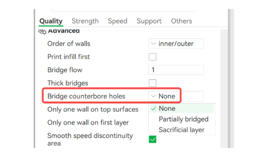

Not sure if “convert holes to polyholes” setting in orca slicer has any bearing on this, but I only just today became aware of that setting’s existence, so I’m just mentioning it in case it’s relevant. Probably offpoint, but I won’t remember to mention it here later.
I haven’t tried it yet but Orca 2.0 added a setting for counterbore holes.
Indeed it does:
