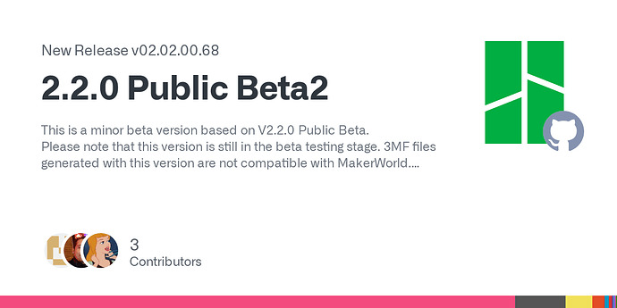

Bambu Studio v2.2.0.68 Public Beta 2 is now available
Why are they adding Pressure Advance test prints if we can’t adjust the pressure advance settings?
I hope that means they will add these. The settings can be searched within the filament settings, but doesn’t display anywhere.
A new update has been published, with some bug fixes from the previous Beta, and a few other features.
Check out the changelog and download the newest release here:
