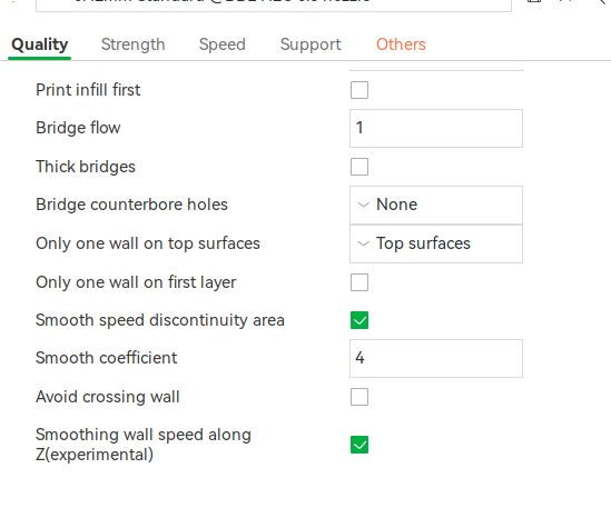

Manual flow adjustment definitely makes sense to me for the first layer, since Bambu Lab removed the flow control for the first layer in the slicer. For my prints, I use a wood grain modifier on the first layer, and this was very helpful for closing tiny gaps with slight over-extrusion—gaps that even Arcane mode couldn’t handle. I almost always print with a .6 hotend.

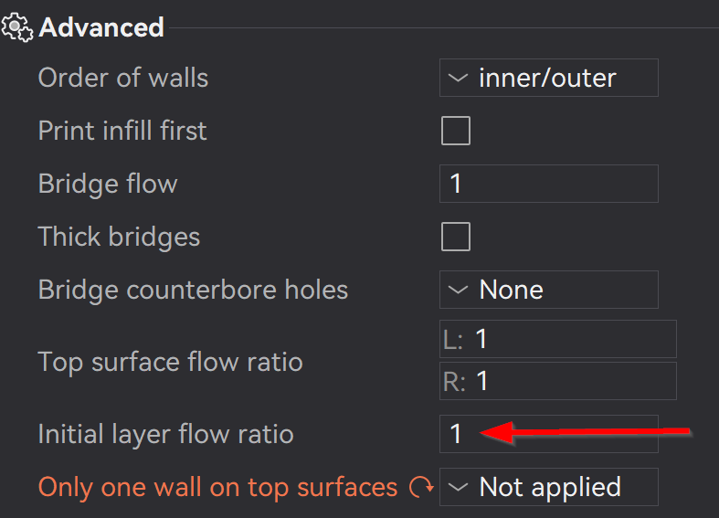

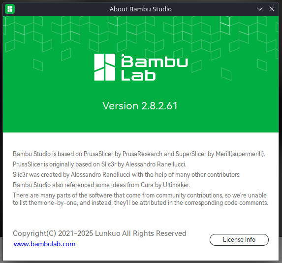

For me in version 2.8.2.61, it is still there under quality → advanced:
Anyway, if you want best quality, I don’t see a way around tuning flow ratio to the point. It is a 20 min print and shouldn’t mean any extra filament presets. Just adjust it in your existing presets and whenever you switch to a new spool for a color+material, adjust the flow in the existing profile.

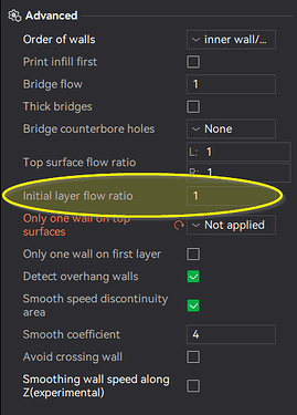

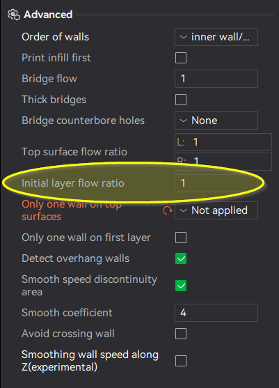

That is still there I believe:
If you are talking about Max Flow Rate, I would normally only use that only for high speed prototyping or high strengt profiles with a more conservative flow rate.
IMHO that still qualifies for an adjusted profile.
A multiplier in the general profile could make it more accessible, but at least the capability is already there, but less accessible.
