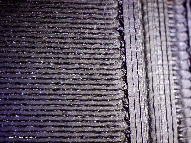

I need a filament which is heat resistant up to at least 100°C, therefore I have tested ASA and ASA-CF. ASA-CF is even much better in that regard.
Now, I printed with a spool of ASA-CF, which was opened a few months ago. I did dry it for several hours @ 70°C. The print has extremely poor layer adhesion and very high brittleness. Completely useless.
What is your experience with ASA-CF?
The part was printed on H2D with default settings (60° chamber temperature).
Here are a few pictures:
ASA doesn’t have great layer adhesion anyway, but those prints look like it was very wet still. It shouldn’t be frosty looking like that.
Try weighing the spool with a precision scale (at least tenths of a gram resolution) and then drying it at the rec 80°C until it stops losing weight and try the print again.
Standard way to increase ASA/ABS layer adhesion is to crank the nozzle temperature, start dialing it up imo. Maybe make a temp tower and break it to see if there are any nearby threshholds.

Not sure about drying, but a few comments:
Unknown purpose, so if you can provide details about environment, impact requirements and so on, then community may suggest a better alternative.
If you just need a high temp with a good layer adhesion, then ASA-CF is not the best material to start with. Look into Nylons and PAHT.
General suggestions based on those images:
  • Use 0.6mm nozzle for any structural parts if possible
  • Redo temp tower and see what’s the max temp you can use - increasing extrusion temps improves layer adhesion ( a bit) but decreases overhangs quality.
  • Don’t use grid infill. Just don’t.

Ok, I did print some sample parts (ASA and ASA-CF from two different spools): 10x3x40mm. I broke these parts across the layers.
According the Bambulab Filament guide, layer adhesion should be roughly double for ASA-CF compared to ASA (9.4 vs 4.9 kJ/m2). I found the opposite. Regular ASA needs significantly more force to break the part compared to ASA-CF!
