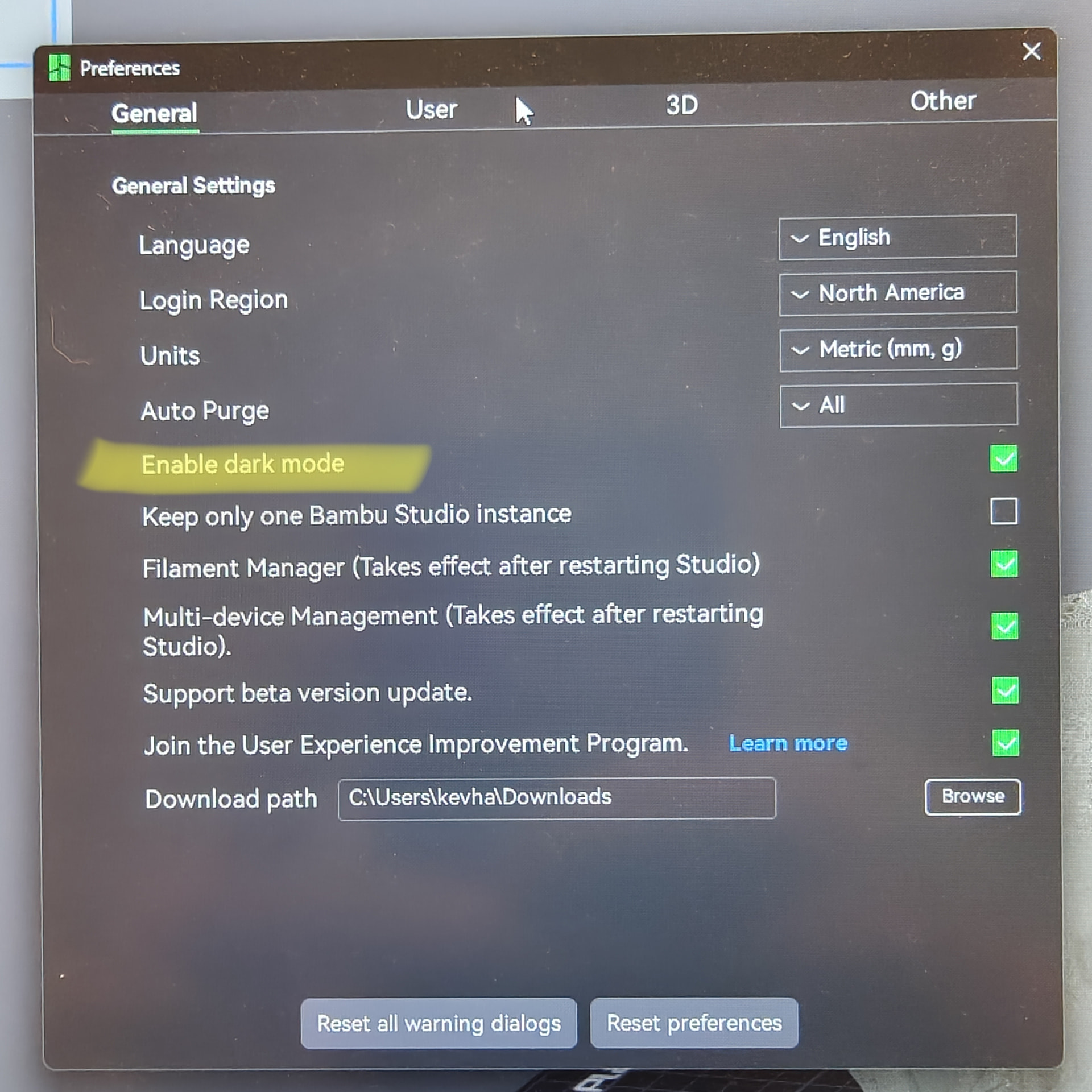

Go to the drop down in the top left corner and select Preferences
Once the Preferences dialog box opens, scroll down until you see the Dark Mode section. Select Enable dark mode.

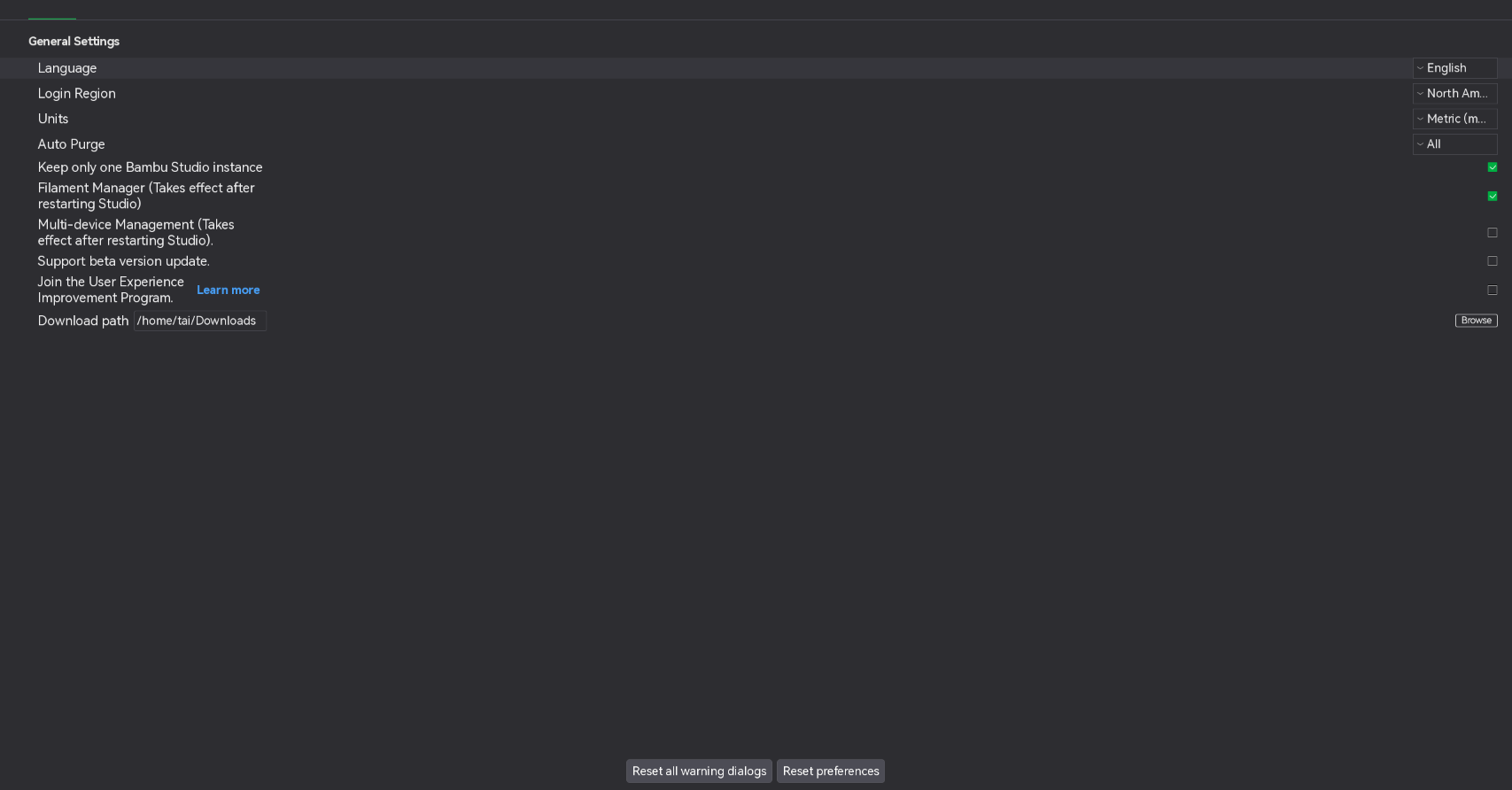

I got it in dark mode but all my sub menus are still white. I cant see any of the options to click on? How can you fix this?

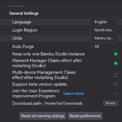

I also noted that the checkbox is just not there from the @RandomKhaos post. At least in the Flatpak version 2.7.1.62, the menu in his screenshots just plain doesn’t exist.
BTW, I’m pretty sure the checkmark for dark mode in Bambu Studio is simply missing for a while now. However, I do remember using this option in the GUI at least 9 months-1 year ago.

I recognize you’re taking about a Linux session, this may not be useful for your situatuob but it should be mentioned for all that Studio reorganized the preferences menu awhile ago, or maybe I should say organized as it was a single long screen before, now it’s a tabbed menu, with this checkbox being in “General” now.

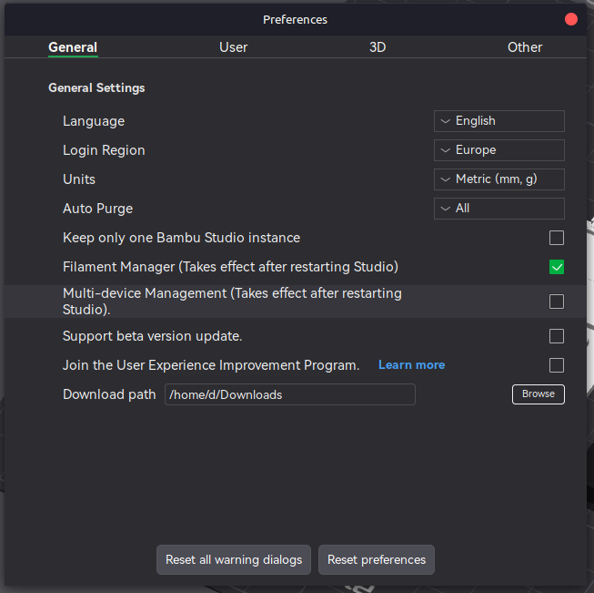

(I’m currently experiencing some sort of UI/UX bug where I can’t access those tabs anymore. This is what I’m seeing right now (though maybe I am overdue for a cold restart):

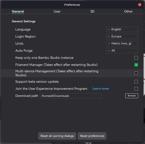

Maximizing doesn’t seem to help:
