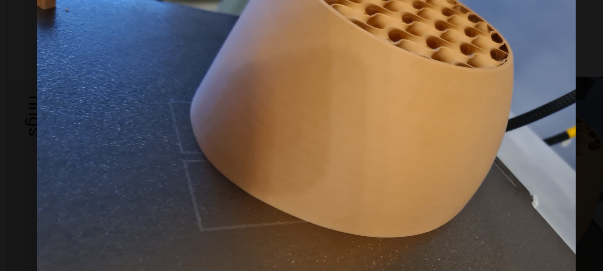

So Im having an issue with some prints where I am getting darker banding layers? They end up striped. Couldn’t figure it out but then on slice did layer time, and the stripes matched up exactly!

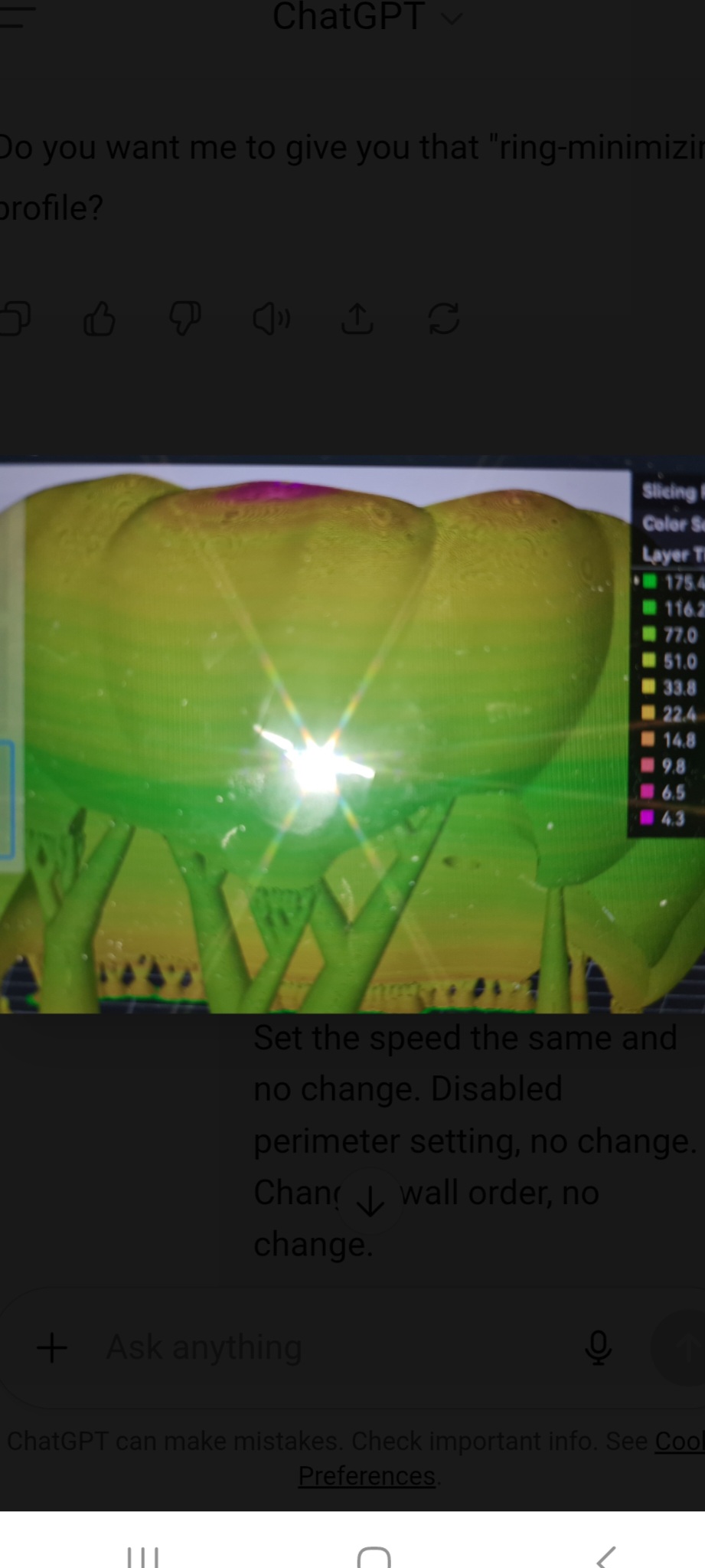

So the difference in layer time is causing layers to print darker and lighter bands. It seems to occur around supports or connector holes basically where the time to print is longer or slower.
How can I change?
I’m printing inner outer inner. 3 walls. 0.08mm. Arachne walls. Gyroid infill at 5 per cent. Matt pla 210 nozzle with 65 texture plate. Speed is around 60mms outer wall with inner and infill around 150mm. Slowed down travel and acceleration. Generally the surface is super clean and clear,bar these bands!
It’s happening on larger rounded models.
One model in print and another pic showing the slice of another model doing the same thing
