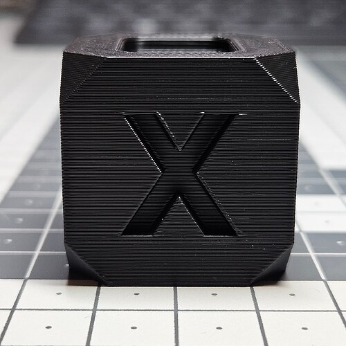

Banding / Ringing type artifacts?
Post the speed view from the slicer - it would help understand what speed the external perimeters are actually printing at, as the filament cooling options in the slicer can affect the print speed. Also a shot with a top down lighting would be better to evaluate artefacts - side light shots tend to hide them.
Finally in the shot above you can see the corners being inconsistent. This may be due to motor movement because of the dampers. Would be good to understand seam placement in that model and whether these artefacts happen because of the seam jumping around or because of stepper wobble.

this are mine cubes with 200 m/s speed.
cube on right was with 0,97 flow rate, and left one with 0,96. But from calibration flow should be 0.97.
One more difference: left one has outer/inner, and right one inner/outer.
But check same settings but with different color (both PLA+ from SUNLU).
Each color behaves differently.
So I think that main problem is extrusion/flow rate. Values from calibration are to high.

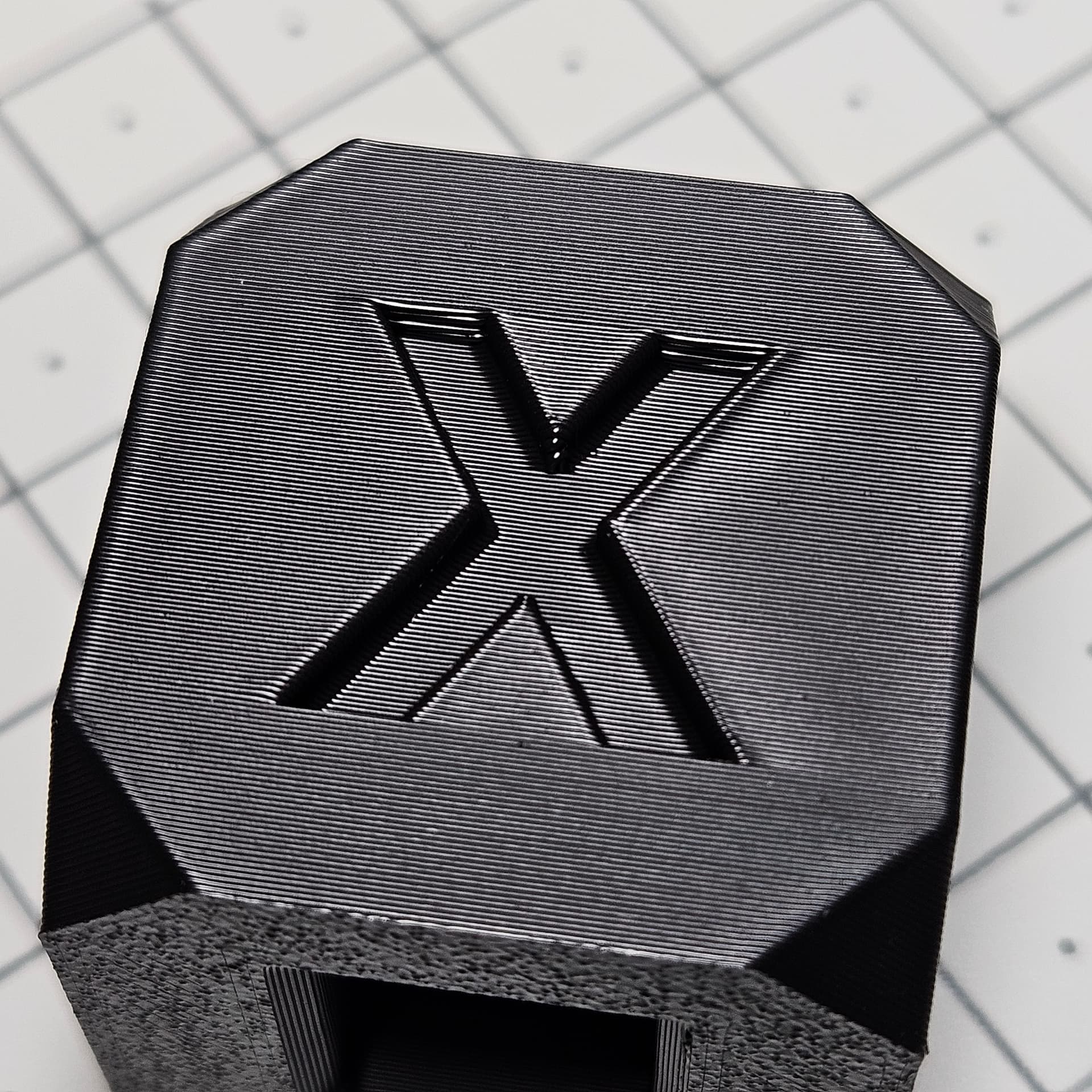

Pre fix is on the right. This is the same plate.
Printed in PETG to show it in the worst light due to shine.
This speed would normally be above the peak VFA speed - can you do a test where the outer wall is printed at 120-140mm/s where the VFA is the worst? The results are promising so far, but testing the worst case scenario is what I think is really needed to conclusively say this is fixed.
I ran the same print at 130mm/sec out wall speed. It looked identical to the one on the left of the picture above that was printed at 250mm/sec. Very slight VFA but barely noticable.

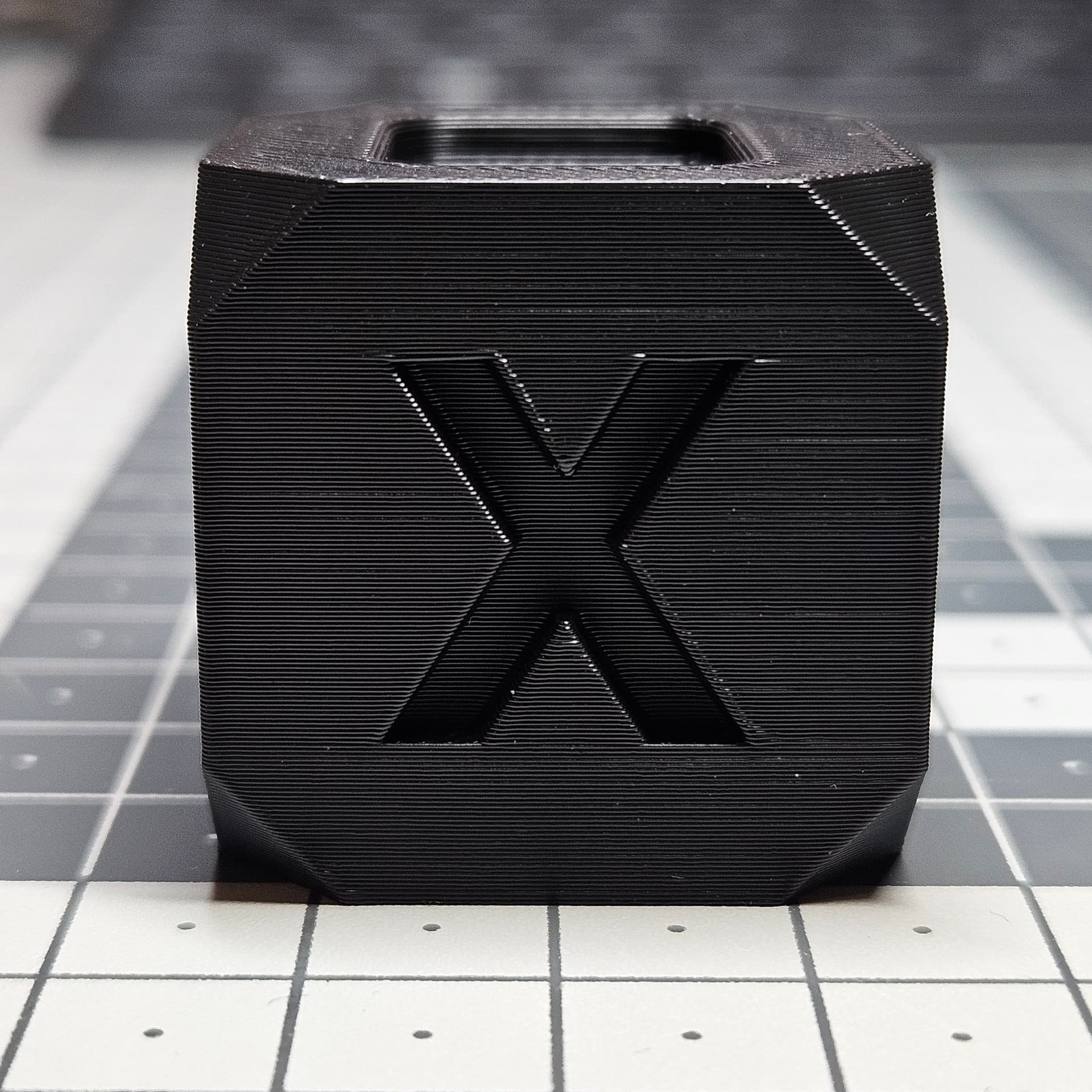

Sorry but can’t understand?
The left object is printed without toothed pulleys and right one is printed with changed pulleys?
We can’t se differences because light is set only on right object.
Besides I can se artifacts on each of elements??
No, the other way around. Left is with toothed. Right is stock.
The light is hitting at the same angle. You don’t see the pattern on the left one because it’s not there.
sorry, but light is at different angle of each object. and we can see pattern on side wall on left object.
