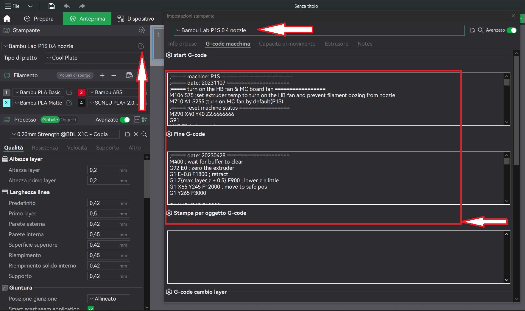

Yesterday I didn’t know what to do and so I printed a test as big as the whole plate of my P1s and 0.2mm high
Surprise: when the Biqu Cryogrip plate is installed the result has a strong underextrusion as shown in the photos…
when the original Textured Pei plate by Bambulab is installed the result is PERFECT and uniform in thickness…
What could be the cause?
Sunlu Black PLA+ 2.0
Same file sliced ​​on BambuStudio
Same filament and settings
Leveling the plate before starting to print
The only thing that changes is that for the Biqu Cryogrip plate I selected the plate (cool plate) in Bambustudio and set it to 40 degrees celsius.
For the Textured PEI Plate by Bambulab I set 55 degrees celsius
I printed twice with the Biqu plate and twice with the Bambulab plate and the result was always the same.

For the purposes of testing, the slicer settings remained the same for both types of plates. The only thing I changed was that for the Textured Pei Plate I set it to 55 degrees Celsius, while for the Biqu I set it to 40 degrees Celsius (basically half the suggested range, as you can see from the photo).
