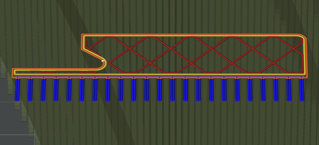

In our previous #BehindThePrint, we explored how changing the geometry and printing orientation of delicate grass blades helped us create dense, fine textures using FDM 3D printing.

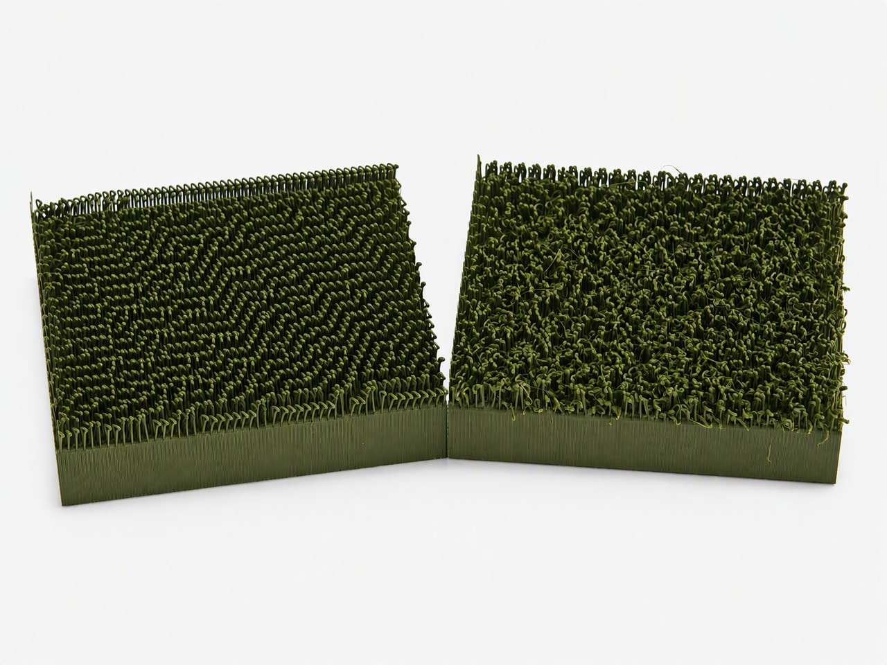

Our 3D-printed grass, however, sometimes looked a little too perfect.
Some test prints produced neatly aligned blades with a consistent appearance. Others developed a more uneven texture, with strands bending and overlapping in ways that looked surprisingly natural.
Similar grass structures can develop noticeably different textures during printing.

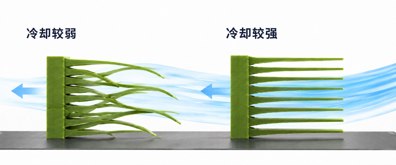

When creating delicate structures with FDM printing, the way freshly extruded filament cools can be just as important as the geometry itself.
This becomes particularly noticeable with overhangs.
Unlike a solid wall, an overhanging feature extends outward without continuous support beneath it. While the filament is still warm, it can bend or deform before becoming rigid enough to maintain its shape.
Cooling helps control this behavior.
With sufficient cooling, the overhanging grass blades are more likely to retain their intended shape. But when cooling is less intense, they may remain flexible for longer, allowing their positions and shapes to vary.
For most functional parts, these variations would be undesirable. For miniature grass, however, they can introduce something valuable: visual randomness.
The grass blades extend outward as delicate overhangs, making their final shape sensitive to cooling conditions.
This doesn’t mean that less cooling always produces a better result. Too much deformation can damage the intended structure or make printing less reliable.
The interesting part is finding a balance between maintaining printability and allowing just enough variation to create a more natural appearance.

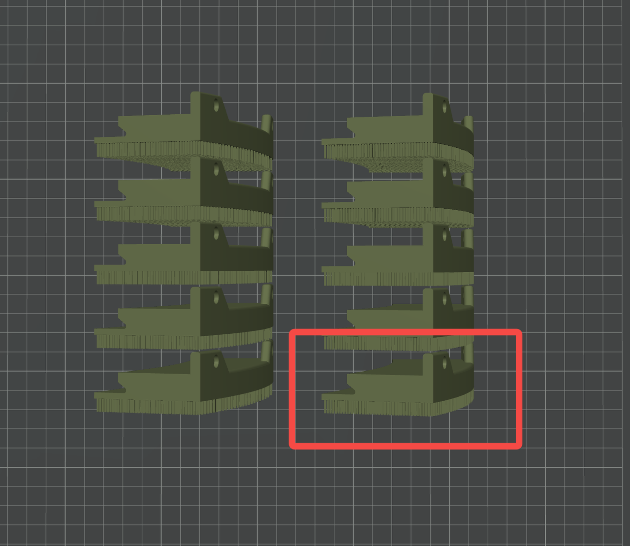

The irregular grass texture didn’t appear evenly across every module. Instead, it was more noticeable in certain areas of the model.
Differences in grass texture appeared more prominently in one area of the printed model.
To understand why, we looked at how cooling air reached the printed parts.
Different printers use different cooling arrangements. Fan placement, airflow direction, and the surrounding printing environment can all influence how effectively individual features cool.

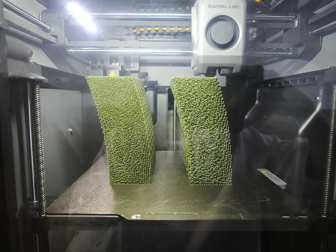

In our tests with a P2S printer, we observed differences across the printed grass that appeared consistent with the position of the auxiliary cooling fan. The auxiliary cooling fan is located on the right side of the printer. Its airflow is concentrated near the center of the build chamber. This suggests that cooling is weaker in the lower-right area of the chamber. So the overhanging structures deform more before they fully set, leading to an irregular grass-like texture.
Earlier tests on an A1 printer had produced a more regular texture.
Cooling conditions can vary depending on the printer’s airflow arrangement and the position of the model.
An important realization followed: even when the 3D model remains unchanged, the printing environment can influence the final appearance.

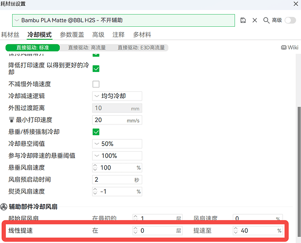

Once we recognized the relationship between cooling and the grass texture, we explored how adjusting the cooling conditions could influence the result.

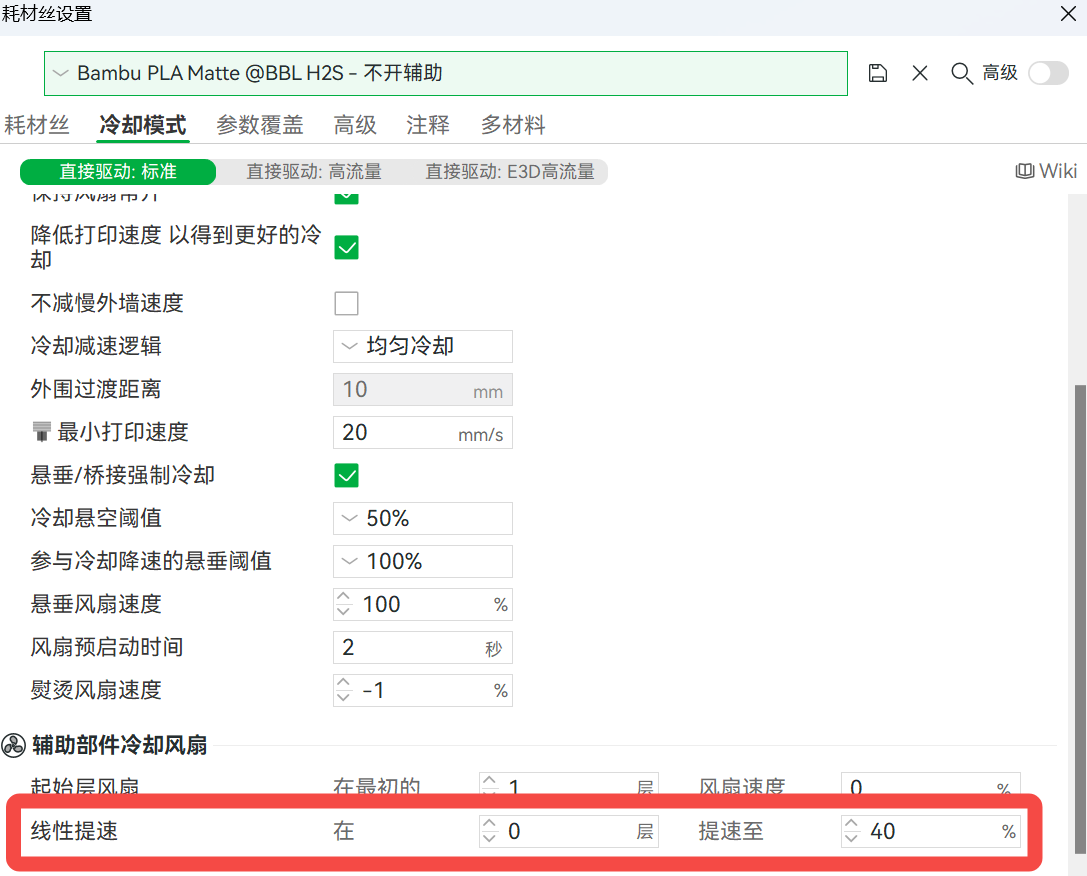

Rather than changing the entire design again, we experimented with reducing auxiliary cooling while maintaining the cooling needed for the main printed structure.
We wanted to encourage some variation in the individual blades without losing the overall stability of the grass.
Adjusting cooling conditions offers another way to influence the appearance of delicate printed features.
This is where the process becomes especially interesting from a design perspective.
A setting normally associated with print quality can also influence the visual character of a model.
However, the ideal cooling balance is not universal. Different printers, materials, model geometries, and airflow arrangements may require different approaches.
Rather than copying a particular fan setting, it’s more useful to understand what cooling does to the printed feature and observe how the result changes.
