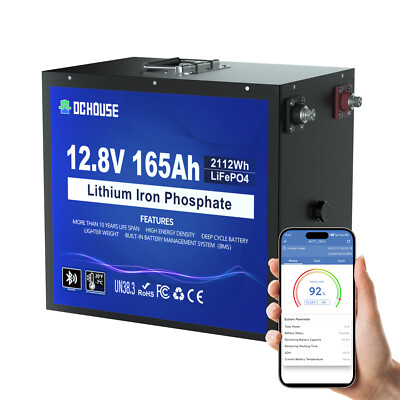

Any input on which batteries and how many for max capacity?
I’ve had good luck with these:
From time to time they go on sale for $180.
The advantage over other options are:
  1. cost
  2. metal case
  3. bluetooth for reading the interior cell voltages as a check to ensure that cell balancing is working. also monitor interior temperature as a further check.
  4. you can open it up by unscrewing and inspect the cells for swelling if you ever want to. Most other batteries have plastic cases that are permanently glued shut, so there is no non-destructive way to check for this with them.
The listed spec says “Standard Charge/ Discharge 83A/83A” That should be more than enough to run both printers simultaneously. That’s just 1/2 C, so it shouldn’t pose any challenge.
If you only care about running each printer for 5 minutes to get past the “hump” of power draw, then one should be enough and still leave headroom. You could always add more in parallel though if you wanted to run longer a lot longer.
You can find a teardown on youtube if you want to look inside. That’s what I did before ordering mine. I have four of them. I ordered mine on sale last December, and they all arrived very well packaged in foam and with no damage.
