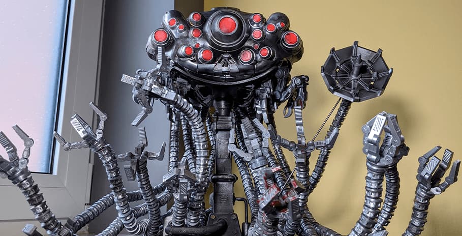

This is a 48 hour print (not mine) on a H2D. It’s kind of stupid since he could have probably printed two in 50 hours, but still how would you feel if you lost this print? The ecoflow was $590 and unlike the one on my router I can unplug this one and take it camping too, so it’s not money all tied up just for this.
