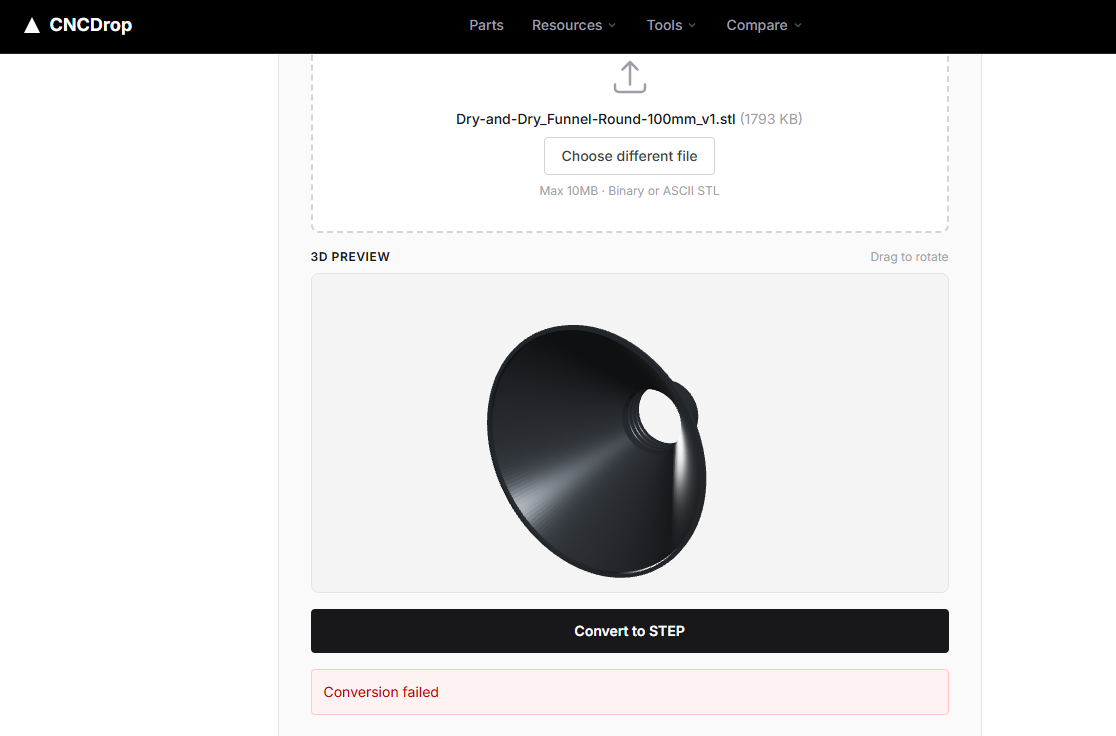

OK, I just tried the first 6 of them on the list that google found, and–no surprise–all but one (?) of them failed. The one that said it did the conversion would only provide the file if I downloaded their executable to get it. No mention of that requirement beforehand. Uh, sure… And then what demands come after that? Sounds like a honey trap to me, with ransomware as the payload. Anyhow, I’m not willing to risk it. Frankly, even if it were legit, you’d have to be stupid to accept an offer like that from a random, unknown website. And the people running it should know that.
I’m guessing that if it truly could be done automatically, then at least one of the CAD packages would have a tool to do it. QED that most likely all the “free conversion websites” are fake. On the other hand, if someone can recommend one in particular that really does work, I’d be happy to try it.
