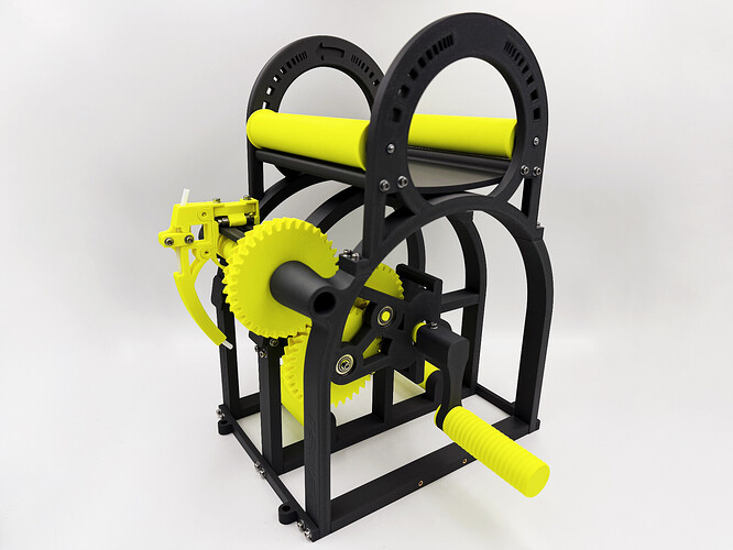

I’m a big fan of the V-Spooler X available here on MakerWorld. It has a long set of instructions to guide you along the construction process and you can follow them Ok but it certainly could be a bit more clear. You’ll get through it and the designer answers questions so that helps.
Definitely like the stacked design. It’s a nice design and it handles 5K spools so you can purchase large spools at discounted prices and re-spool onto 1K (or smaller) spools for printing.
It also has a drill attachment included (in addition to a hand crank) so you can power from battery drill for easy spooling. The designer is also working on updating the design so you can attach a motor to the mechanism and it fits right into the frame so you don’t have to hassle with a drill (should be out soon). The winder mechanism is Ok (not great) and it does a fairly good job of directing the filament in rows as it spools. This is one aspect that could use some improvements but overall it works.
It’s a long set of prints but everything goes together quite nicely. I printed in Elegoo Rapid PLA+ (PETG not recommended, since it has too much flexibility). I originally started in PETG but after the first batch of prints I switched to PLA+ and it came out great (much more stable in PLA+). I printed it on both my A1 & my FlashForge 5M Pro and everything fits like a glove.
It also has a TPU attachment (I printed in FlashForge flexible PLA which worked really well) for incorporating a Sunlu Filament Connector unit into the path so your can easily attach filament strands and wind onto a roll for printing.
It does use brass inserts for solid part connection, so it does require you to have the needed components to get these inserted correctly.
I’d rate the overall construction process as moderately difficult. But it’s a great feeling when you get everything to come together and you see it working. If anyone has any questions about it, just let me know.

I agree. The V-Spooler X results are similar to yours (I haven’t taken any images of spools I’ve rolled but I will on my next re-spool and post back). It certainly isn’t perfect but I think it does a reasonable job (very similar to what I get from ZYLtech). Not as nice as Bambu or Eyeone or others but I also don’t believe that level of a neat roll is really that important. I’ve not had any problems with rolls I’ve re-spooled on the V-Spooler X with the AMS Lite (& external mount) so I’m happy enough.

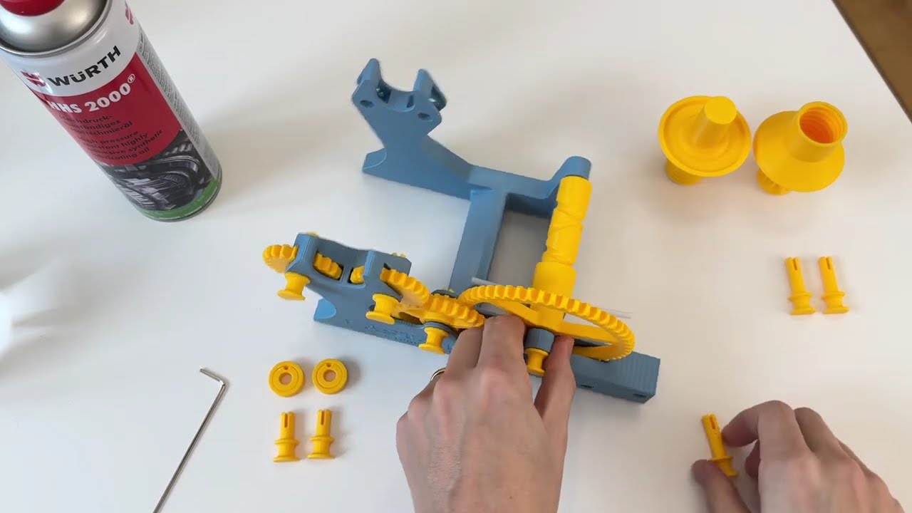

Here is me fixing a loose spool with the Pasta Lite. I had to clamp it down with the spool holder because it didn’t fit onto the spool anymore. The donor side kept getting loose because the pressure from the donor spool was decreasing as filament was being removed. (I’m wondering reversing the thread direction at the expense of intuitive use - easy to just mirror the parts in the slicer…)
One mistake was not transferring the RFID tag before respooling, so I double respooled to get the RFID back. (This was PETG - didn’t need to be double respooled for stress)
I’d call it a success though :slight_smile:
And here is the assembly video of the receiver side (the donor side just attaches with 2 more pins). No heat set inserts, no screws, no bearings (but can be added), no electronics, just one short PTFE tube and maybe 3 minutes:
