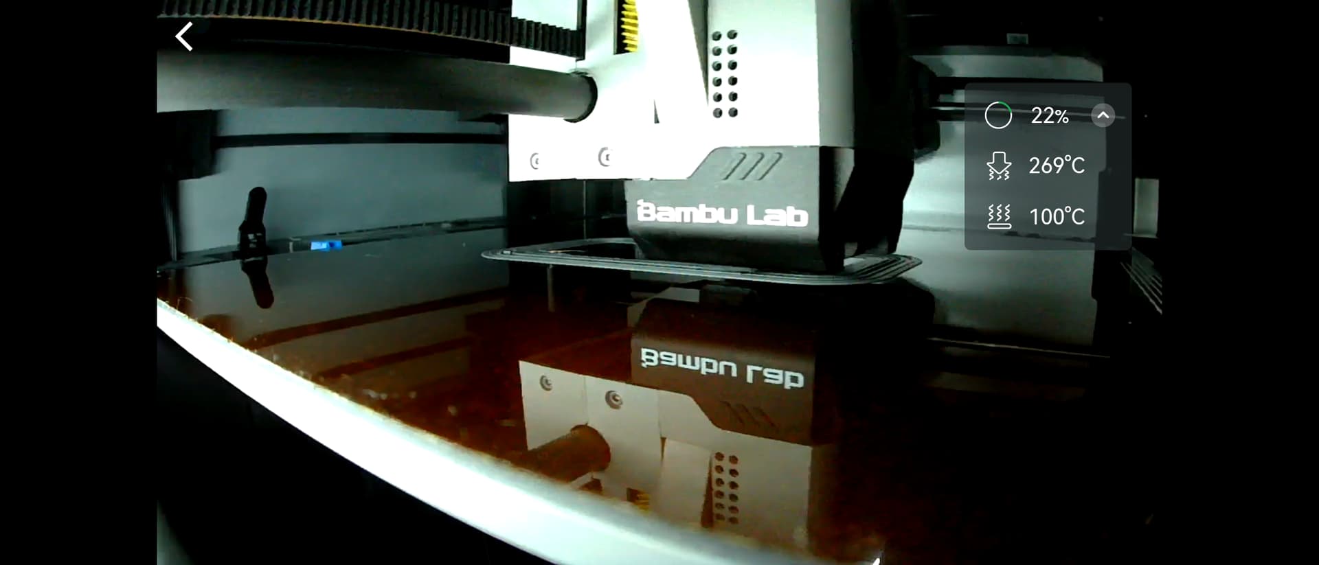

I’ve had nothing but great success with the BIQU Glacier Plate on my H2D. Very first times printing ABS, very long prints of like 8 hours+ and absolute zero warping.
But I’ve also heard others with bad experiences too. So it’s weird. Almost makes me wonder if there were bad batches of plates.
