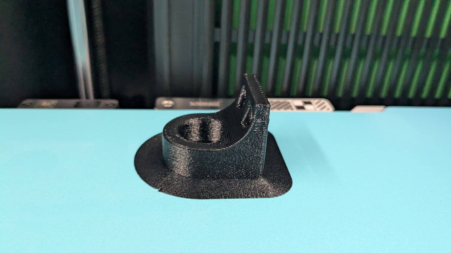

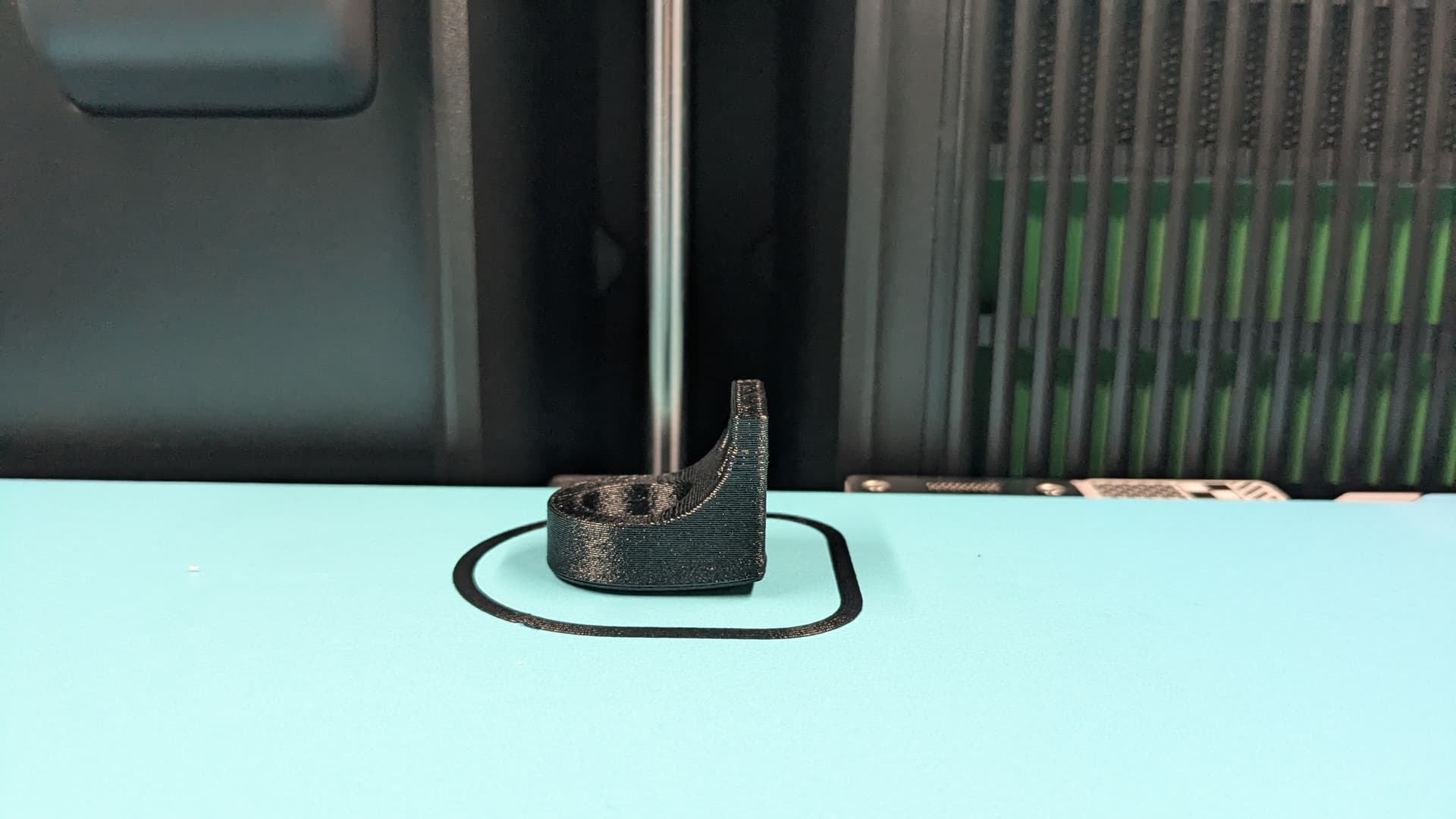

Just tried my first prints with Bambu’s PA6-GF on the glacier and after applying as many tips as I’ve found out the forum… my part refuses to adhere to the plate. Generic glue stick doesn’t do the trick, I guess it’s time for a more specialized adhesive :frowning: Any brand recommendations or other advice?

Try a brim. The skirt doesnt do anything

@StreetSports I’d say the brim made a difference here :wink: solid advice, thanks so much for the quick and concise reply.

My second advise is to print in the center of the print bed. Avoid the edge usually a cooler area.

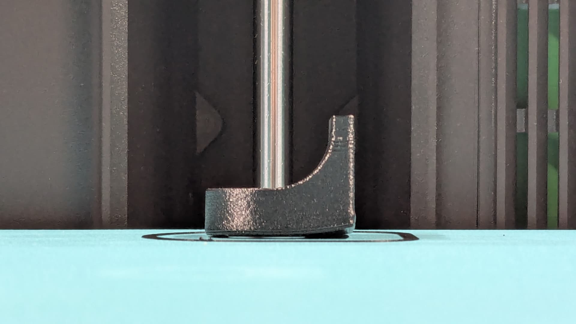

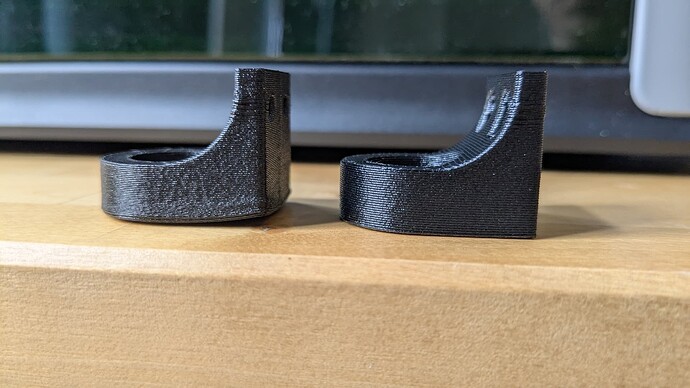

I have to say, after printing PA6-GF all weekend, I have really changed my mind about the glacier. Adding brims and mouse ears has eliminated all warping and no adhesive is necessary. I’m still not very impressed with ASA adhesion, but for Nylon, it’s a fantastic plate.
