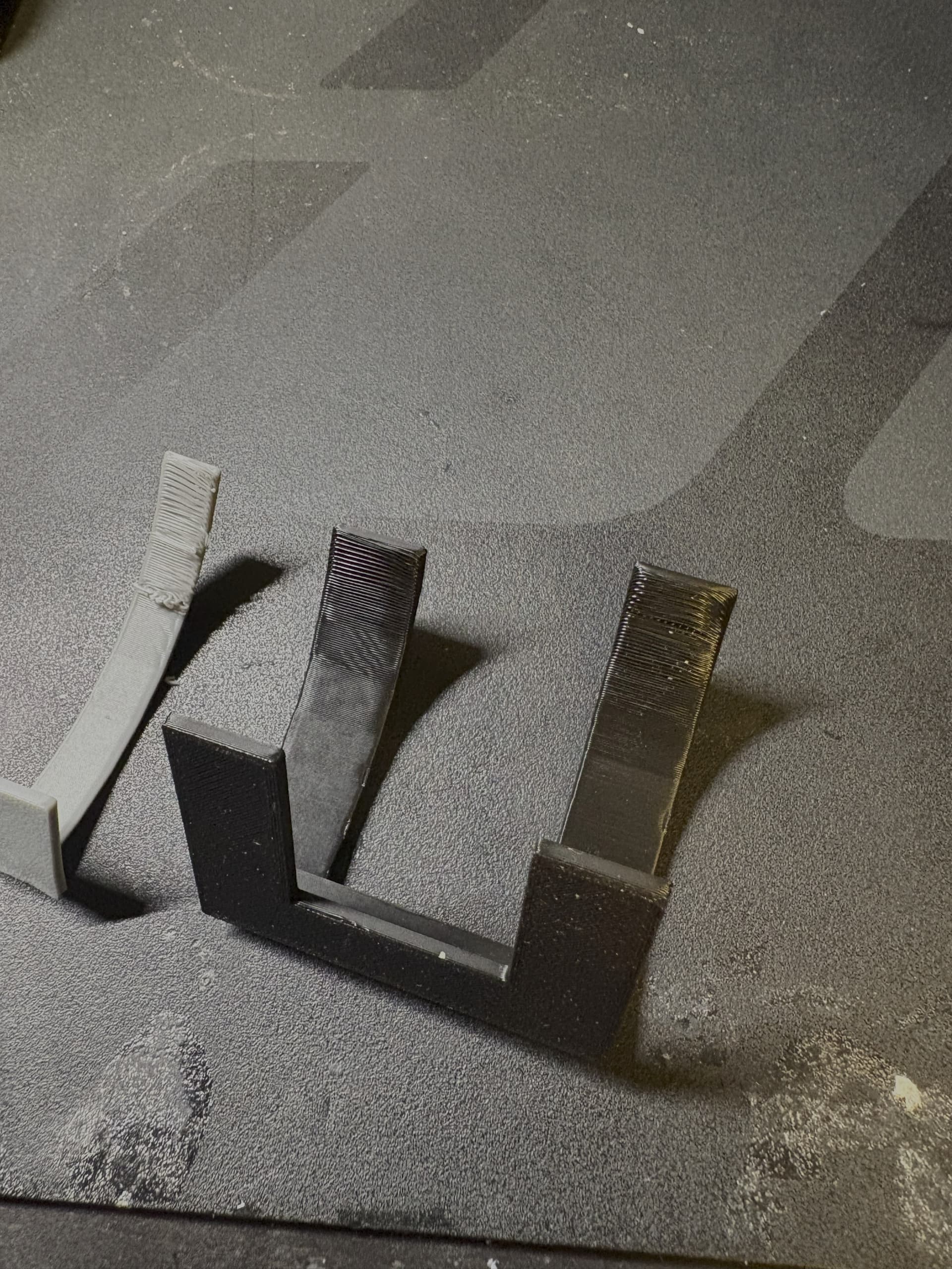

I’ve got one. It gives a real breeze. Haven’t compared it to anything yet, but I feel that overhangs look better.
Can you do overhang test please?
Will do. I’ll start one in 90min. And Post the result an hour or two later. If I don’t fall asleep first.
The results were ■■■■, just 45degrees, I’m guessing I’ve messed up some settings… Have done 60 degrees before. Will do some research and redo the test tomorrow. Need some Zzzzz’s.
I must have been doing something really weird last test. Here are the test with the Breezer in gray, The black one is from the stock setup. Some better performance in my eyes. I’ll try to do some tuning and post the results later.
