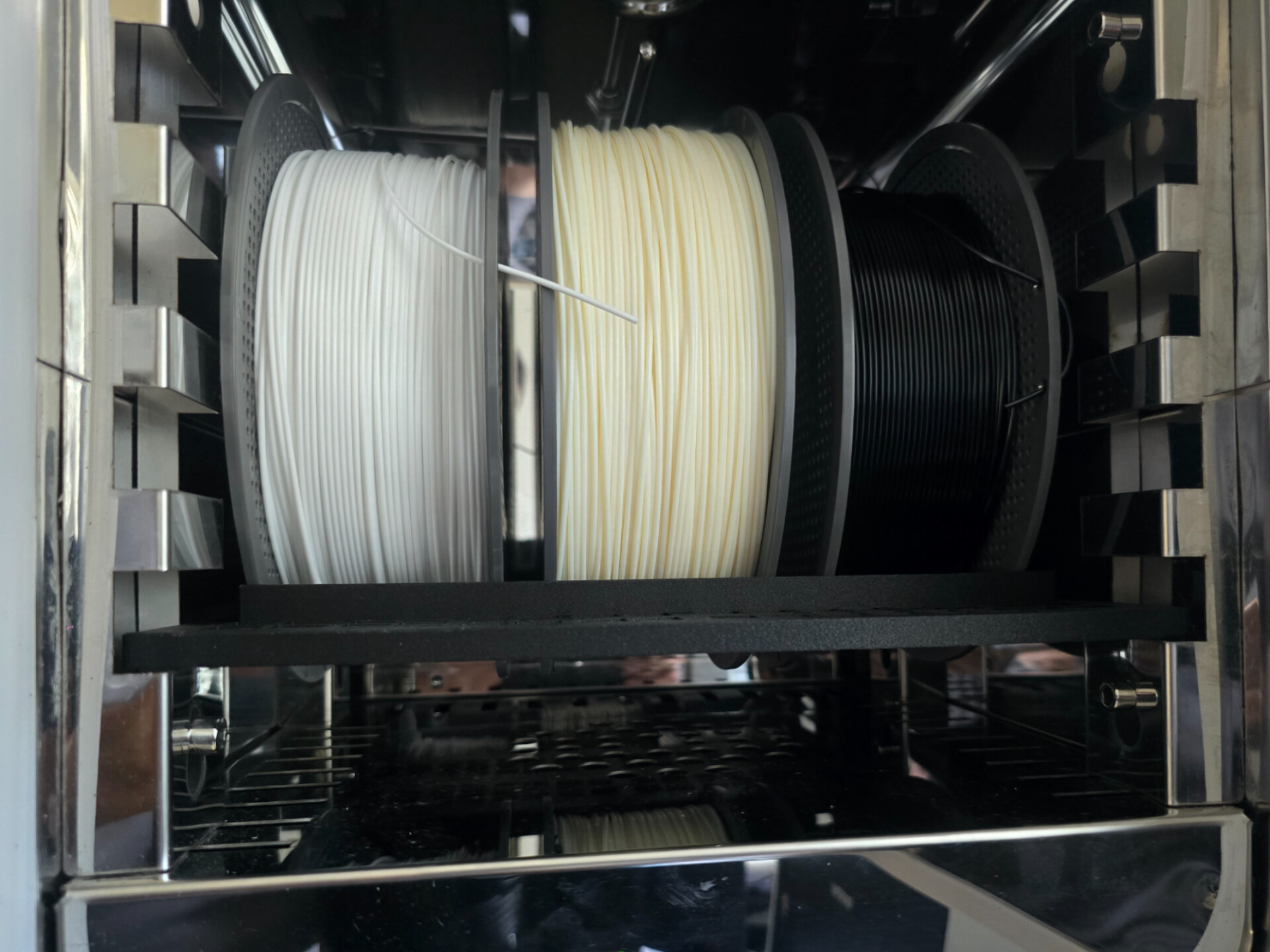

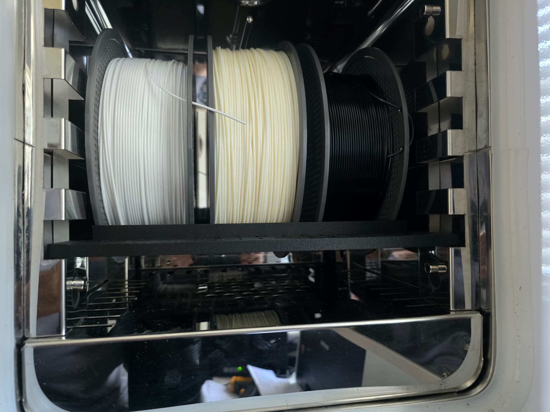

I have a unit that is basically the same but I got the one that is taller instead of wider. Wider would probably work better for parts. This one fit in my space better for me and I like the vent out the top. The sides only get warm to touch. The AMS HT actually gets hotter to touch on the sides. I do get heat coming out the top, more when the fan is on.
I keep the top mostly closed as the heating element cycles less and I don’t get any thermal runaway or overshoot. I don’t have any issues with filament not drying fast enough. It actually dries faster than what they say. As long as there is somewhere for moisture to escape too it will be fine especially with how long we dry filament for. I 3D printed a custom rack for mine. The original rack height would only let me get 2 rolls in if laying down or standing up. The 3rd would technically fit (in either direction) but it touches the thermistor probe at the top. My rack lets me stand the rolls up and they don’t roll around. I made the center a hollow cradle so it drops the rolls down about 20mm. This configuration also lets the hot air (on mine) blow around the filament from the bottom and out the top. It now has 35-40mm on the bottom and 20mm on the top below the thermistor.
