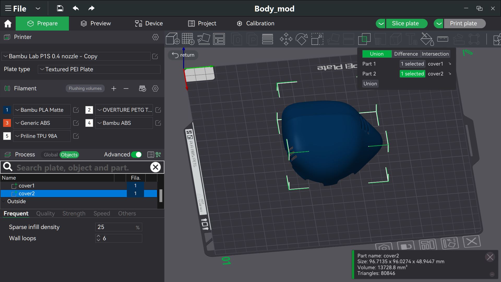

here are screen shots. The first is setting up for a union, the second is the response i get after I press “union”. Although I’m seeing that it saves
it as unioned.
Oh boy how a picture can really help cut out the mysteries. Thanks for posting Clean screengrabs. This helps a lot.
TL;DR version:

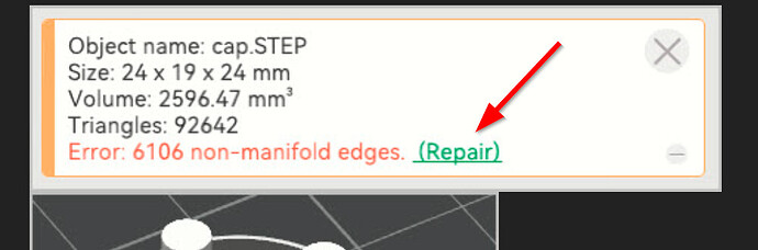

- Your Cover1 model has a defective mesh. Click on the “repair” button in your cover1 model on the lower right corner of your screen.
The full message that is clipped on your screen is:
Warning: Unable to perform boolean operation on model meshes. You may fix the meshes and try again. Reason: part ‘cover1’ has self-intersecting geometry.
What causes this is that your model Cover1 has holes in the mesh which make it non-manifold. Think a manifold mesh as being a series of interlocking triangles that when connected make a water tight container. However, in your example, I would bet that “Cover1” has an error message stating something like this:
__________________________________________________________
I just answered another post not more than two hours ago on this very topic and went into depth on how this works if you’re interested in fully understanding mesh’s and manifolds.

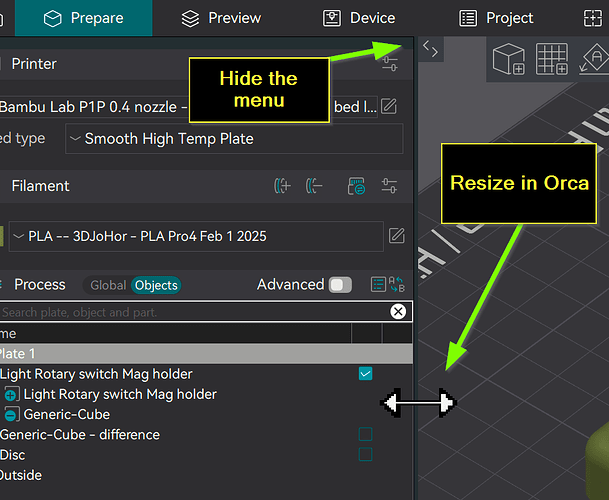

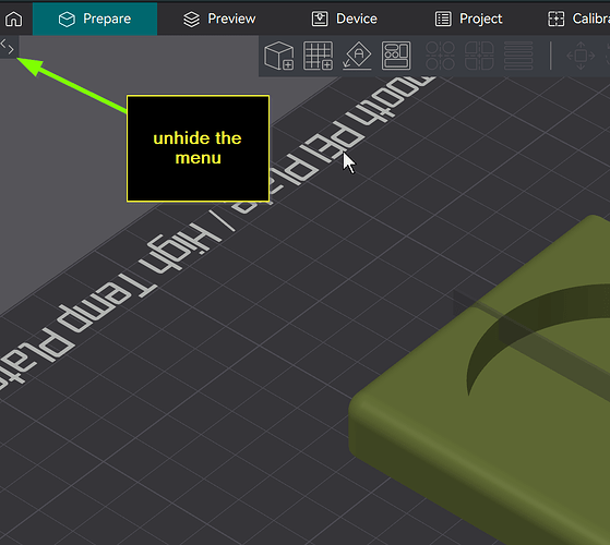

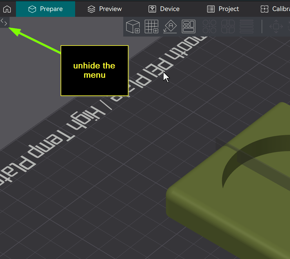

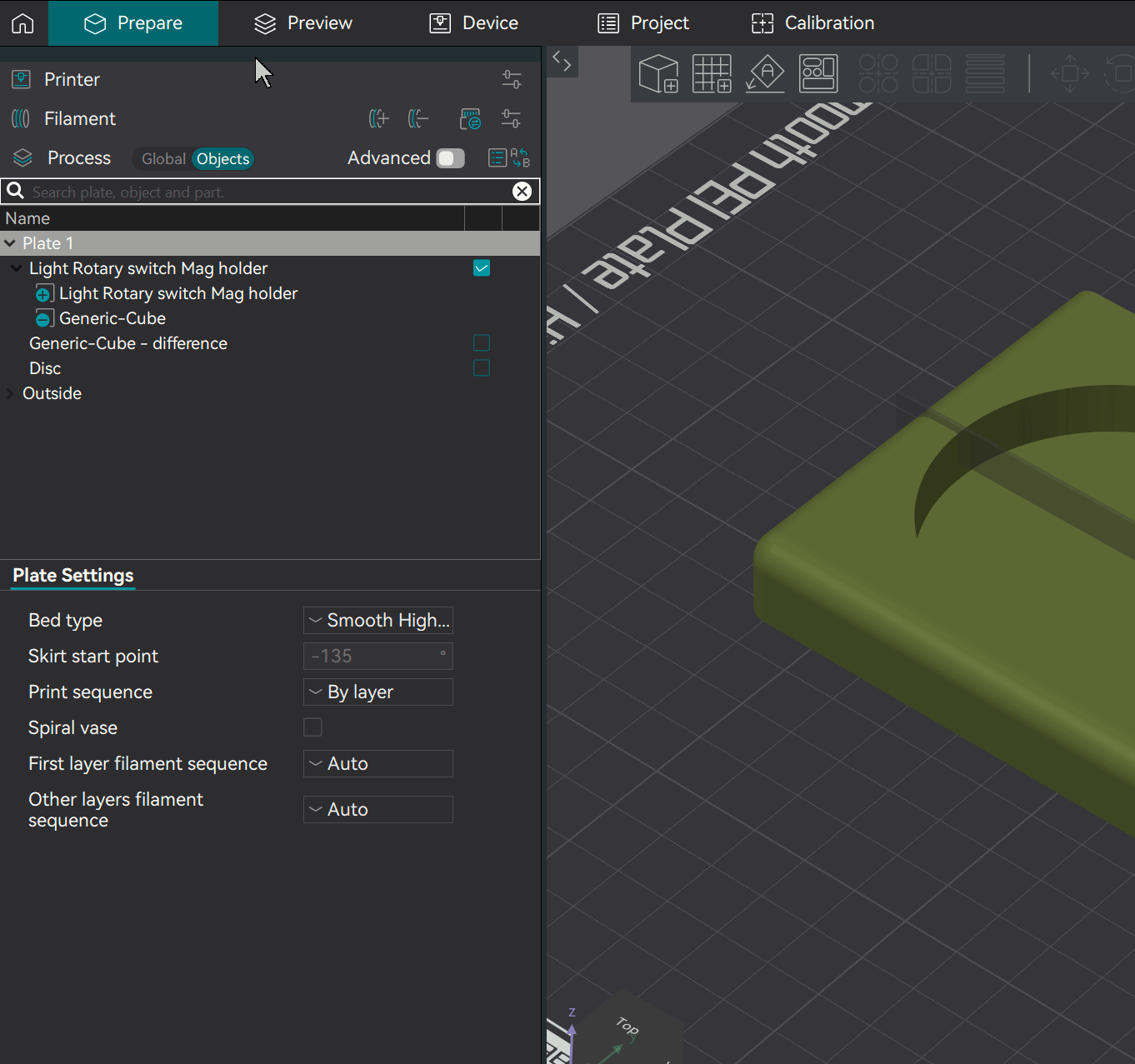

Another option is to load Orca slicer which has among so many quality-of-life features that Bambu simply won’t give us, you can resize or even tear away the menu giving you extra screen real estate. You don’t have to choose between the two slicers, both can be run at the same time. But I promise you, after a little while, you’ll wonder why you still have Bambu Studio loaded on your system once you get used to the many Orca features.
Tear off menu feature making it a movable window.
