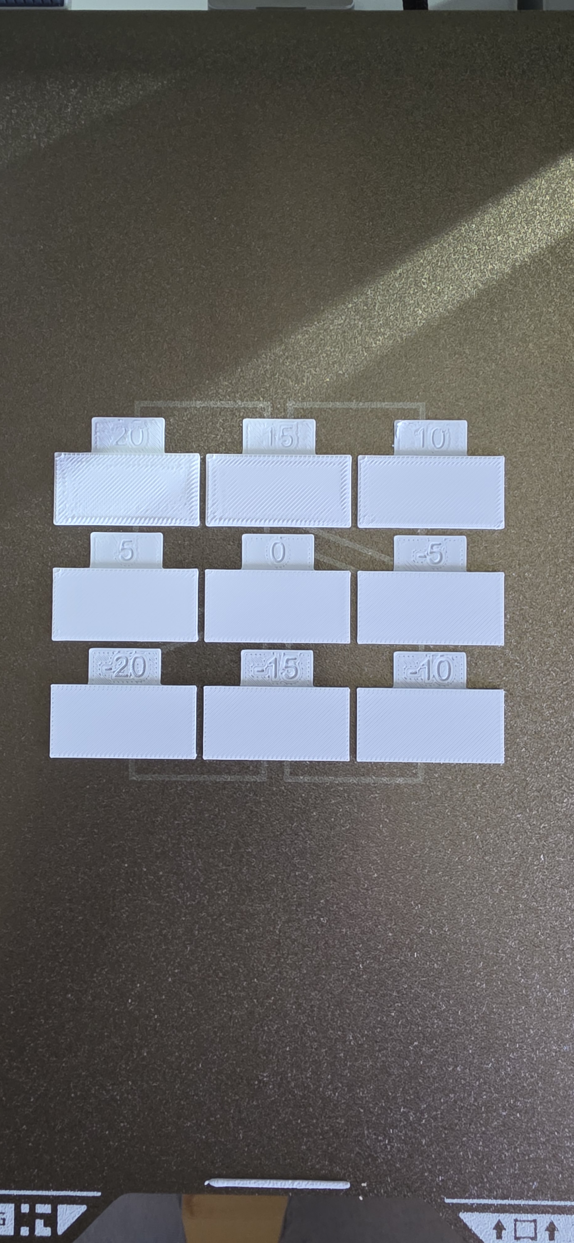

Calibrate it, yes again, then take some photos of it; it won’t take more than 15 minutes. You can do that here:
Even if you’ve already done that: The error should actually be noticeable during calibration, so photos of it would be extremely helpful. It doesn’t make much sense to print if the calibration may already have faults.

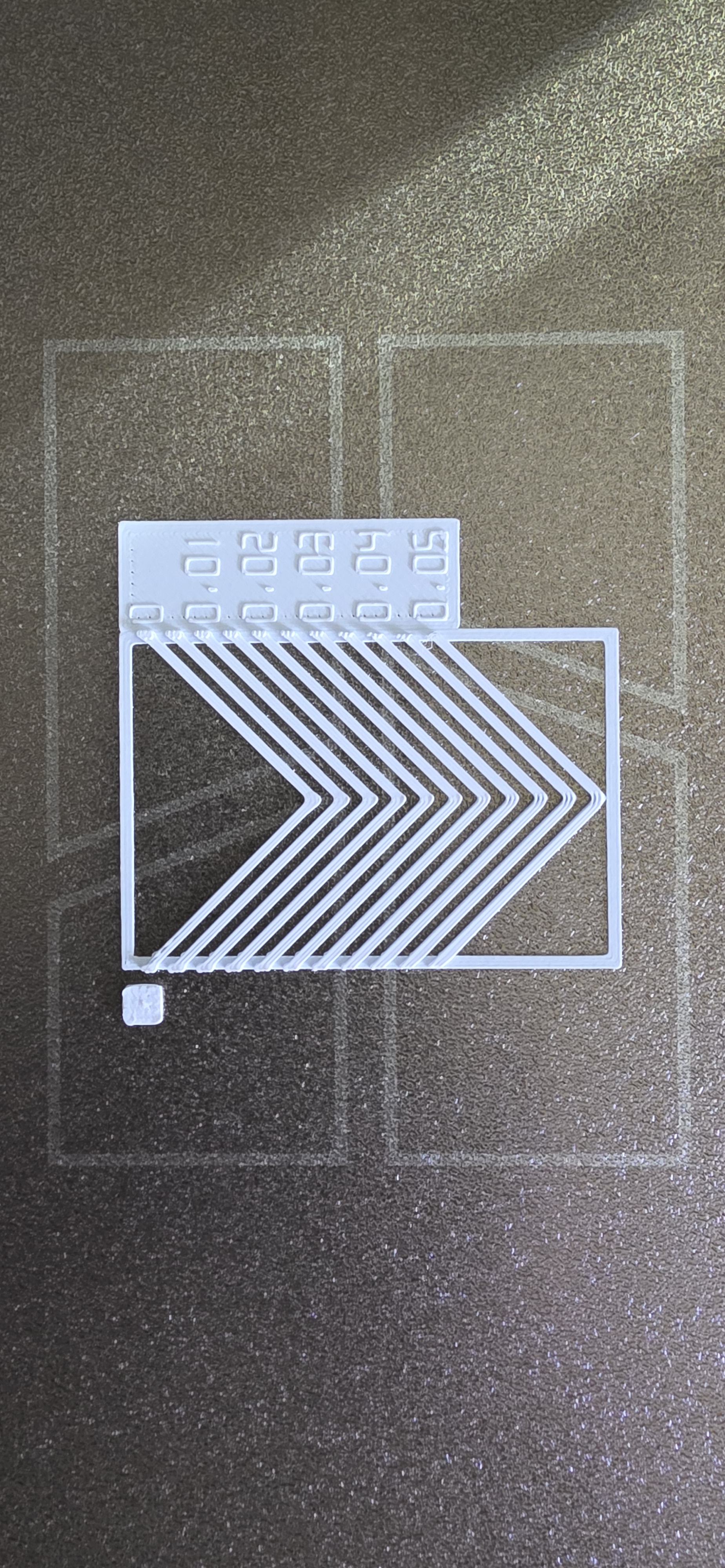

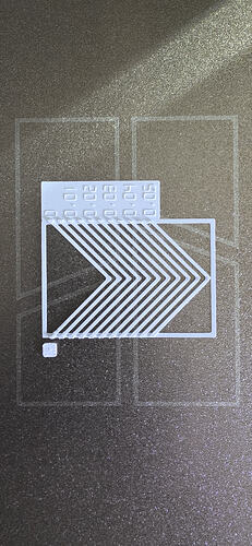

Hi, I’ve done the calibration and it all went as it should or are you asking about the flow calibration sorry?
I did check the screws on the belt tension and they were okay.
I will run the flow calibration again when I get home and I’ll print a benchy and upload pictures too… Sorry but I am frustrated as I bought this for a specific reason and it’s giving me nothing but bother and I’m not very tech savvy which isn’t helping matters on my end. I will do the flow calibration again if this is what you are referring too and the benchy and take images of them..

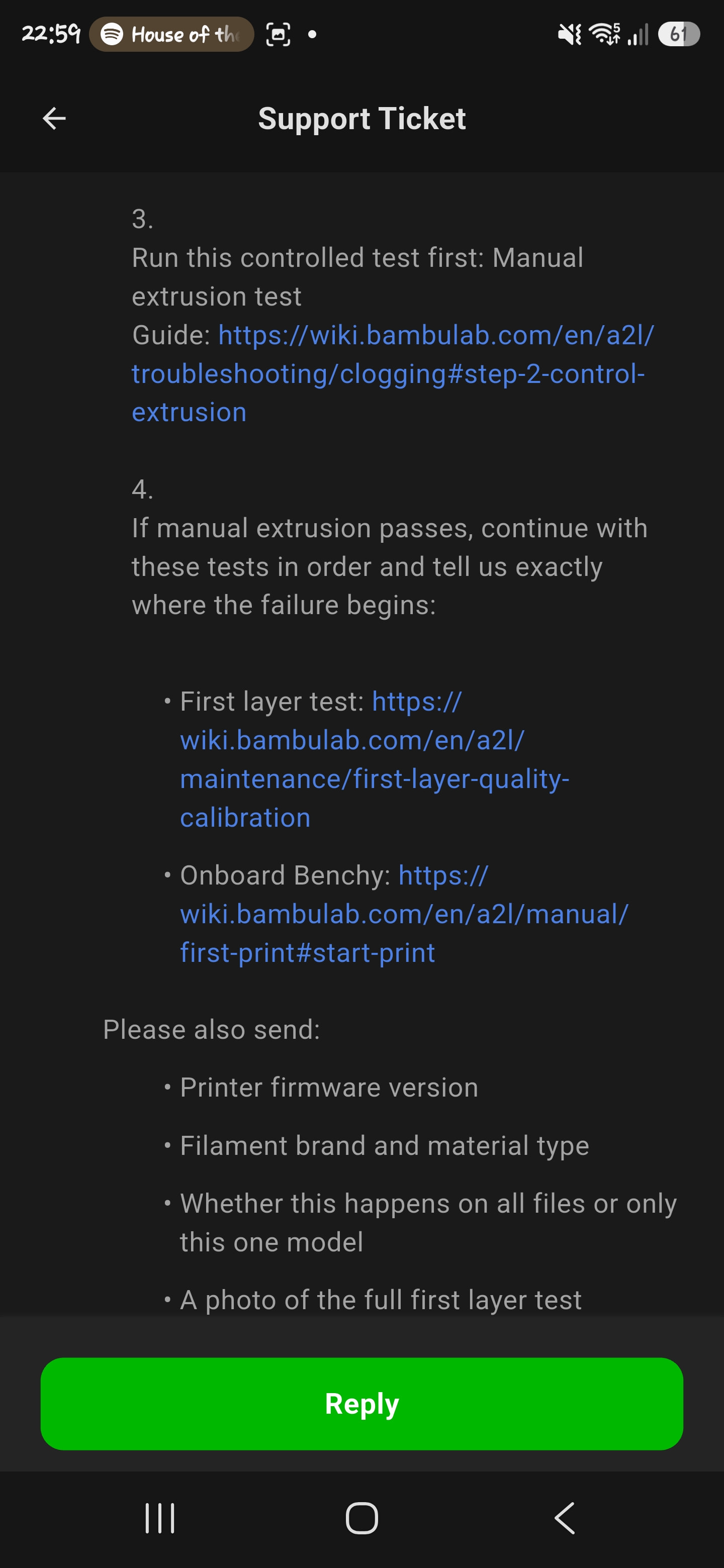

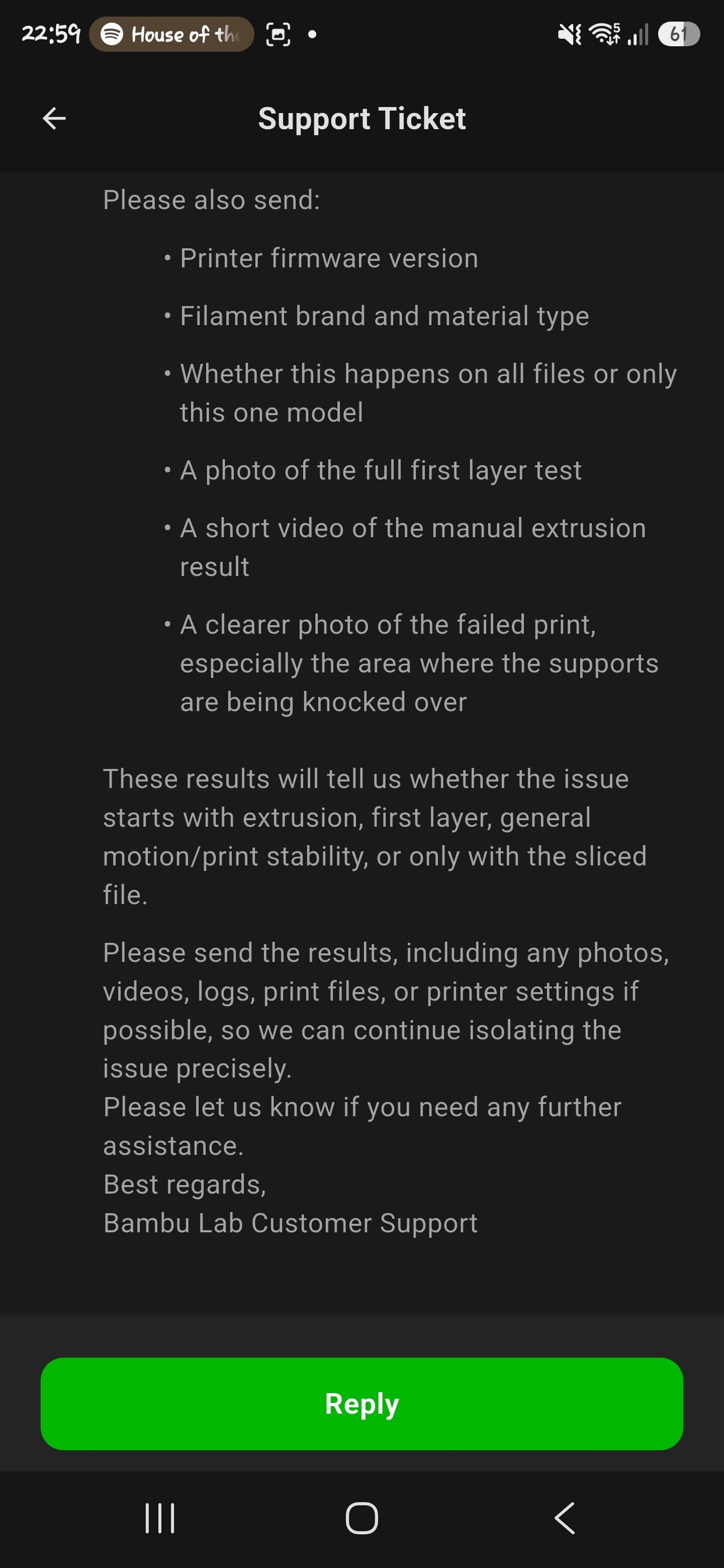

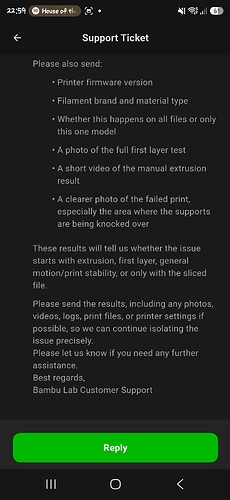

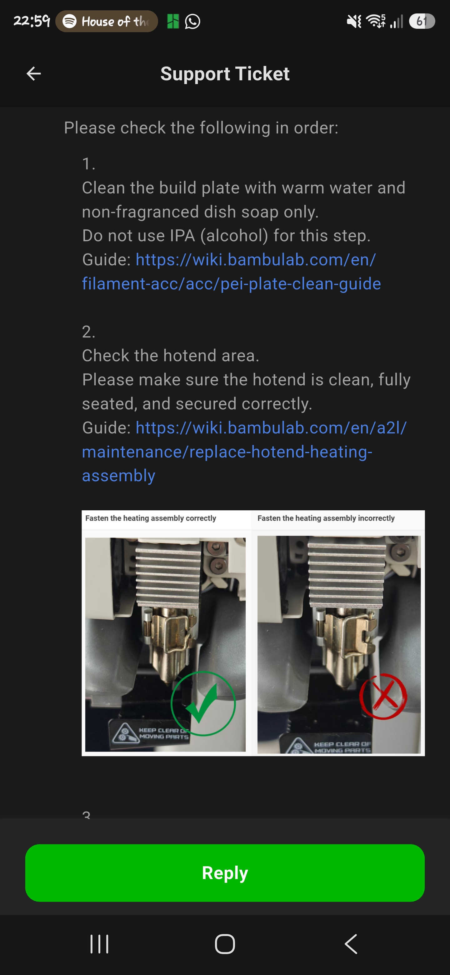

Bambu has got back to me, I will attach screenshots of their advice.

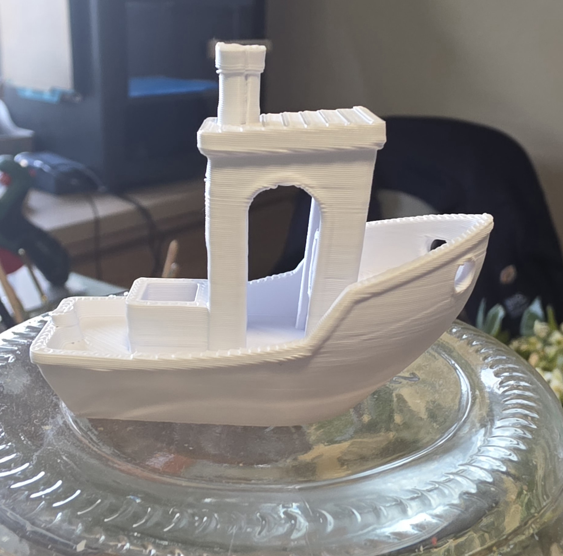

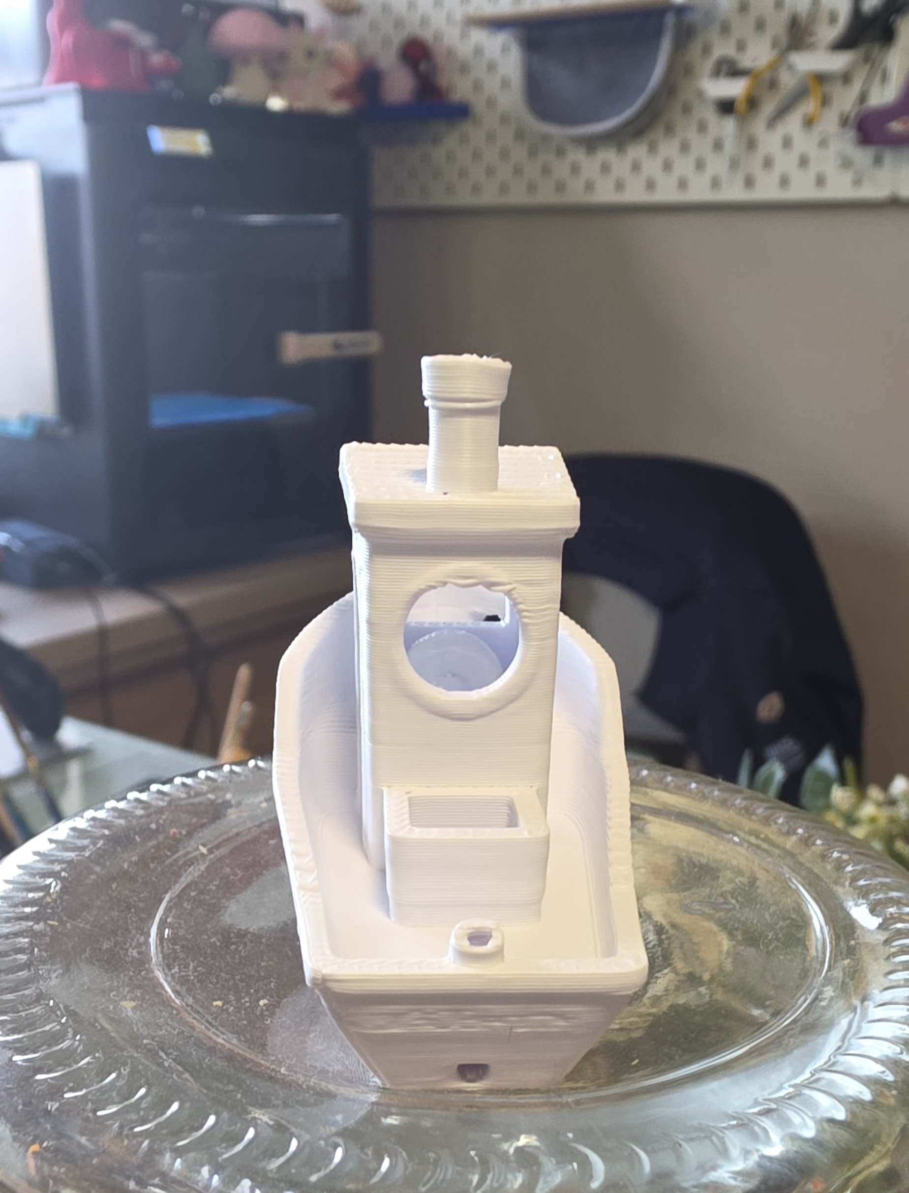

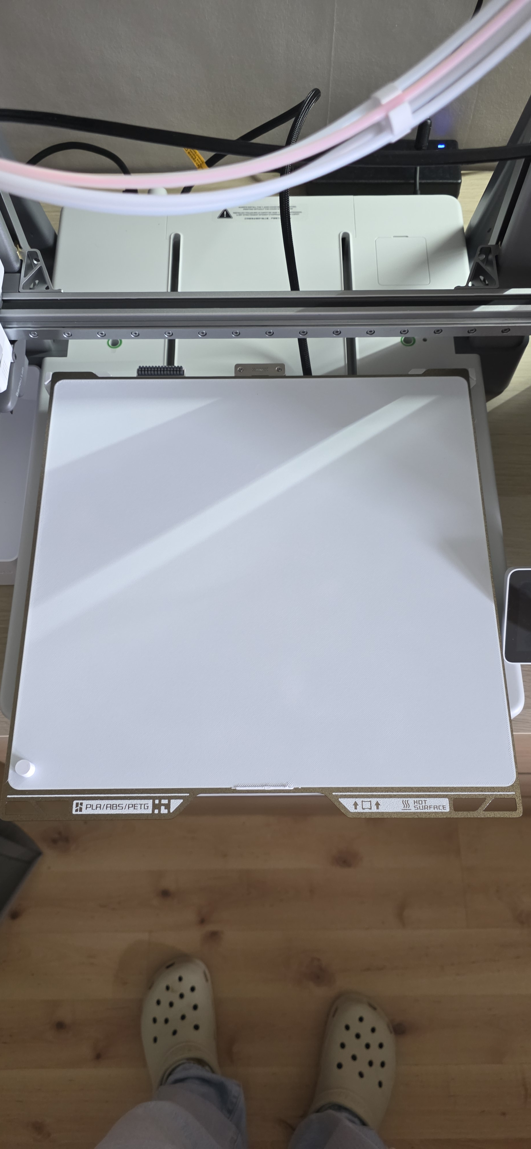

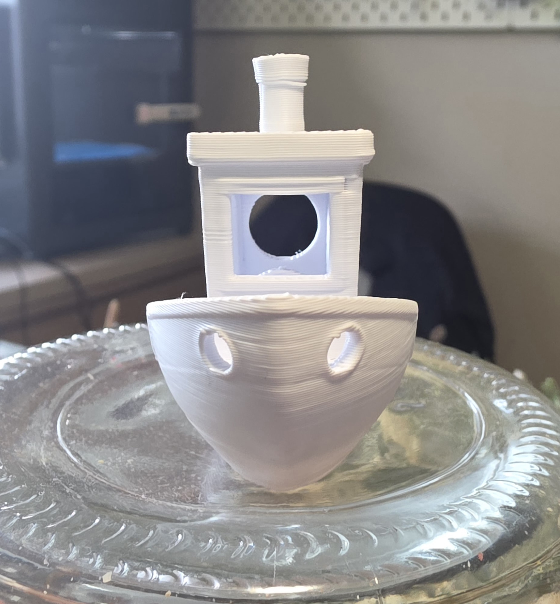

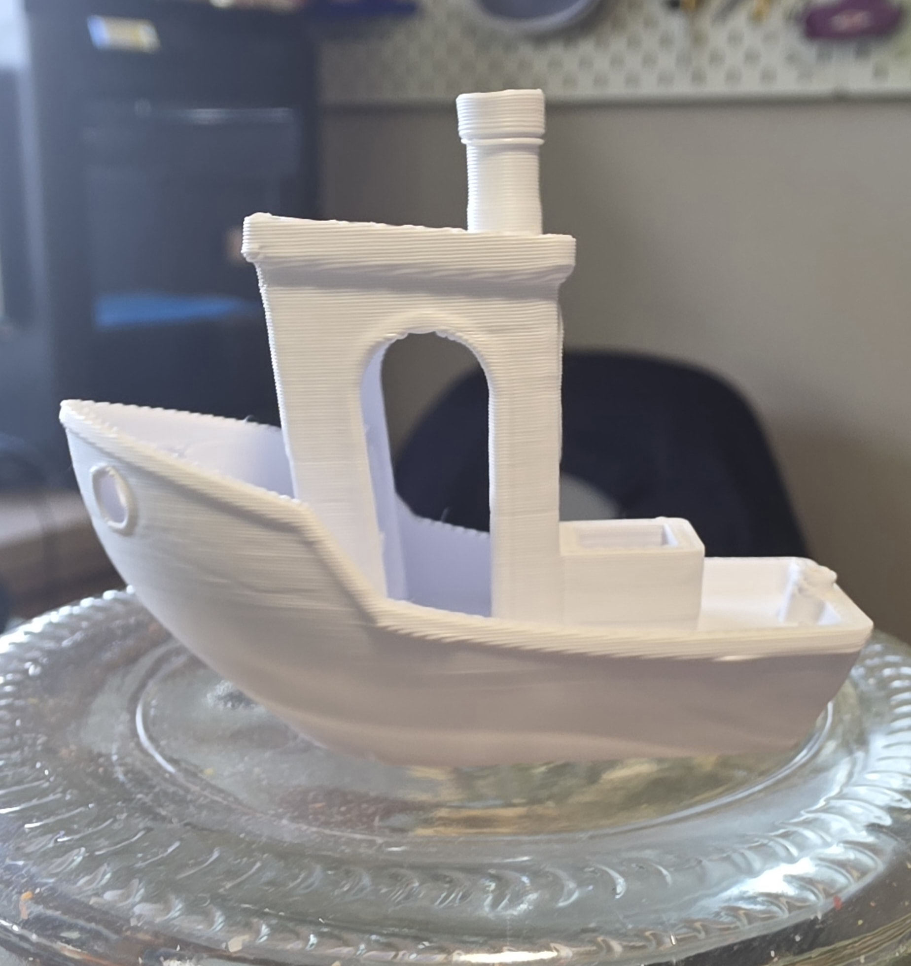

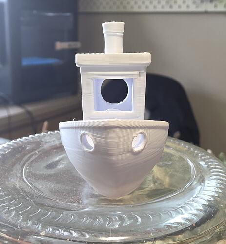

Hi, I’ve ran the calibration again and I have included the results. Hoping you can see something in them. I will say out of all my printers that is probably the worst benchy that has been printed.
It was printed directly from the printers screen.
Thanks
So, at first glance - no in-depth analysis.
The calibration looks good, but the Benchy print looks really bad. It seems like the individual filament strands aren’t bonding together. This suggests that there’s something fundamentally wrong with your printer, so there’s no point in experimenting with the settings in the slicer.
Something is fundamentally wrong.
I mean, a Benchy always has a few tiny flaws - it’s supposed to push the printer to its limits - but when I look at the funnel, for example…
The problem seems to have something to do with the height; that would also explain the print of your decorative object. Well, “height” isn’t quite the right word - it’s more that the filament isn’t adhering properly and melting. But as I said, it’s only the higher the object gets; otherwise, it would have been more than obvious during calibration, which it isn’t.
…you’d almost think it could be oozing, too… maybe… but it doesn’t pull any strings. That’s an argument against it.

I will add, when the benchy was printing it sounded like the nozzle was hitting the model at a certain height. I ran it again just a few moments ago and again at that height it sounded like it was hitting the model which thinking now, it’s possibly right at the height the supports were being broken off
