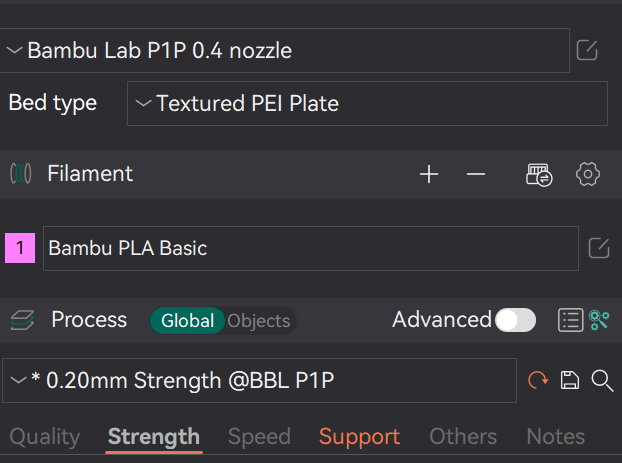

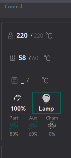

I really can’t tell from the photo but it looks like you’re filament is at the wrong temperature. It’s almost like you’re using PLA settings for an ABS filament.
Can you do a screengrab of the printer status while its printing and the config?

5) Check that correct filament is selected in Bambu Studio and that it matches the filament section on the actual printer.
