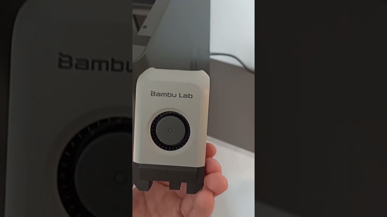

7- Printer LCD screen was black, and printer did not respond on the network, tried Bambu Studio but could never connect to the printer
8- From then on, when powering on the printer, the fan runs for 3 seconds and the motor seems to “skip” I ear the sound and can see its trying to move the strap
Then fan stops and nothing else happen, LCD is black not backlit.
hope someone can help about what component I could look at to troubleshoot this , I should have the printer for some time before I receive the replacement and return the broken one ;
Initial video of the problem:

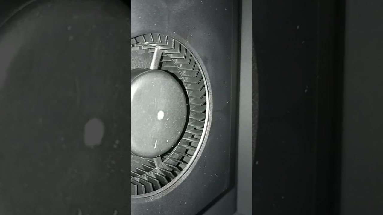

After dismantling and more testing :
Give this a look through as it could be a starting point to narrow down the problem.
https://wiki.bambulab.com/en/p1/troubleshooting/circuit-board-power-failure
thanks @MalcTheOracle I went through the diagnostics described on the wiki page ;
Found out about the AP board indicator light behind the screen is abnormal, not lit green, its not lighting up, other status lights on the back of the printer are normal ;
Normal State: the MC board flashes green once every 5 seconds
Normal State: the TH board indicator light is constantly green
