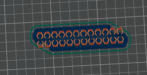

When using Bambu Studio, when I slice certain models created in Fusion 360 the Brim and Skirts are incorrect. This causes problems printing.
Any ideas?

I have no idea what is causing it.
When I have something strange in the slicer the first thing I do is load the model in Prusa Slicer and see what it does.
Was doing same in Orca but noticed an error message on loading file in concerning some of the components not touching the base…on checking the files in Fusion I realised there was a tiny 0.08 mm gap under 4 of the components. Aligned all components to xy axis, problem solved ![]()
