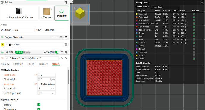

I believe rightly or wrongly that current brim size is controlled indirectly via “Skirt loops,” which for beginners and most user I suspect is unintuitive.
Suggestion: To add a Brim thickness (mm) parameter to the Brim option in Bambu Studio that automatically calculates loop count based on current line width.

Brims and skirts are completely independent.
Skirts are not attached to the model. They are placed around the model (and any brim), with a clear gap. They are used with some printers to establish smooth flow before beginning the first layer. They are generally unnecessary with Bambu printers, which use the “load line” at the front of the plate for this purpose. Increasing skirt height can create a draft shield.
Brims are attached to the model and are not affected by skirt settings. They provide extra surface area, adhering the model to the plate, keeping it from moving during the print, and may help prevent warp. There is no mental math involved; the brim will be the specified width. The brim-object gap is not an actual gap; it offsets the inside line of the brim to reduce squish into the model. Increasing the “gap” can make brim easier to remove. If model warp is causing the brim to break free during the print, reducing the gap may help. Brim thickness in Studio is always a single layer.
Here, the 5 mm brim is blue, the 3 loop skirt is green:
