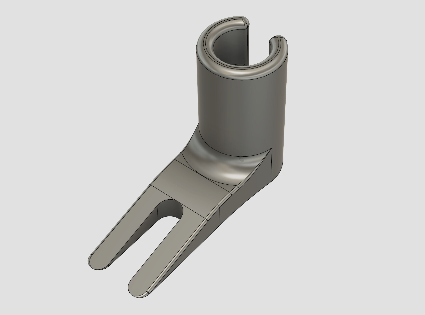

I also found this tool pretty helpful if you have another printer to print it.
There was something wrong with the WIKI, no matter what I put in the search box it just came up with a random page, I have that tool but in another format, it has the bowden release on one end and the AMS plug release on the other, I forgot all about it, thanks, I got the Bowden out and the broken filament, now I cant get the nozzle to go back in, it just wont push up.
