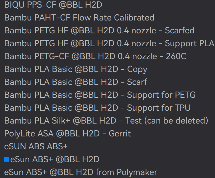

I do not fully agree with you though, because some filament profile settings are directly related to the nozzle size. Volumetric flow of a 0.2mm nozzle is different than that of a 0.8mm one.
But looking at the behavior of Bambu Studio, it seems it has recently changed in this perspective.

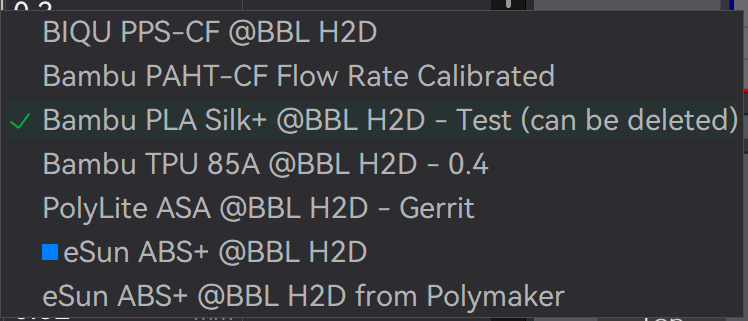

When I look at some older user filament profiles that I changed over half a year ago and to some newer ones, the older ones have the nozzle size captured in the name. I can not recall if I did that myself though.
Switching to a different nozzle size, removes the older filament profiles from my custom list, but newer saved profiles stay in the list.
Here with 0.4mm nozzle:
Here with 0.6mm nozzle:
So you might test if you now save a new user profile from a standard profile, if it survives a diameter switch.

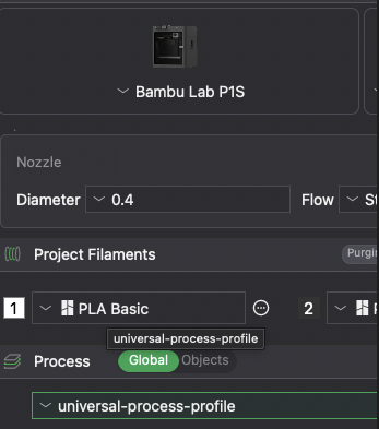

Creating a universal process file
This will create a process file that is compatible with all existing Bambu printers

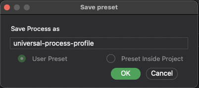

First in Bambu Studio create a custom process profile. I called mine ‘universal-process-profile’ and set the Walls count to 5.
Now navigate to your BambuStudio user process files location.
On mac it’s located here:
cd /Users/<USERNAME>/Library/Application Support/BambuStudio/user/<UNIQUE-USER-ID>/process
I suspect on Windows the location is %appdata%\BambuStudio\user\<UNIQUE-USER-ID>\process I believe you can open Windows Explorer and paste this directory somewhere to jump to it.
My file was called universal-process-profile.json
Open your process json file in your favorite editor and add the following section to the existing json

Save the file and reopen Bambu Studio.

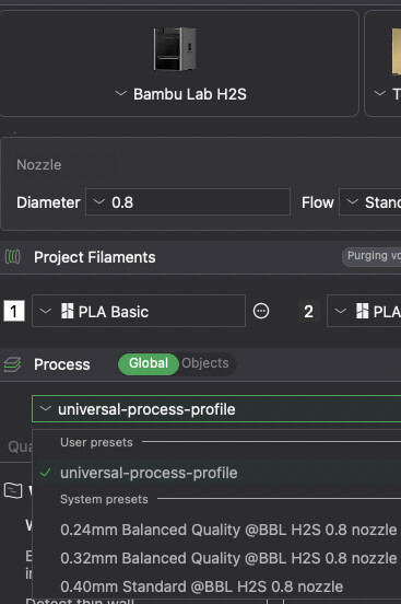

You should now see this profile under all of the printer types and nozzle types
P1S 0.4 nozzle
H2S 0.8 nozzle

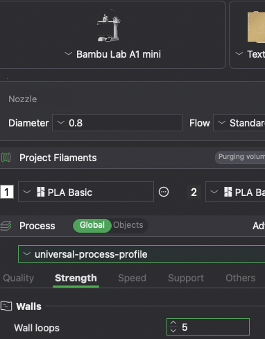

A1 Mini 0.2 nozzle

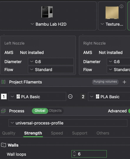

Now if I change the wall loops count to 6 and save this process profile within Bambu Studio for the A1 Mini, then change to a different printer and nozzle…
The new setting is used by all compatible printer+nozzle types:
H2D with 0.6 left nozzle show the new 6 wall setting we saved under A1 mini above.

Quick demonstration using a universal process profile
