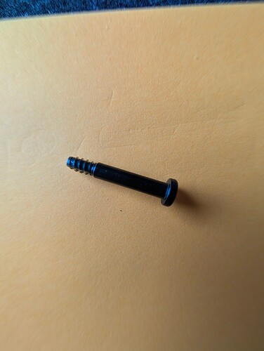

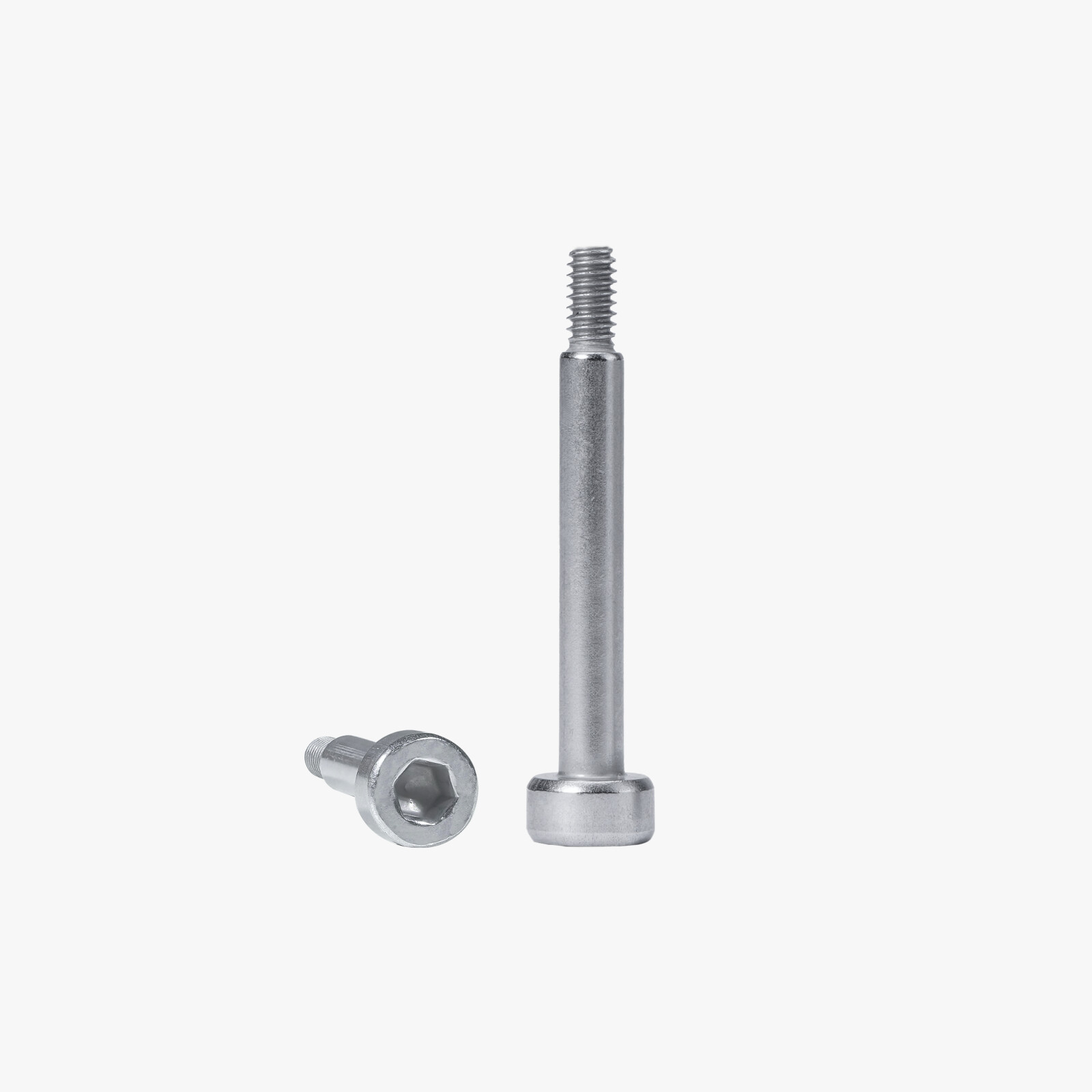

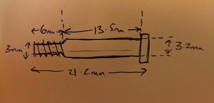

I’ve just measured the ones that came with my H2D Laser for the extraction hood and it looks like the screws are these ones from Bambu M3x4x14 (AA210). Although the thread itself is more like a wood screw on the ones I have so maybe not?
I know you mentioned about shipping etc but it wasn’t clear to me the exact screws needed.
Does anyone know how to source more of these? I have printed some hoods for my other H2D printers (non-lasers) and need to fasten them.
“In the bag with the clamp” life saver! Thank you!
Unfortunately the H2S doesn’t come with them if it’s not the laser version - trying to get confirmation of the size myself without removing the ones from my H2D!

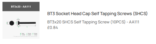

Sorry for the late reply! The screws I ended up using were the BT3x20 Socket Head Cap Self Tapping Screws (SHCS) 10PCS. Model: B-AA111
