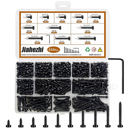

I bought something like this off Amazon and it actually ended up being a bit loose; it bottoms out before the heads seat in the exhaust adapter.
Then I bought some 3x15 ones and they’re too short… :joy: :sob:
Ack, the adapter I used must just have used the right length for those screws and I got lucky! Junior hacksaw the ends of the threads off, job done. :stuck_out_tongue:
Circling back for Japan, in case anyone else stumbles across this thread: I used these M3 x 18 ones and they fit perfectly.

Here’s what I ordered because they are useful for plastic so, lots of sizes.
I know the thread has gone a long way to figuring this out, but I figured since I needed a longer set for the fan duct - I would share what I found.
