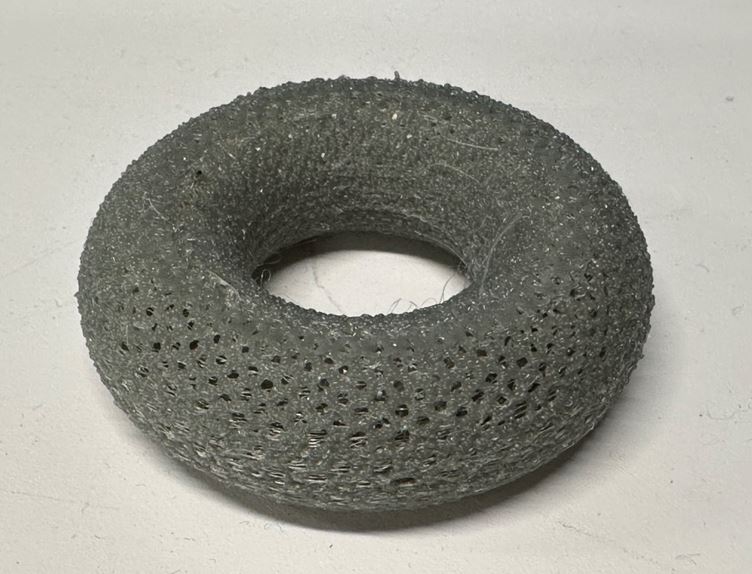

For TPU in AMS, I use the stock settings for the object when printing on a Textured PEI plate. However, when using a Carbon Fiber Plate, I increase both the bed and nozzle temperatures slightly and apply glue as a release agent.
The donut I printed (previous post) uses this profile.
Lattice Donut TPU.3mf (3.7 MB)
Original model is this Voronoi Lattice Torus by FluffyCAT - MakerWorld

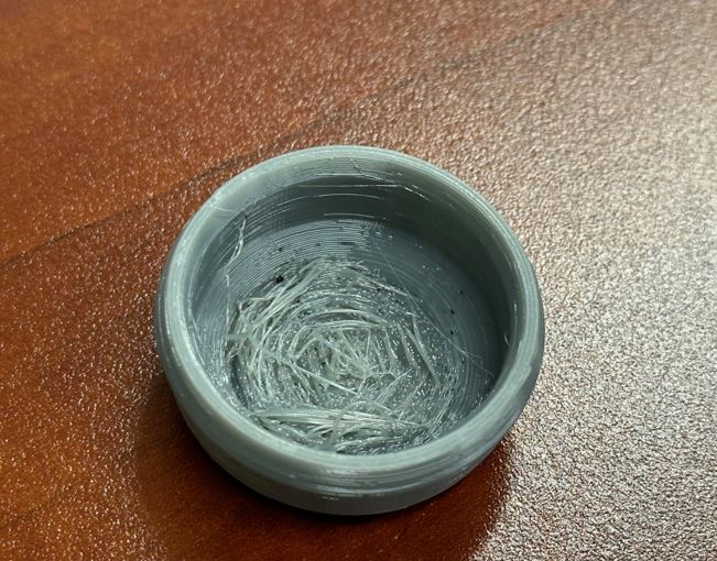

This is how it looks with the profile, would need support. I use random seams so that to can be changed. I think you have a good start here.
Maybe a circular pattern + support and not random seams will do the trick. My settings are set for good support with TPU 95A HF, just activate normal support instead of tree.
Thanks for doing a test print. The results look a bit better than what I ran. I’ll try to tweak a couple of things to see if that improves any.
Speed and temperature are the key factors for successfully printing with any type of TPU.

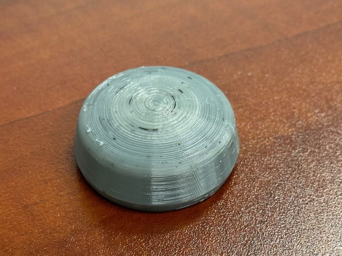

Here is the part that I made with your file. The only thing I changed was the resolution. I ran it at 0.08mm resolution.
The print looks quite goodĆ¢ā‚¬ā€there’s some minor stringing, but overall the results are solid.
I store my TPU in a heated dry box between prints to ensure it remains in optimal condition.

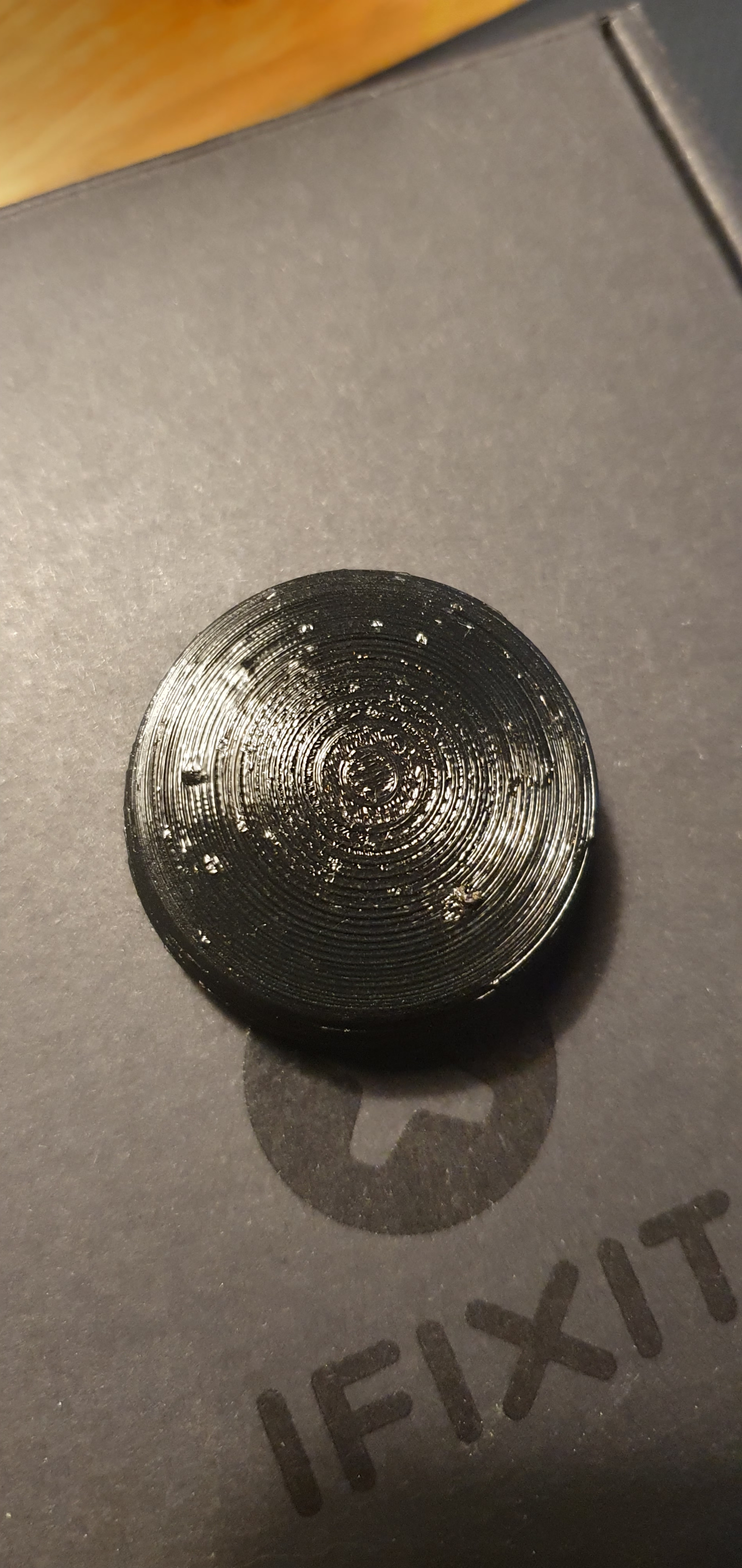

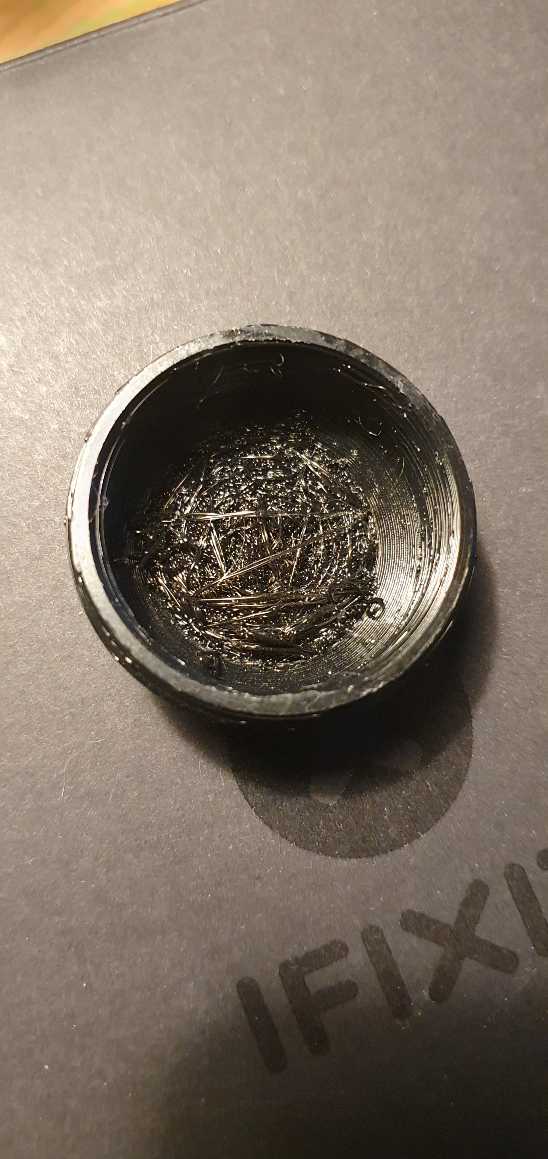

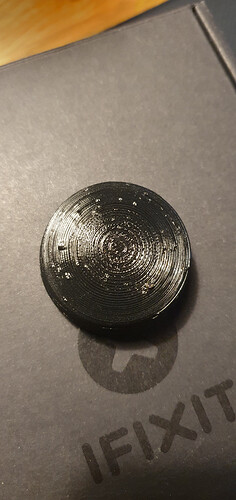

Attached are images of the cap part ran with your settings. For the most part, I kept the same settings you had. Outer surfaces look much better. I did set to run with supports (tree auto), but it didn’t build with any. The inner surface had some issues, but still usable. I could probably re-run with normal supports and eliminate the ā€œbird nestā€ on the inside but not that critical for this part. Changing to concentric patterns seemed to help a lot along with increasing the top shell layers. Thanks for the input and suggestions!
You could try using normal support; at least in the slicer, it provides full support for the cap. I haven’t tested this myself, but I believe it would be a worthwhile experiment.
Yes I think the normal support would be better. Might try that, but suspect that it will work out better.
