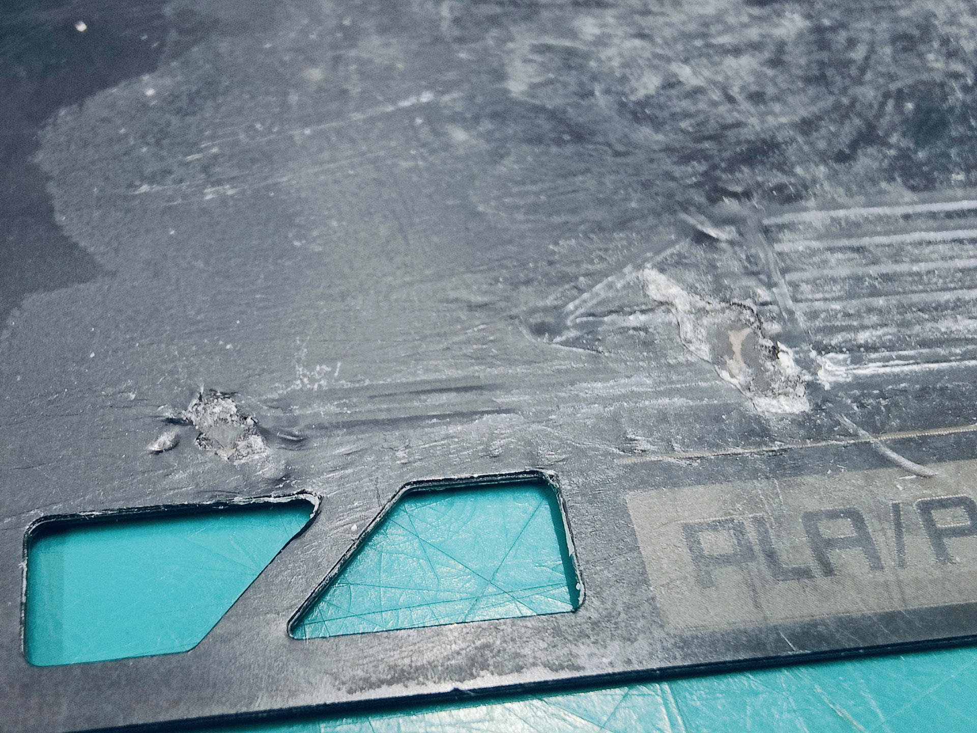

Just wondering if anyone know what causes the damage to the build plat in the image below. We have had the X1E for over a year now, never had any problem with it digging into the bed but over the years found these two hole opening up. They are on the start of the flow calibration, the printer print fine even with these, so I’m 99% sure I can rule out any mechanical problem or calibration to the Z axis. I’m asking as I’m about to go get two engineering plates, would like to understand what causes it and if it something we can stop or if it just because the PEI coating is burning away or something like that.
It seem your build plate has been used for a long time. The coating has blisrered, which is causing friction or collision with the nozzle.

Plates are consumables, and yours appears to have had a lot of use.

Blistering dose sounds like a good shout especially given how long we have used this bed. First PEI bed I’ve used and had never see this type of issue before. It is possible the damage has happen when a co-worker was using it and hasn’t said anything.
PETG adheres extremely well to smooth print plates. I once ruined one completely by accident. You always have to wait until it has cooled down completely, or even put it in the refrigerator. It’s understandable that the plate will look like this after many hours / a year of use. That’s normal wear and tear.
In particular: All it takes is for someone to forget to wait until it cools down and pull on it, and the plate will sustain minor damage that gets worse over the months.

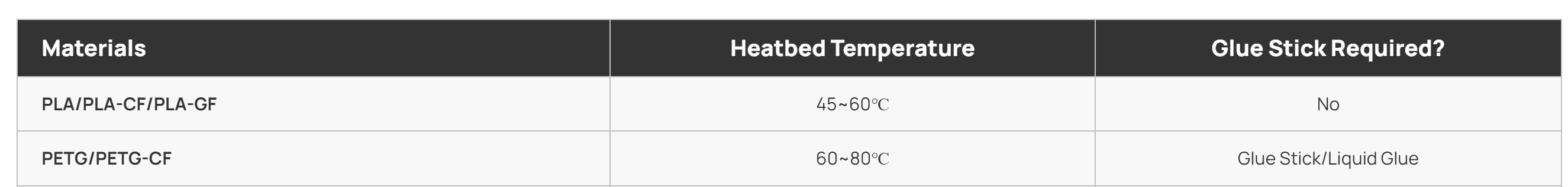

I did notice a couple of things while looking into this, I’ve never used this filament so I don’t have personal experience with it, but the filament TDS recommends printing with bed temp of 80 degrees. The Bambu spec for printing higher-end PETG on the engineering plate is 60-80 degrees. Both companies recommend glue. I’m not sure what or if the higher temp will effect how you print, but it could be something you look into.
In my experience the Textured PEI are damn near immortal, and if the nozzle crashes into it and scrapes some speckles off, it still actually works fine just with a scar
The smooth type PEI / effects plates I find to show wear from repeated prints. Eventually the wear lines delaminate and then pull up, get sliced open by the nozzle and then its all ogre. With the calibration lines you’re kinda stuck due to firmware, but you can randomize the placement on the bed to keep yourself from printing the same thing 100 times on the same place in a row and destroy it.

Thank for the reply’s, like a lot of you have said I think its just ware from always doing the calibration in the same spot and that the answer is a new build plate.
