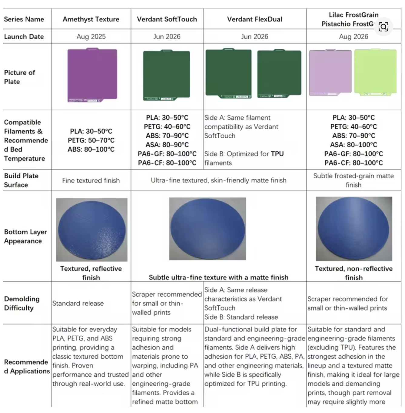

The Kdeavi green plate (sold as CryoClover). Sadly I bought this last. This plate is awesome and now my standard build plate. I will probably buy a second one. I heard somewhere that Kdeavi are the oem of the od cryogrip frostbite plates (dont know if true). They also have a purple one, but advertise this one as having better adhesion, matte surface and compatible with more filaments. PLA, PETG, ABS, Nylon, PC just… sticks. For PLA and PETG i use normal bambu coolplate settings, for the rests high-temp/smooth PEI. No glue, no brims, no faffing around. just print. After the plate has cooled down prints usually are easy enough to remove. Some persuasion with a spatula may be required for smaller parts (not a problem if you’re careful). Texture is similar to the glacier (nice satin matte). Just never print TPU (apparrently some ABS blends contain TPU!), on it.

just to make sure I get it right: The green one is the matte one? :wink:
I will head out, trying your recommendation right today :wink:
thats a table from the supplier. I have the “verdant softtouch” - but they call it “cryoclover” on aliexpress… no clue why. There is an even newer version (and apparrently even better…), but its not available for the h2d.
Great, thank you very much! :slightly_smiling_face:
