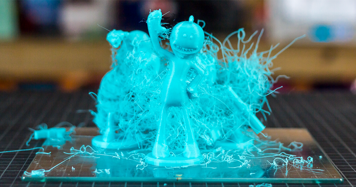

Hi guys,
I am using Verbatim bvoh as support and have major issues with warping and spagetti. Any advice here?
Noozle = 0.6
Bed temp: 60
Noozle Temp = 200 cels.
Textured Plate

Spaghetti is generally caused by poor layer adhesion. There can be many reasons.

Okay I learned some things and found a solution
  1. BVOH should not be used in the first layer. So choose as “base” for the support PLA or something else and BVOH only as support interface
  2. BVOH should not get in contact with the bed in the first layer, as it has very bad adhesion on the bed
  3. BVOH is used best, when the first layer is already printed and BVOH is printed on top of PLA. Then you should not have any issues.
BVOH on top of PLA = Fine
BVOH on the bed or as starting print = big mistake and should always be avoided. You will 100% get warping and spagetti.
