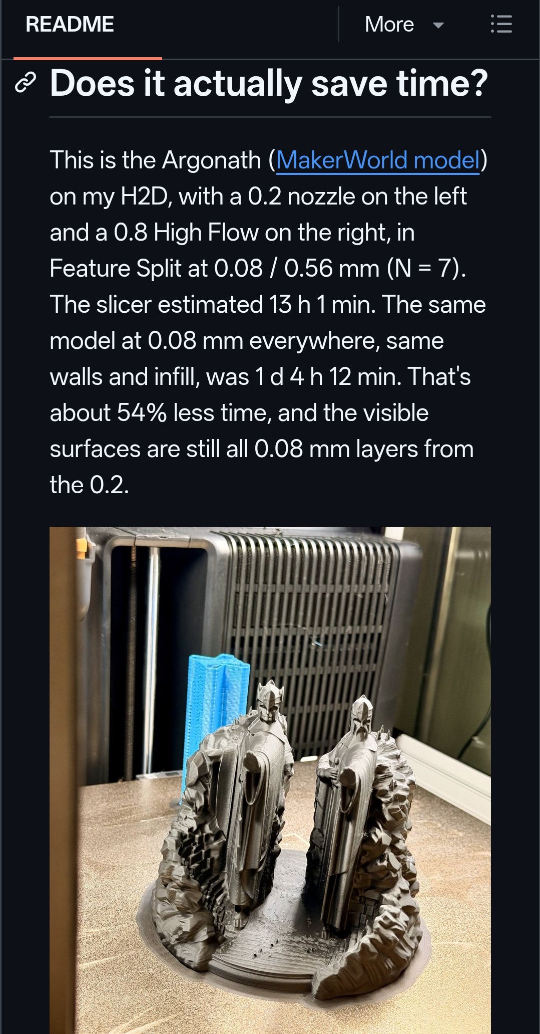

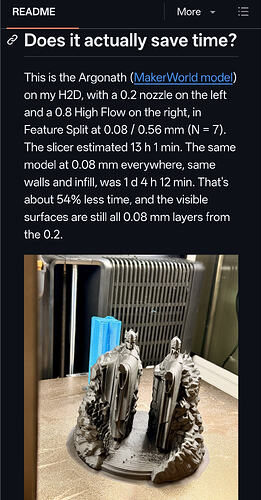

I tried to make it work with BambuConnect but on macOS it does not recognize the print slice file (works fine with Orca). I will try to print direct from USB and see how that goes.
Ive tested it and it work for some things but not others. It woks for large object with 0.2 exterior and 0.8/0.6/0.4 infill. It also works for fine text on a model. Unfortunately it does not work for multi-color models like business cards or clock faces etc. It was designed for dual color/material in mind.
