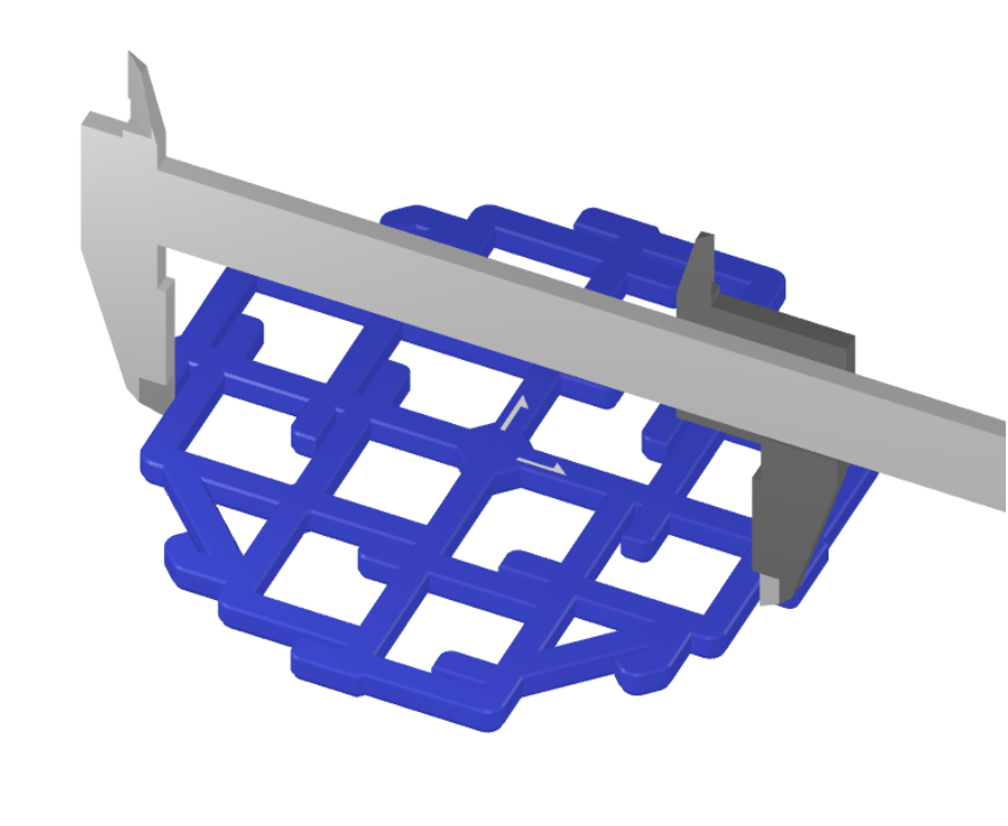

I use this for the Skew and the filament shrinkage works amazing and easy to use
Use this
Have you tried calibrating each filament for shrink?
