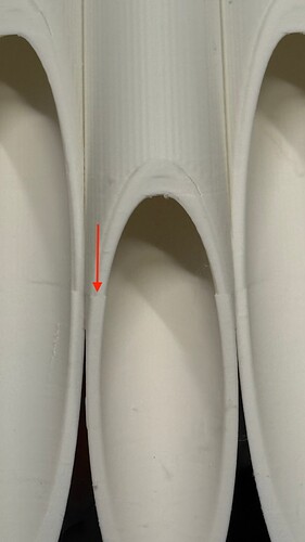

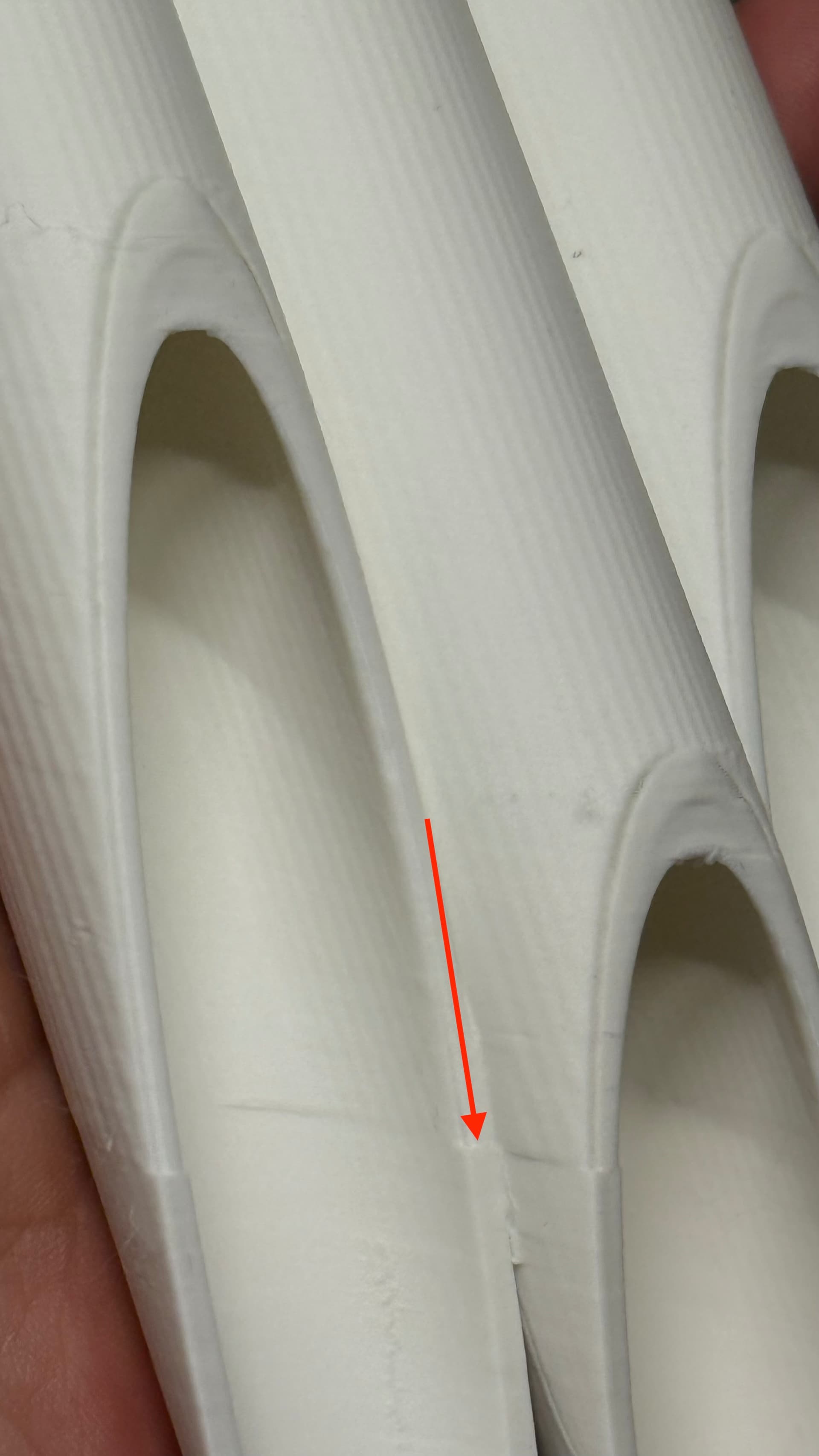

So I routinely run two of the same spool type for large jobs over 1kg, this creates a problem: sometimes the AMS switchover results in a cooling and shrinking, but the most common issue is the flow calibration for the initial spool can be too different from the k value for the 2nd spool.
How do I know? after running several dozen of the same job, which requires two spools each, if I use default values and disable flow dynamics calibration (pressure advance) or if I let it calibrate the first one, the layers printed with the second spool results in a different look to it’s corners. Trust I ran the gamut of checks on FIVE X1Cs, adjusting belts, lube, squareness, etc. what fixed it was flow dynamics calibration - but for each spool before printing.

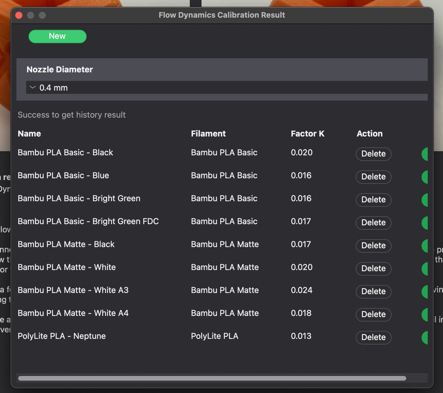

  1. I would love to be able to run Flow Dynamics (Pressure Advance) Calibration from the printer and store it to a spool setting on the AMS not just on the first spool at the beginning of a job, but manually on some or all spools in the AMS and have it store the values to the AMS settings - like Bambu Studio can in it’s Calibration Page. I can imagine a menu function to perform this but it’s likely a bridge too far for the firmware to handle this.
  2. Keeping track of K-value results is getting disorganized. I have to occasionally go into the calibration page, Manage Result, and delete the duplicates I named differently. It’s left me having to name them like “Bambu PLA Matte - White X1C1 A1 7-31” “…A2…” etc. it gets exhausting, but is the only way to keep track of spools each time I print. I’ve considered labeling the profile by the K-Value in the hopes of making essentially a static library per printer I can re-use, but then I need to label the spools physically as well, e.g. dry erase marker or print labels on my thermal printer - this might be a future method of keeping this organized, and maybe running it once per spool when I finish drying them. Problem is I’m lazy and this is a lot of extra work lol.

Here’s an image to show an extreme of what can happen when the K-value is drastically different from one spool to another of the same filament:

I skip the auto-calibration at the start of a print and instead perform pressure advance and flow rate calibrations per spool in advance. I then store those values manually under uniquely named profiles. I’ve learned that the pressure advance (K-value) can vary significantly — particularly between batches or after drying- even within the same filament type, brand, and colour.
To manage this, I do the following:
  • Maintain labelled profiles in Bambu Studio with tags like “PLA Basic - White v1”, “v2”, etc., even if the official name and colour are identical.
  • Use a label maker to tag physical spools accordingly so I can match them with their calibration profiles.
  • Run short test prints using both spools before starting any job requiring a switchover — this helps confirm calibration accuracy and detects issues like moisture in advance.
I also back up the calibration database regularly. I’m refining an OCR-based script to extract K-values from Bambu Studio screenshots for archival purposes. Still, I also access the remaining data directly via the filament .json profiles, which makes batch parsing and backup easier.
