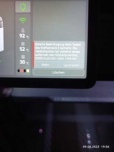

Hello, I can only calibrate the cool plate with the high temperature plate and I get this error message with the Pei plate.
I can calibrate all plates as Coolplate but not this specific one. Can you help me?

I can only print with the Cool Plate. The high temperature and the Pei plate bring these calibration errors before printing. In the second row of scanning. An extra calibration works with all plates. The plates are new.
But if I select the cool plate and switch off the plate recognition, the calibration works with all plates even before printing.

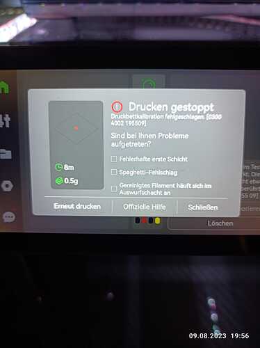

I can print anything with the cold plate. But if I want to use the high temperature or the Pei plate, I get this error message during the print bed calibration, which is carried out before printing. Calibration and self-test of the printer works ok. I use Bambulab Matte PLA

The error does not come with the lidar measurement but when scanning the bed with the nozzle. If I select the PEI plate in the Bambu Studio, it switches the lidar measurement off.

  1. The HMS info alerts about detecting an external disturbance during the force sensor testing, correct?
  2. According to the official troubleshooting (ttps://wiki.bambulab.com/en/x1/troubleshooting/hmscode/0300_0A00_0001_0004), the issue is related to stuck z-axis, excessive vibrations, unstable position or faulty cable.
  3. According to your description, it occurs during the measuring of the force sensor sensitivity when it starts vibrating (correct?); which indicates excessive vibration from the surrounding;

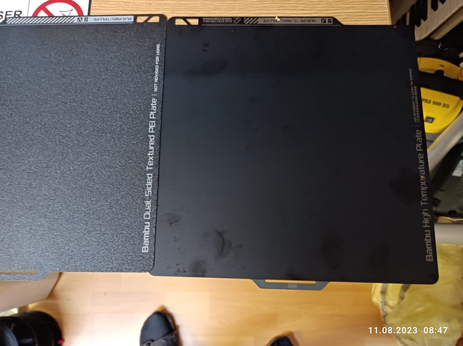

  4. What is confusing is the occurrence depending on the plate type. Looking at your plates, except for the unclean high temperature, they are in mint condition.

EDIT: remember one difference with bed plates, the temperature. A time ago, a user was referring to the degradation of the force sensors’ performance at higher temperatures. But it wasn’t a new printer.
