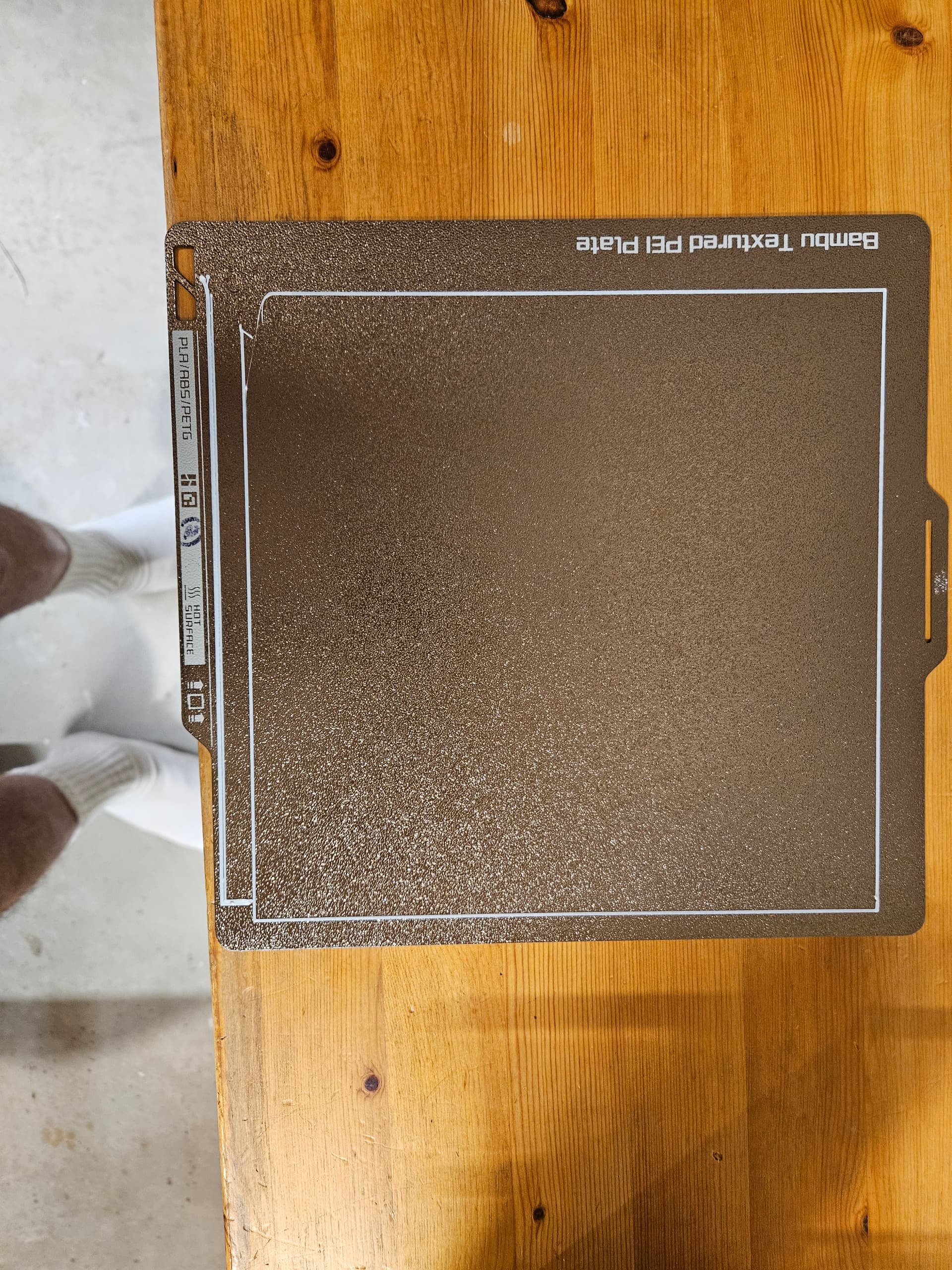

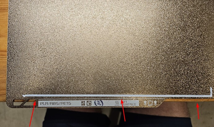

BUT, see attached, the initial nozzle filament purge line, is off slightly. it may ALWAYS have been off, and i never noticed it, but heres the photo
left red arrow, 2.83 mm distance between edge of filament, and white line.
Middle red arrow, 2.22 mm from edge of filament, and white line
right red arrow, 1.87 mm from edge of filament to edge of print plate
is this a problem, should it be totally straight, and if so, what to do to correct it?
also, is there any calibration print that can verify that the printer is printing accurately, even if this line discrepancy remains?
any feedback appreciated, thanks
Check to see if your nozzle is bent. That is the most common result of a crash.
The purge line is normally straight on my machines. You may have moved the bed slightly. There are screws that you can loosen and will give you slight adjustment for the position.

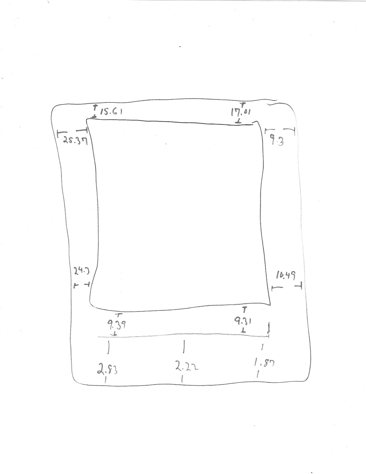

first two issues, a giant square, printed on bed.
it is square, it just seems rotated by about 1 mm on the plate. it is parallel to the crooked purge line also.

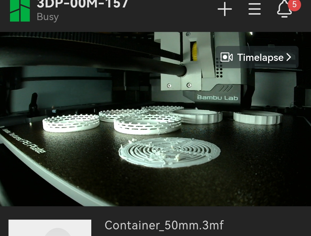

AND, third image, printing som e silica jars, they are printing very well, (orhter than one lid, which i have SKIPPED printing)
so i am going to just observe for any oddball stuff, but right now let well enough alone
i’m afraid that if i try to adjust the print plate bed, that i will do worse than currently a 1 mm difference over the 220 +/- mm of length of the square.
