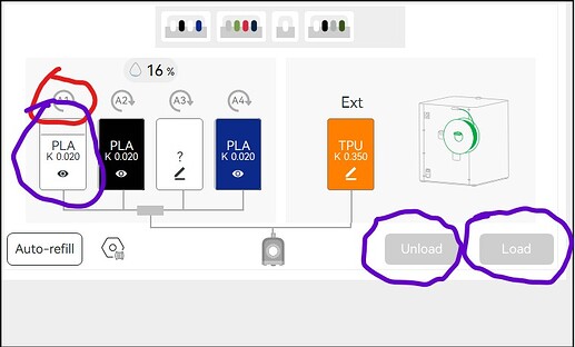

What happens when you use Bambu Handy or Studio to feed filament to the toolhead
If you click on the RED circled icon it will cause your AMS to go through the RFID Read process.
If you click one of the slots circled in blue it should illuminate the LOAD & UNLOAD buttons. Maybe try running through those evolutions. LOAD should run filament all the way to the toolhead and if you have a darker filament to choose from you should be able to see filament from when it exits AMS all the way to the toolhead.
It doesnt feed into the printer at all, as in, it doesnt even go down into the filament buffer or anything. I can see the filament in the tubes clearly, it’s simply not there.
