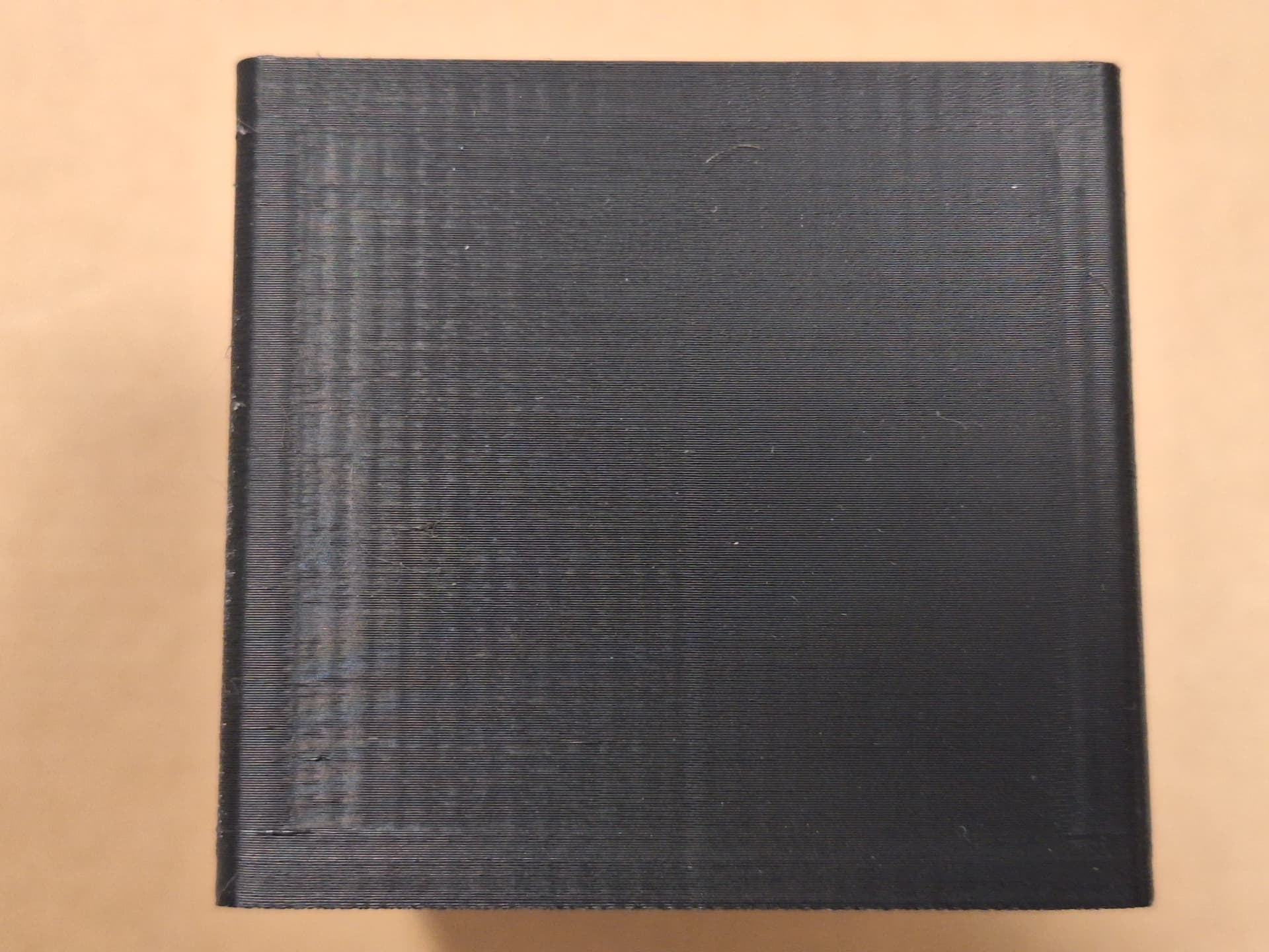

I am fairly new to 3D printing and I have this weird error on my print, but only in a single section.
Context:
I am trying to print a container/airtank for a device that I am testing. The material is PETG and I have already experimented with different printer settings, and found the following to be working relatively well.
It is worth noting that I have had a successful attempts, that only needed some minor touch-ups with a soldering iron.
The problem:

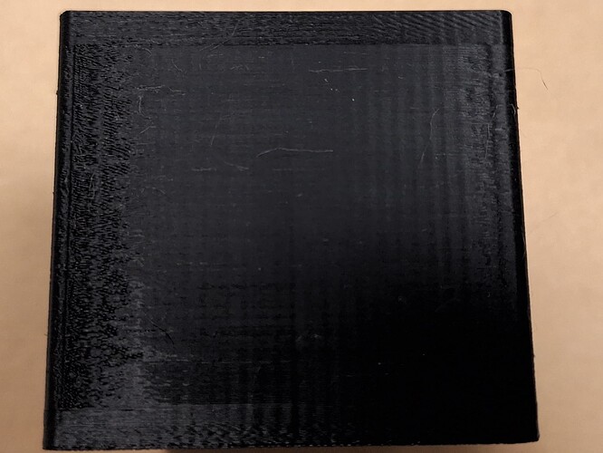

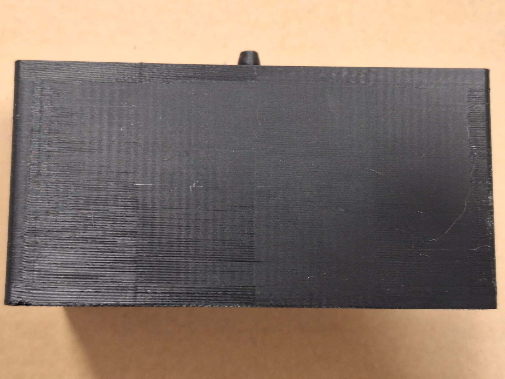

In my last couple of print I encountered this error that I couldn’t find anywhere else. On one side of the print on the left is this uneven layer problem and when testing this, by puting it under water, bubbles start to form on that part.
The thing I can’t wrap my head around is that the other sides seem to be fine.
The print error is near the scarf seam, and also there is retraction too.
My theories:
  • Damp filament: This print is printed form a freshly opened filament spool. However then why only is that part of the print affected?
  • Vibration: On this forum I read about vibration (Vibration issues on the x axis - #6 by georgioalexie), it may not be the case, but as I said I am new and at a loss
  • Nozzle grinding
I have tried cleaning the nozzle, and it did help a bit but the problem is still present.
Any help would be appreciated, and I apologize for the post for a bit being messy.
PETG is notorious for holding moisture. Even if it has been sealed and you’re putting on a fresh roll, it is recommended that you dry it first. I would personally try to dry it before looking elsewhere. Eliminate the obvious causes that can be easily resolved.
Yes. It’s a common mistake to assume new unopened filament is dry. It might be, but it could just as easily not be. The packaging is not hermetic. The desiccant they ship with comes in an opaque package so you can’t tell how “moist” it might be. But there is a point where the desiccant can’t absorb anything more. So depending on how long the filament sat on a warehouse shelf, and the temperature and humidity during storage, it might be very wet.
Especially PETG, which is very hydrophilic (not as bad as Nylon, though).
Asymmetries in the print happen because the printer isn’t extruding continuously, it starts and stops as the print head moves, so defects tend to accumulate in the same areas of the print. And there is also cooling. The printer’s aux fan blows from one side only. If you’re running it, it makes the left side conditions different from the right side.

The patern is still present. However the print turned out better, it is still leaking, but it was reduced to 1/10 of its former value so I can work with that. I ran an auto calibration before the print in the post, I will looking into bed leveling.
