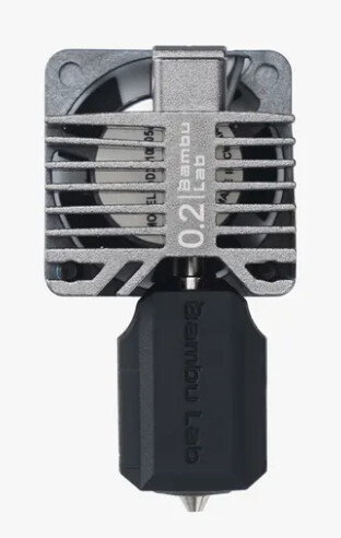

But I really want to disassemble as least as possible. I thought I could once upon a time buy the complete nozzle and fan and wires so that I can just unplug the 0.4mm and just plug in the 0.2mm and away I go.

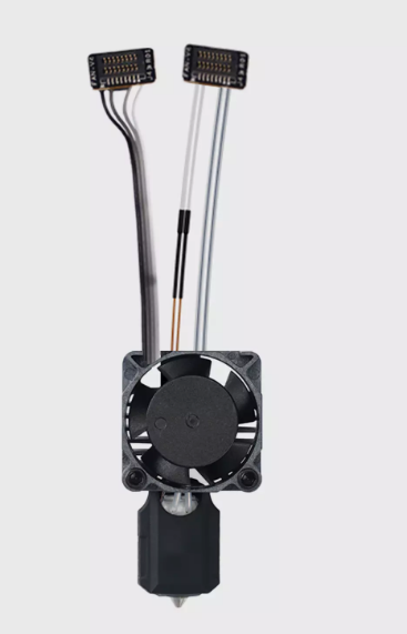

Like the below?
Does BambuLab sell this complete put together ready to go? or do I need to buy the components separately and put it together?
Thanks!
Bambu sells both versions. You can save some money by doing the easy assembly yourself (adding a pack of heater cartridges, thermocouples and maybe a fan or two) but for convenience, selecting the “complete hotend” type will get you a pre-assembled one.
Note the price difference though.

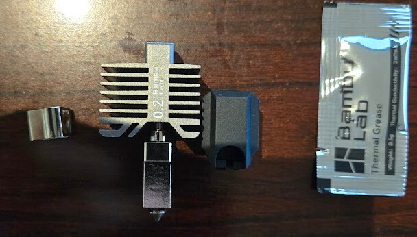

To be fair, I do already have the following in my drawer:
So i just need to get the following is that correct?

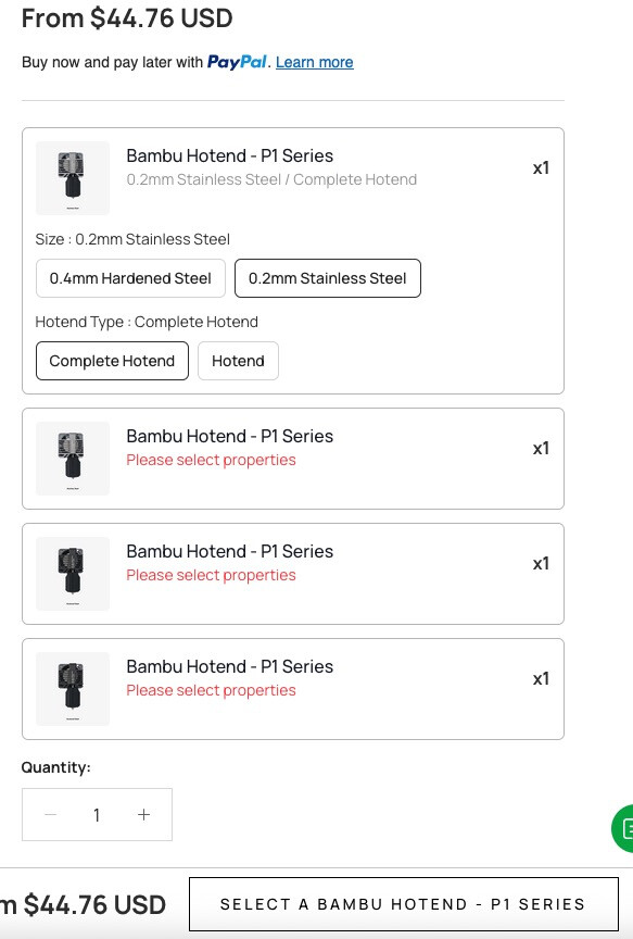

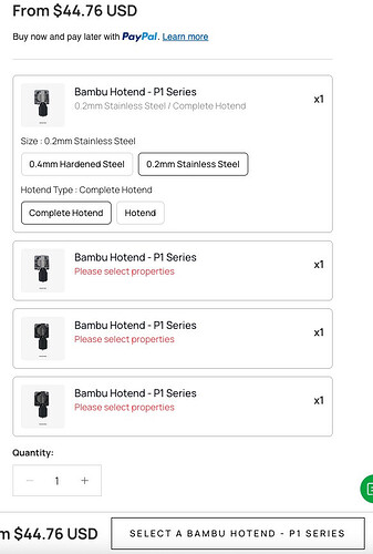

They do sell the complete hotend, but it appears their site is broken. I just tried to add one to my cart and no matter what I do it says to “SELECT A BAMBU HOTEND - P1 SERIES”. It won’t let me add it to my cart?
Edit to add linkaroo: All-in-one Hotends Kit | Bambu Lab US Store
Yeah thats what I found as well (on the AUS site anyway), which made me think I was not buying what I needed to?
Yes, indeed you need the heater, thermocouples and fan.
I have just switched to the US store and I could order the complete hotend from there. Your issue seems to be related to the ongoing sale.
The complete hotend is not discounted so you may need to get to it through the normal shop page:
And the same for Aus:

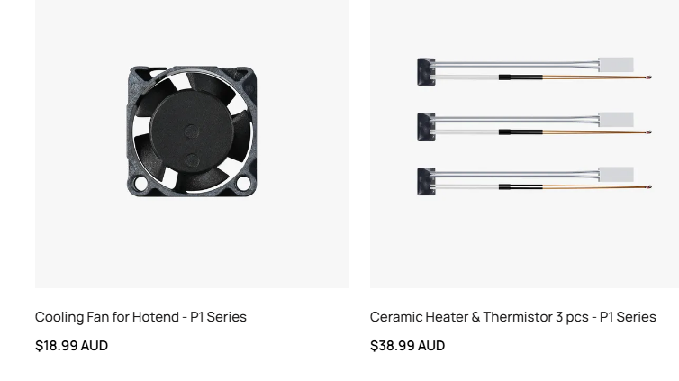

may as well get the complete hotend, even though I already have the nozzle!
From what I could see
Option 1 - get the fan ($18.99) plus the ceramic heater & thermistor ($38.99) for a total of $57.98
Option 2 - total hotend assembled for $56.99!
I dont think I am missing something - is there a benefit to option 1 (extra parts etc)?
That’s because you are on the bundle page, it wants you to select more than 1 Nozzle/Hotend combination. Unless you select all 4 you can’t proceed, you need to go to the store page that’s for the single hotend.
Only 2 more heater & thermistor as extras.
Well, as mentioned, option one gives you extra heater/thermocouples and the fan is not really something that breaks so often. So yes, there is a saving.
Especially since only option 1 is currently in a sale. When I ordered spares for my X1, discounts applied to a mix of nozzles so yes, you can currently safe a lot and stock up on spares as well as getting the .2

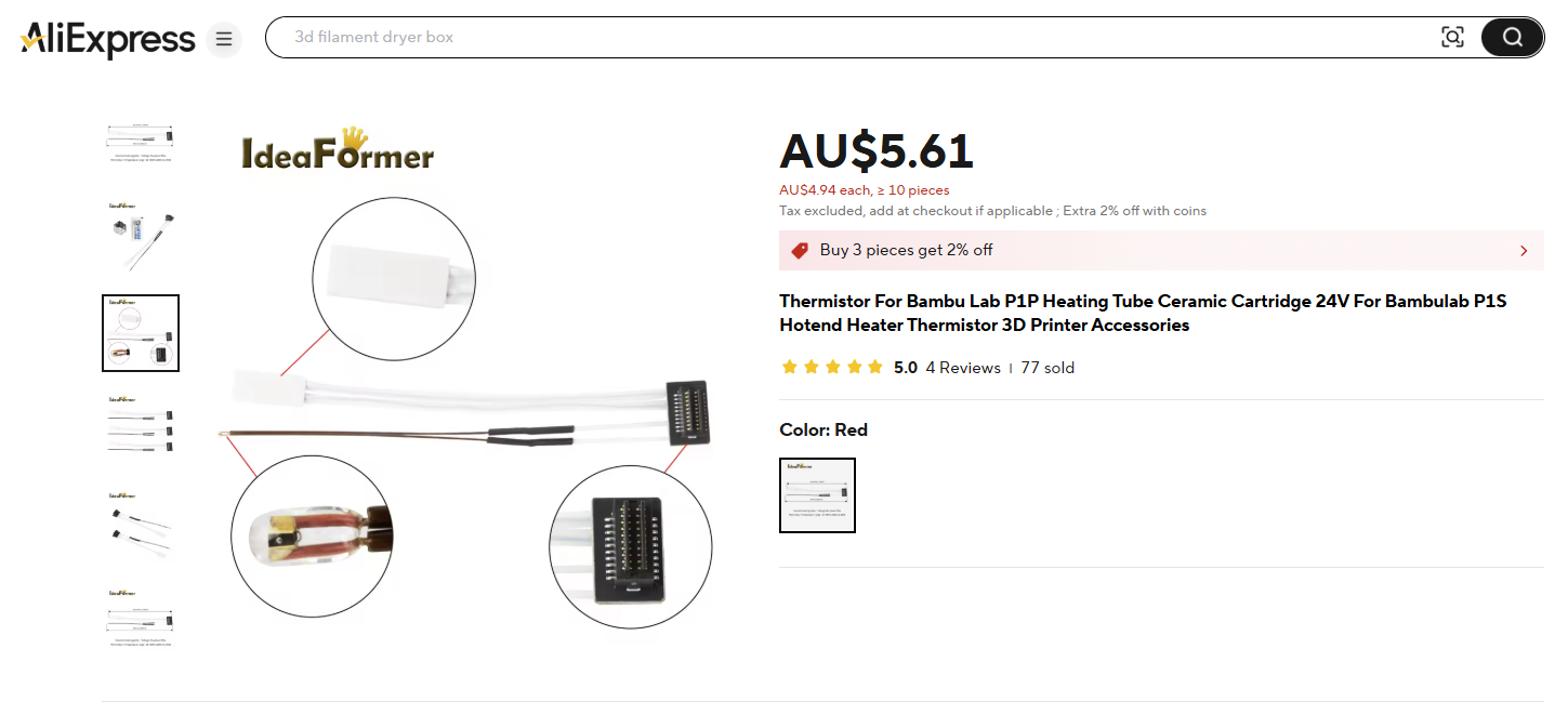

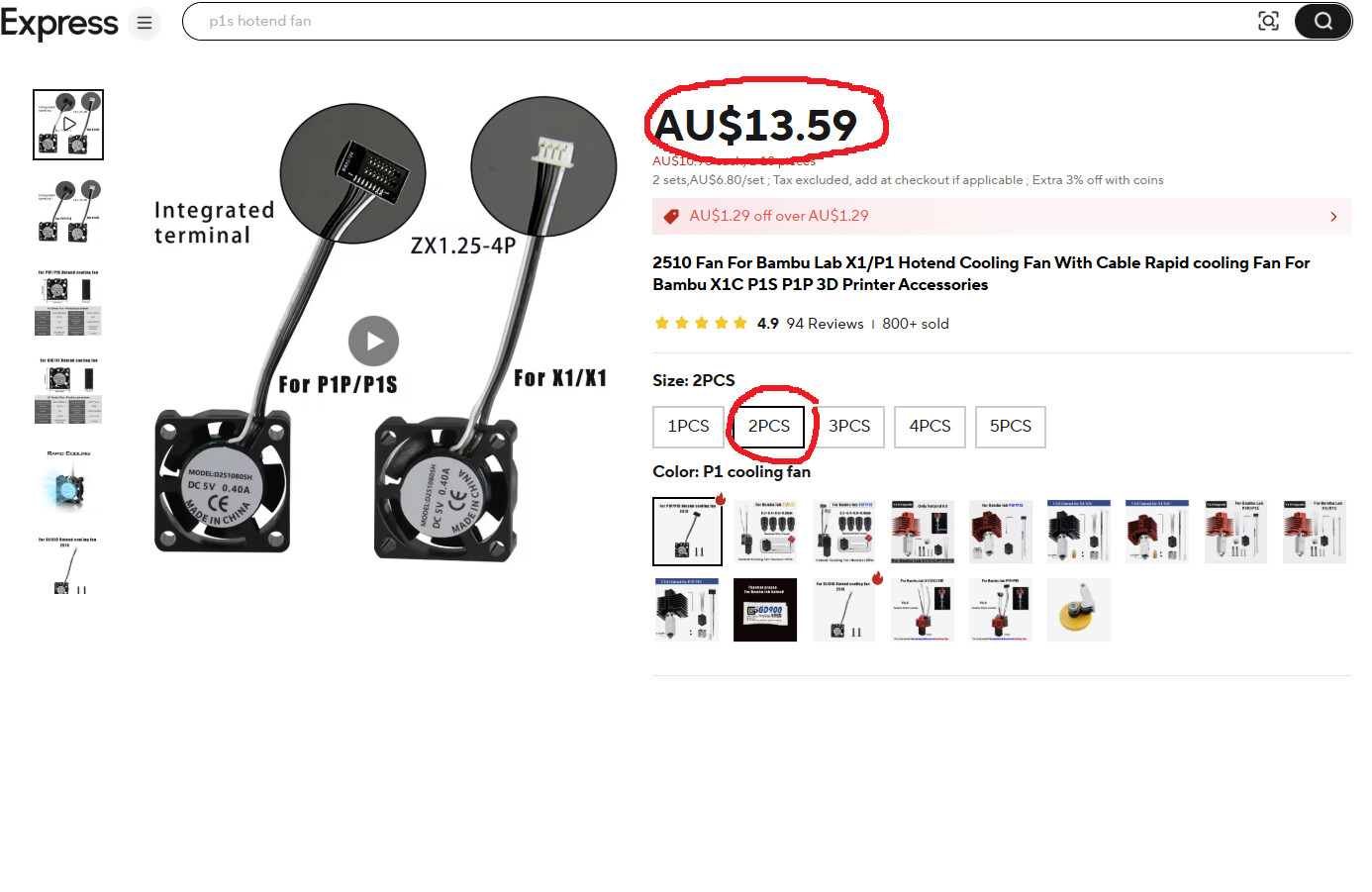

I’ve been using Aliexpress 3rd party parts for months.
FYI, it’s just a simple thermistor and a piece of platinum wire inside ceramic packing. Same same for a simple cheap sleeve bearing fan.
