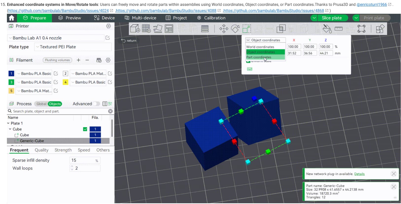

Starting in 1.10, when I click the rotation on a part (or group of parts) I am only able to see the relative rotation. I see no mention of this change in the release notes.
I do not like this at all, because it’s basically always zero and therefore provides no useful information. I double-checked that Orca Slicer does show the absolute rotation (from the imported orientation), which is also what Bambu 1.9 showed.
Is there a setting somewhere that I can change this back to the Bambu 1.9 and Orca behavior?

There is a new dropdown that changes the default I believe.

There are coordinate options for Move and Scale, but not for Rotation.
I think this is a bug so I submitted it on Github.

### How to reproduce
Add primitive cube to a new project.
Select and rotate the cube.
### Actual results
Relative coordinates are always used.
Coordinates are always zero.
World coordinates cannot be selected.
Actual amount of rotation is unknown.
### Expected results
Allow the use of world coordinates so that the actual amount of rotation can be seen.

Response to bug report on Github :
Hello, we will add the actual Euler angle function back for the convenience of every user~
