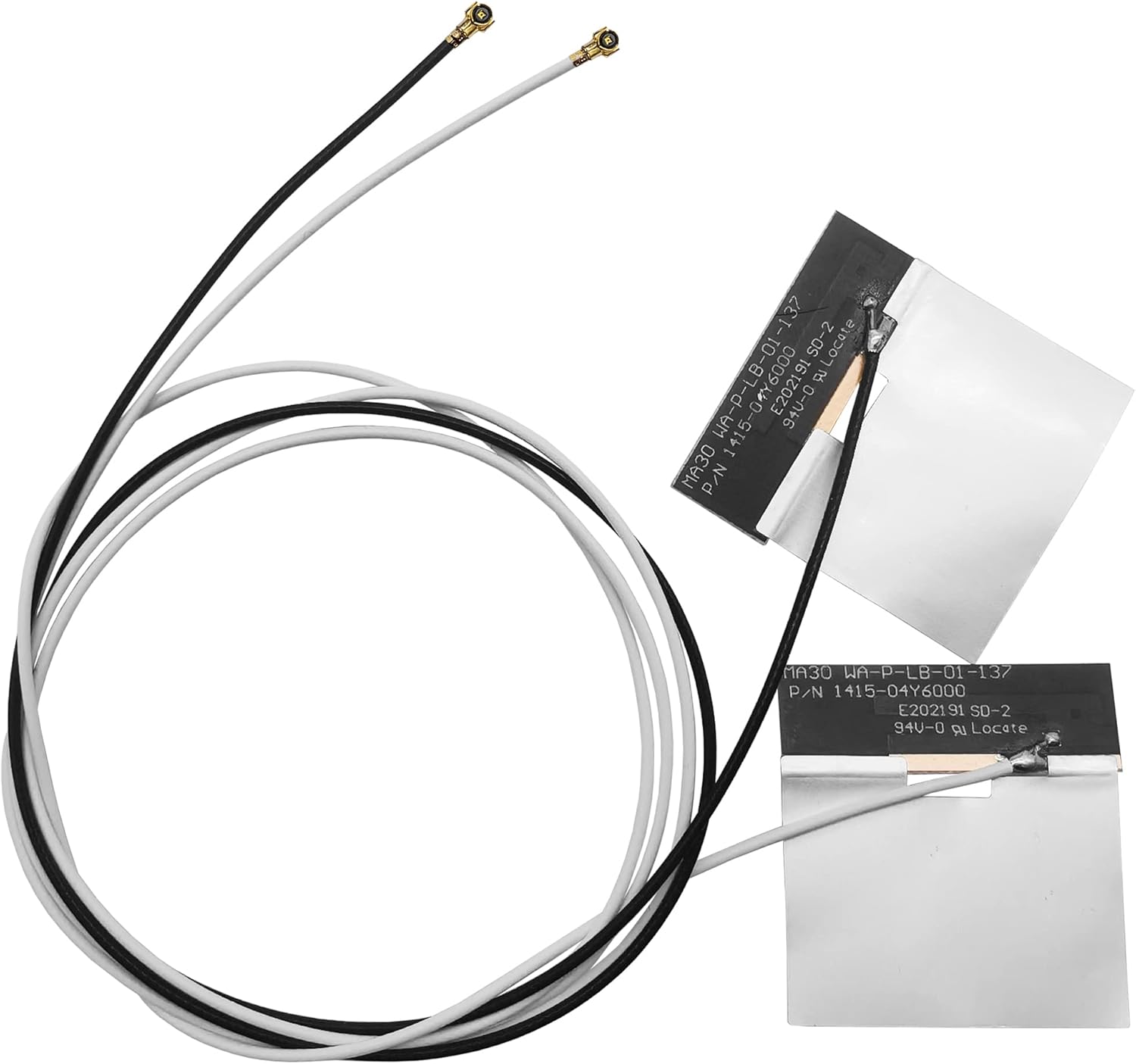

Is there any way to improve the WIFI?
Can the antenna be changed or moved?
Kudos for going through the troubleshooting steps you already did.
To answer one of your questions, yes, it is possible to swap out the antenna and not really that hard. Any I-PEX MHF 4connector antenna will work.
https://store.bambulab.com/products/wifi-antenna-p1-series
They can be readily had off of Amazon or Ali express, here’s the search term.
https://www.amazon.com/s?k=wifi+antenna+IPEX+MHF4
Here’s one example, it will cost you less than $10 to find out but you can always return it.
