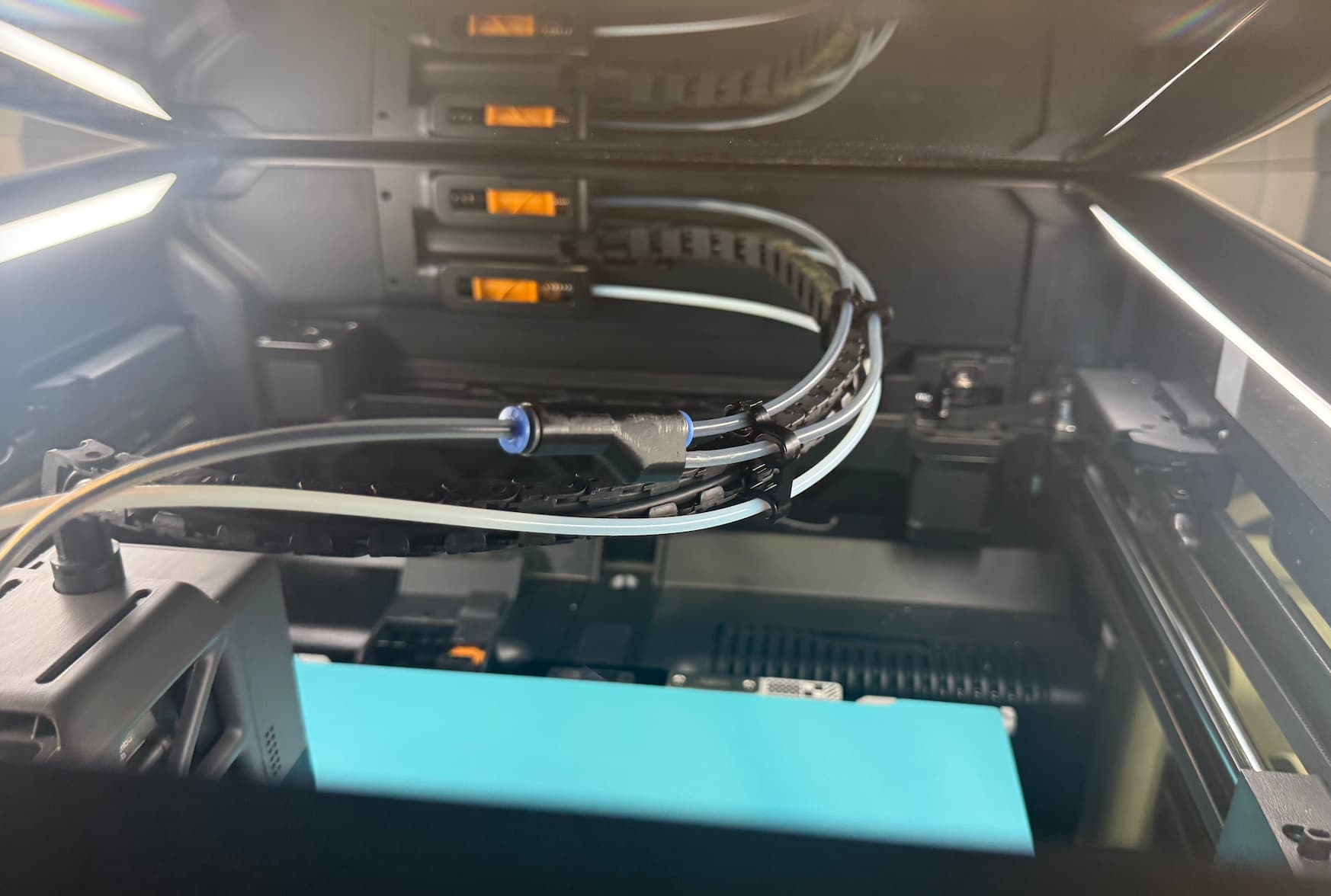

I print a lot of 95A and i use the 0.4 HF nozzle with no problems. Also I dont do anything if the last material I printed in the right hot end is PLA or PETG. If it was a high temp material like nylon I flush the hot end with a short strand of cleaning filament. To speed things up with TPU I have a splitter inside and a dual feed outside to have the TPU tube always connected and ready to go.
Nice setup! Ah good to know HF works fine, then a can stop changing nozzle
I’ll do the Y split too!
