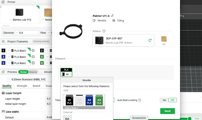

; I have loaded PETG HF into my AMS Pro2 attached to my P1S. Bambu studio sees the correct filament in the correct position, however when I come to print the icon is “greyed out”. I cannot send to the printer. I changed the position of the PETG hf roll and again the software and printer detected the correct filament in the correct position… but again after slicing the model the tab of the correct filament is not highlighted and you cannot “send”. Can you help please

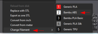

Just because you have loaded the filament doesn’t mean it’s selected. Right click the model, go to the “change filament” tab and select the petg hf.
Make sure that it also is present in the filament selection on the left side of the slicer menu
When slicing your model, you more than likely have PLA selected, which will gray out any other material types.
You’ll need to change it before slicing
Ok I will try this …… having sliced the model and then go to print the ams shows all 4 loaded filaments coirrectly but I cannot click on the PETG HF button but the other 3 buttons function as normal

I do this and as I’m said previously all the correct filament show when i slice… it is when i go to print the sliced ok model that the PETG hf filament is greyed out
On the “Prepare” tab right click your model and browse to “Change filament”. Select your PETG filament as the filament type. Now when you got slice and print, it’ll either have it already selected or you should at least be able to select your PETG HF filament that’s loaded.
I cannot click on the a2 filament option
As someone above guessed, it’s looking for PLA.
If you have PETG listed as a Filament option under Project Filaments, the simplest way is to right click on your model and choose change filament and select PETG, then re-slice
This sorted it… but i have never had this problem before when changing filament types
