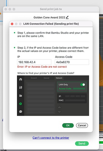

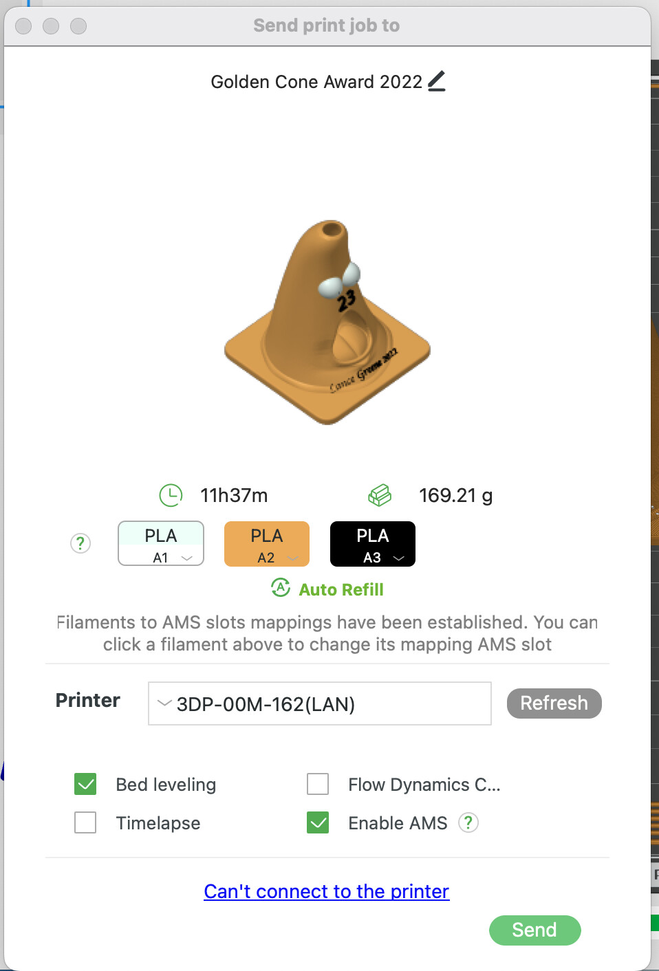

yesterday PM I printed and connected to my XIC via LAN just fine. This AM made a new project, sliced and send to printer. BS sees the printer turns the light off and on and all 4 spools. But when I try to send to the printer I get this!

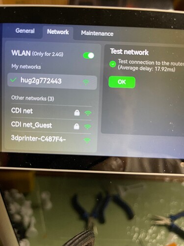

I have double checked the connection via the XIC and it says “OK”, but [this AM] it will not connect from BS 01.07.03.50.
I have resolved the problem. I have a QIDI X-Plus that I started with over year ago that works reasonably well. It is on the same 2g network as the X1C. Also, I run Boinc [a scientific WAN time shared software by Univ of Calif Berkeley] on all my computers. When the X-Plus and Boinc are both running the conflict. Now when I run X-Plus at the same time as the X1C I get the Cannot connect message. So multiple units sharing the slower 2g network can and does interfere with connecting to the X1C when trying to load over LAN.

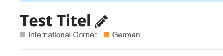

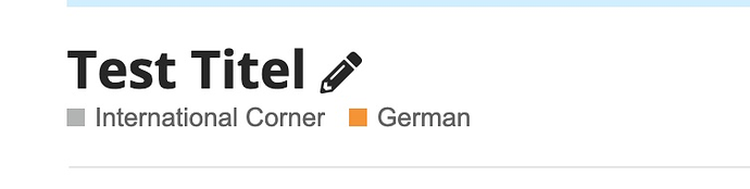

I am new here but I cannot find away to edit the the title to add Resolved to the end of an existing title. The edit function does not let me enter the title field.
when you open your open your thread, you should see the “edit” logo next to the title
(the pencil next to it)
Nope No Pensil.
