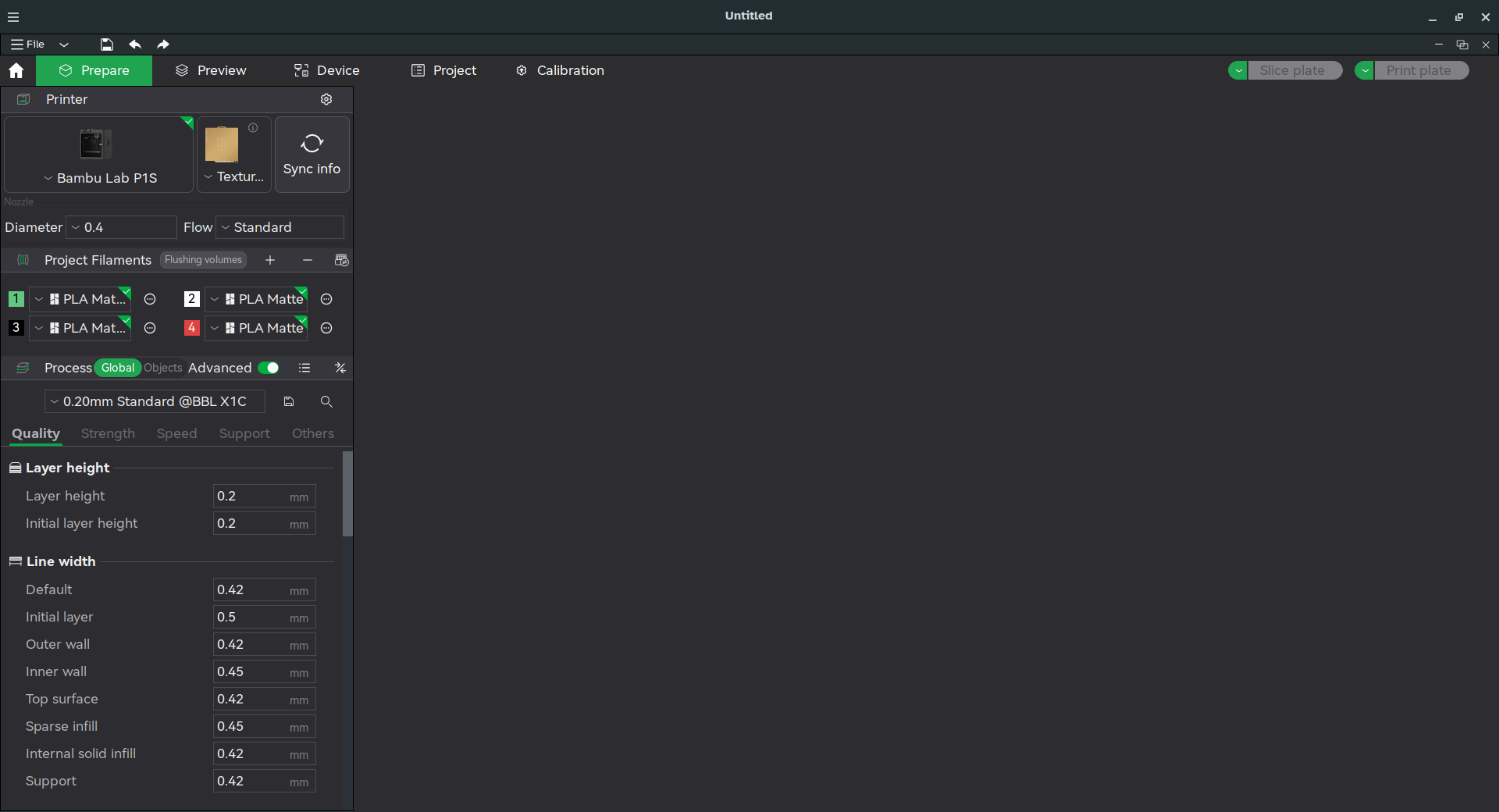

I’m running Bambu Studio from a flatpak on Debian 12. It’s the latest version - I saw a notification that it had been updated when I logged in this morning. I need to print some parts, so I started up Bambu Studio and on the Prepare page, I don’t see the build plate or the buttons to add new objects, etc.
Does anyone know how to fix this?
