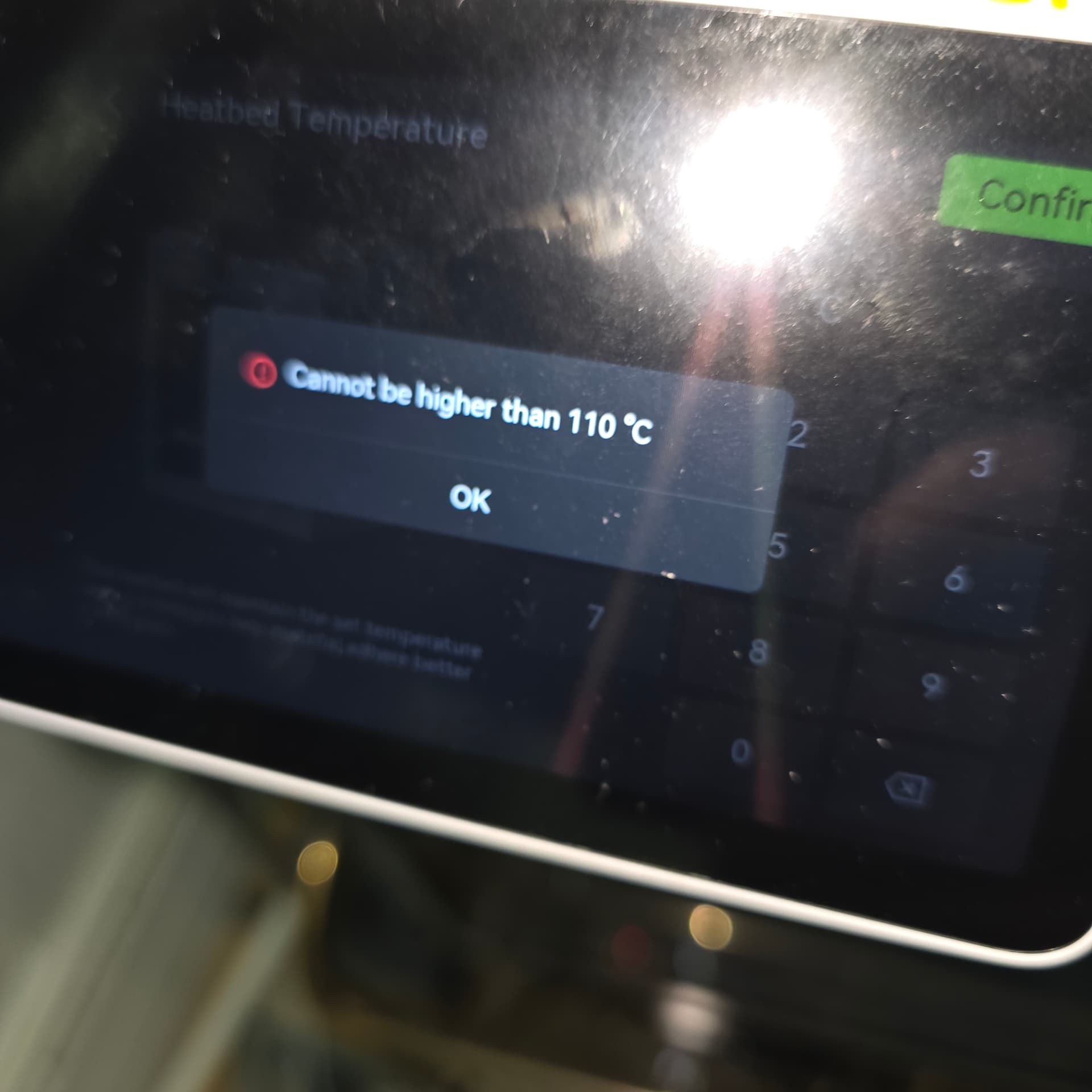

Problem: when trying set bed above 110c from the touchscreen it says can go over 110 during a print. However from the bambu handy app it works
Printer firmware: 01.10.00.00
Bambu handy version: 3.5.0
Printer: bambulab x1c

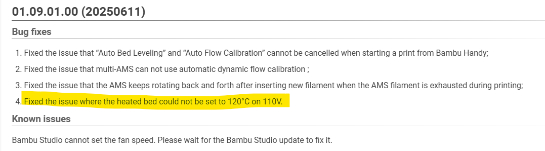

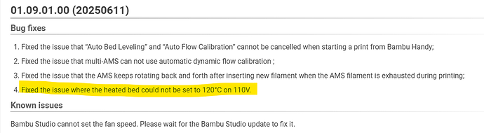

If you are running the printer on 220v it won’t allow you to set it to 120c via the display.
If you are running the printer on 110v, you should be able to set it to 120c via the display. That said there was a recent firmware bug that only allowed 110c. This issue was fixed in 1.09.01.
I just checked on the printer (110v) that I have running 1.10 and I was able to set the bed temp to 120c.
I am on 110v so i should be able to but for some reason im not
Try a factory reset. That often solves the oddest of problems.
