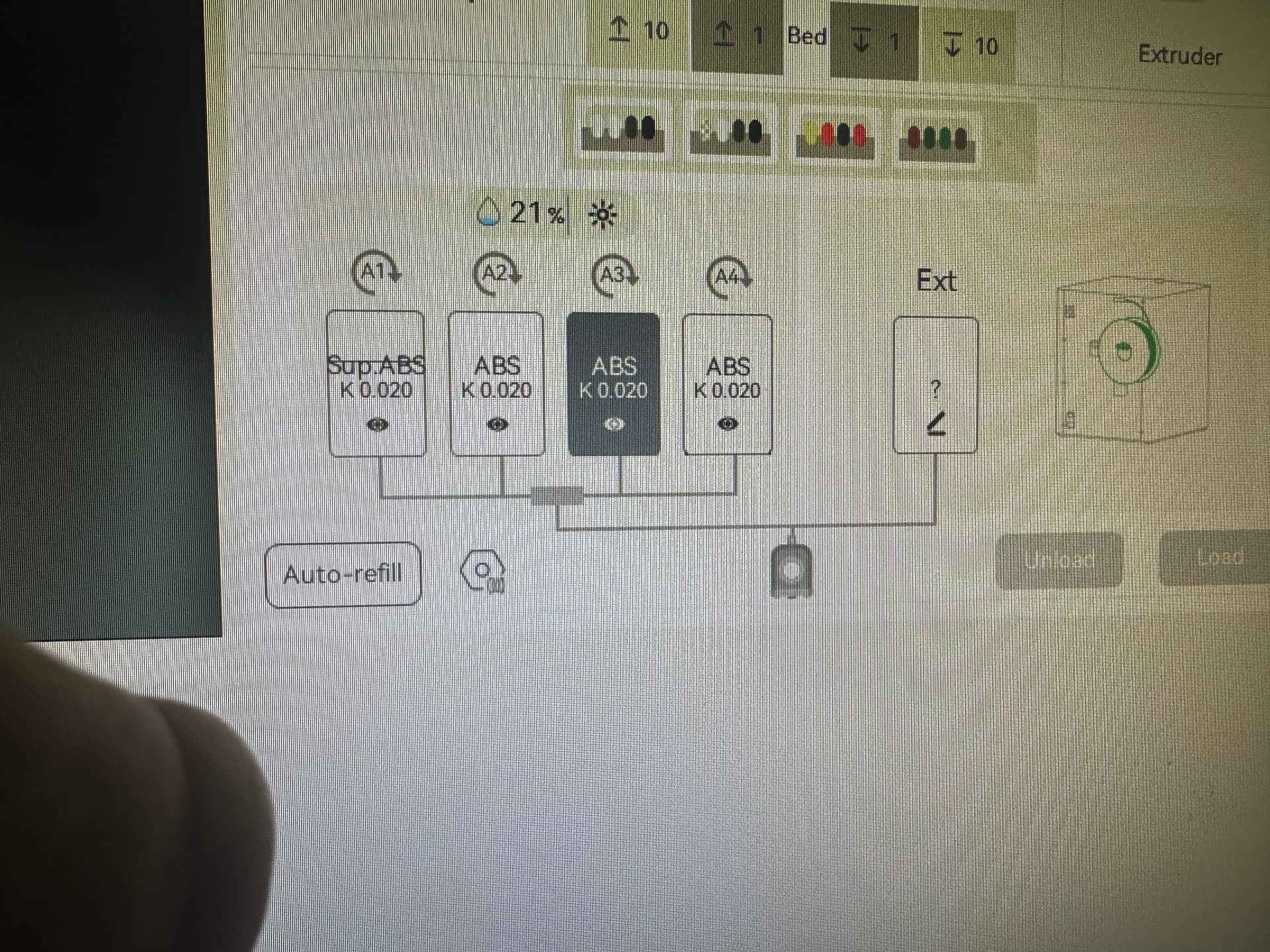

New issue since the last round of updates;
For some reason the filament screen says “unknown” for slot A2, even though it actually shows Bambu Support for ABS. The filament information is actually there, but there is a question mark on the printer screen and a warning symbol on Bambu Studio on the computer. I tried to ignore it and print anyway, but the software won’t allow it. I have power cycled the printer and all of the AMS units. I have also removed and reinstalled the filament. I have done all of these things multiple times. Has anyone else experienced this or been able to solve it?

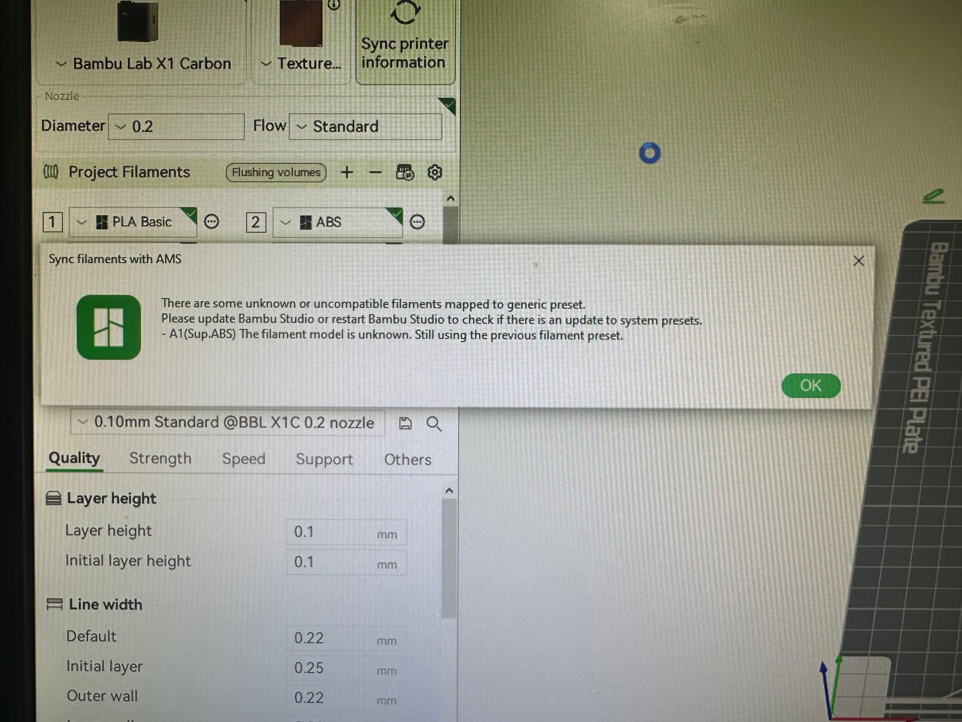

" There are some unknown or uncompatible filaments mapped to generic preset.
Please update Bambu Studio or restart Bambu Studio to check if there is an update to system presets.
  • B4(Sup.ABS) The filament model is unknown. Still using the previous filament preset."

The logs for the app have 15,000+ lines similar to:
debug_Tue_May_20_23_02_57_50000.log.0:2025-05-20 23:57:17.379326[Thread 0x0000000207a61f00]:The values of tray_info_idx and tray_type do not match tray_info_idx GFS06 tray_type ABS-S system_typeSup.ABS
debug_Tue_May_20_23_02_57_50000.log.0:"tray_type": "ABS-S",
debug_Tue_May_20_23_02_57_50000.log.0:2025-05-20 23:57:18.534564[Thread 0x0000000207a61f00]:The values of tray_info_idx and tray_type do not match tray_info_idx GFS06 tray_type ABS-S system_typeSup.ABS
And that’s just since I put the ABS-S material in this morning… The JSON files for the material seem to be there; I’m not exactly sure what these messages indicate.

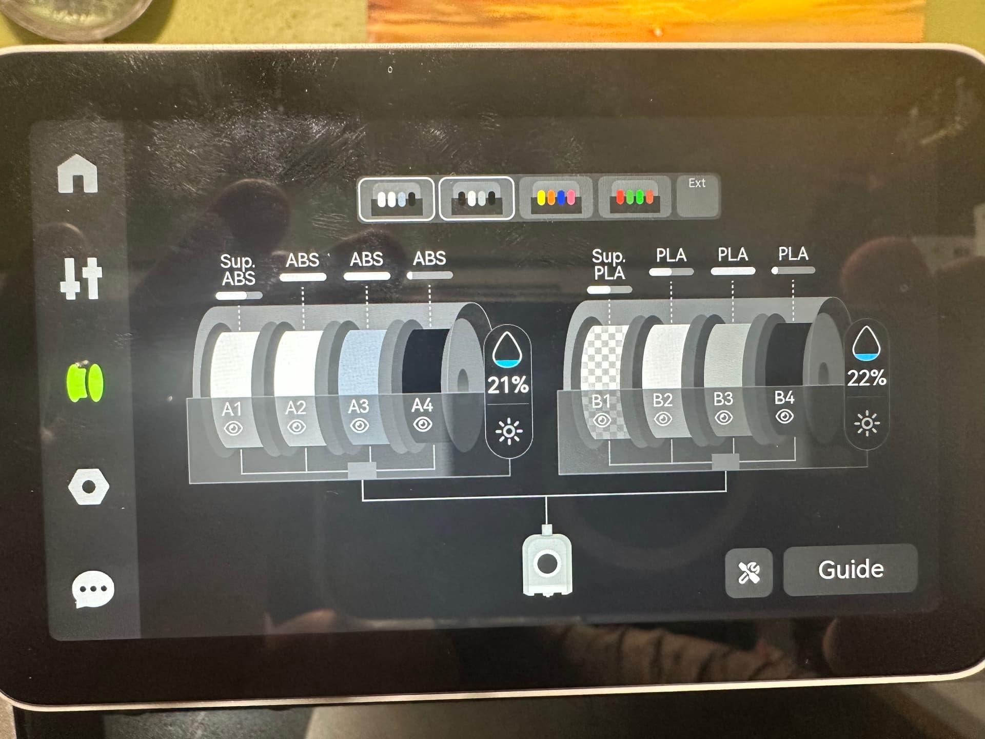

This issue has popped back up. The AMS and printer recognize the filament. The device tab shows the filament (with a strikethrough). When I sync filaments to Studio I get the error and I can’t use my ABS Support. I have uninstalled Studio, including deleting all user data, and re-installed it 4 times now. Nothin is working. I had a model I wanted t print in ABS using this support material. I put in a support ticket and got an auto response saying it would be 2-3 days before I get a reply.
Did you ever get a resolution? I am running into the same issue. Exactly the same issue. Purchased 2 rolls of ABS, and one roll of Sup.ABS, but Bambu Studio is not letting me map the slot the support material is in.

At first, I added “support for ABS” in the “Filaments to use” tool. Still, it didn’t work. Then, I bluntly added all items in the “Filaments to use” tool. Now, I re-synced and the ABS-support filament was recognized immediately.

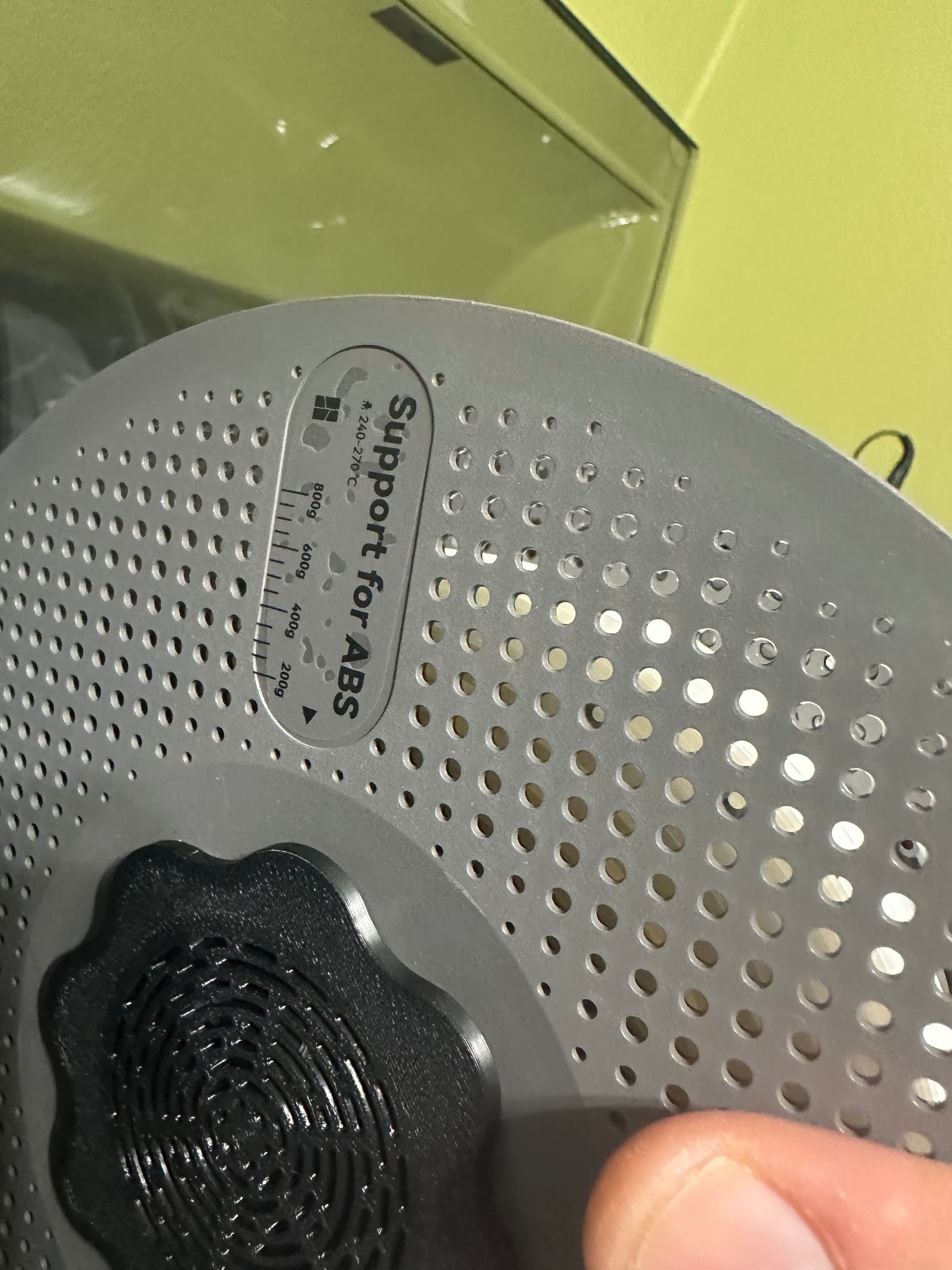

I am using ASA and bought the support material for ABS as I read it can be used for both ABS and ASA. I have printed multiple items that have used supports and none have utilized the support material. Only uses the ASA as the support. It’s terrible, but I bought the support material to be used. Any suggestions? I don’t see an option to change or select it as such.
